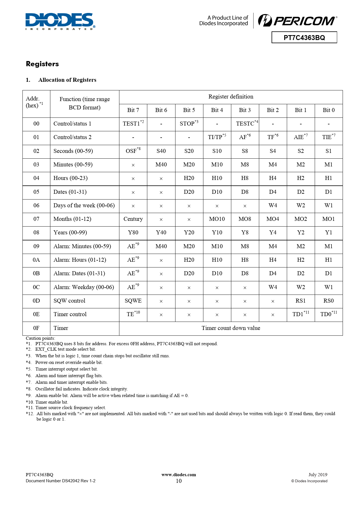

PT7C4363BQ. Registers. 1. Allocation of Registers. www.diodes.com
![PT7C4363BQ Registers 1 Allocation of Registers www.diodes.com](https://www.rlocman.ru/datasheet/img.php?di=167795&p=9)
PT7C4363BQ Registers 1. Allocation of Registers
Addr. Function (time range Register definition (hex) *1 BCD format) Bit 7 Bit 6 Bit 5 Bit 4 Bit 3 Bit 2 Bit 1 Bit 0 00 Control/status 1 TEST1*2 - STOP*3 - TESTC*4 - - - 01 Control/status 2 - - - TI/TP*5 AF*6 TF*6 AIE*7 TIE*7 02 Seconds (00-59) OSF*8 S40 S20 S10 S8 S4 S2 S1 03 Minutes (00-59) × M40 M20 M10 M8 M4 M2 M1 04 Hours (00-23) × × H20 H10 H8 H4 H2 H1 05 Dates (01-31) × × D20 D10 D8 D4 D2 D1 06 Days of the week (00-06) × × × × × W4 W2 W1 07 Months (01-12) Century × × MO10 MO8 MO4 MO2 MO1 08 Years (00-99) Y80 Y40 Y20 Y10 Y8 Y4 Y2 Y1 09 Alarm: Minutes (00-59) AE*9 M40 M20 M10 M8 M4 M2 M1 0A Alarm: Hours (01-12) AE*9 × H20 H10 H8 H4 H2 H1 0B Alarm: Dates (01-31) AE*9 × D20 D10 D8 D4 D2 D1 0C Alarm: Weekday (00-06) AE*9 × × × × W4 W2 W1 0D SQW control SQWE × × × × × RS1 RS0 0E Timer control TE*10 × × × × × TD1*11 TD0*11 0F Timer Timer count down value Caution points: *1. PT7C4363BQ uses 8 bits for address. For excess 0FH address, PT7C4363BQ will not respond. *2. EXT_CLK test mode select bit. *3. When the bit is logic 1, time count chain stops but oscillator still runs. *4. Power-on reset override enable bit. *5. Timer interrupt output select bit. *6. Alarm and timer interrupt flag bits. *7. Alarm and timer interrupt enable bits. *8. Oscillator fail indicates. Indicate clock integrity. *9. Alarm enable bit. Alarm will be active when related time is matching if AE = 0. *10. Timer enable bit. *11. Timer source clock frequency select. *12. All bits marked with "×" are not implemented. All bits marked with "-" are not used bits and should always be written with logic 0. If read them, they could be logic 0 or 1. PT7C4363BQ
