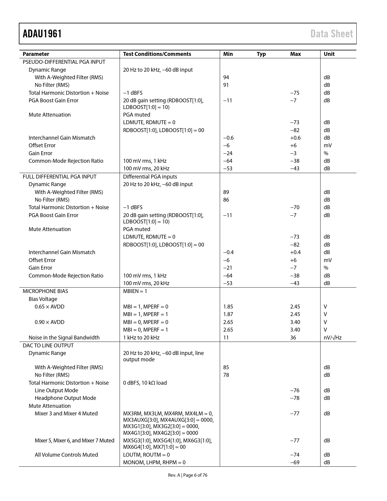

ADAU1961. Data Sheet. Parameter. Test Conditions/Comments. Min. Typ. Max. Unit
ADAU1961 Data Sheet Parameter Test Conditions/Comments Min Typ Max Unit
PSEUDO-DIFFERENTIAL PGA INPUT Dynamic Range 20 Hz to 20 kHz, −60 dB input With A-Weighted Filter (RMS) 94 dB No Filter (RMS) 91 dB Total Harmonic Distortion + Noise −1 dBFS −75 dB PGA Boost Gain Error 20 dB gain setting (RDBOOST[1:0], −11 −7 dB LDBOOST[1:0] = 10) Mute Attenuation PGA muted LDMUTE, RDMUTE = 0 −73 dB RDBOOST[1:0], LDBOOST[1:0] = 00 −82 dB Interchannel Gain Mismatch −0.6 +0.6 dB Offset Error −6 +6 mV Gain Error −24 −3 % Common-Mode Rejection Ratio 100 mV rms, 1 kHz −64 −38 dB 100 mV rms, 20 kHz −53 −43 dB FULL DIFFERENTIAL PGA INPUT Differential PGA inputs Dynamic Range 20 Hz to 20 kHz, −60 dB input With A-Weighted Filter (RMS) 89 dB No Filter (RMS) 86 dB Total Harmonic Distortion + Noise −1 dBFS −70 dB PGA Boost Gain Error 20 dB gain setting (RDBOOST[1:0], −11 −7 dB LDBOOST[1:0] = 10) Mute Attenuation PGA muted LDMUTE, RDMUTE = 0 −73 dB RDBOOST[1:0], LDBOOST[1:0] = 00 −82 dB Interchannel Gain Mismatch −0.4 +0.4 dB Offset Error −6 +6 mV Gain Error −21 −7 % Common-Mode Rejection Ratio 100 mV rms, 1 kHz −64 −38 dB 100 mV rms, 20 kHz −53 −43 dB MICROPHONE BIAS MBIEN = 1 Bias Voltage 0.65 × AVDD MBI = 1, MPERF = 0 1.85 2.45 V MBI = 1, MPERF = 1 1.87 2.45 V 0.90 × AVDD MBI = 0, MPERF = 0 2.65 3.40 V MBI = 0, MPERF = 1 2.65 3.40 V Noise in the Signal Bandwidth 1 kHz to 20 kHz 11 36 nV/√Hz DAC TO LINE OUTPUT Dynamic Range 20 Hz to 20 kHz, −60 dB input, line output mode With A-Weighted Filter (RMS) 85 dB No Filter (RMS) 78 dB Total Harmonic Distortion + Noise 0 dBFS, 10 kΩ load Line Output Mode −76 dB Headphone Output Mode −78 dB Mute Attenuation Mixer 3 and Mixer 4 Muted MX3RM, MX3LM, MX4RM, MX4LM = 0, −77 dB MX3AUXG[3:0], MX4AUXG[3:0] = 0000, MX3G1[3:0], MX3G2[3:0] = 0000, MX4G1[3:0], MX4G2[3:0] = 0000 Mixer 5, Mixer 6, and Mixer 7 Muted MX5G3[1:0], MX5G4[1:0], MX6G3[1:0], −77 dB MX6G4[1:0], MX7[1:0] = 00 All Volume Controls Muted LOUTM, ROUTM = 0 −74 dB MONOM, LHPM, RHPM = 0 −69 dB Rev. A | Page 6 of 76 Document Outline Features Applications General Description Functional Block Diagram Revision History Specifications Analog Performance Specifications, TA = 25 C Analog Performance Specifications, −40 C < TA < +105 C Power Supply Specifications Digital Filters Digital Input/Output Specifications Digital Timing Specifications Digital Timing Diagrams Absolute Maximum Ratings Thermal Resistance ESD Caution Pin Configuration and Function Descriptions Typical Performance Characteristics System Block Diagrams Theory of Operation Startup, Initialization, and Power Power-Up Sequence Power Reduction Modes Digital Power Supply Input/Output Power Supply Clock Generation and Management Case 1: PLL Is Bypassed Case 2: PLL Is Used PLL Lock Acquisition Clocking and Sampling Rates Core Clock Sampling Rates PLL Integer Mode Fractional Mode Record Signal Path Input Signal Paths Analog Microphone Inputs Analog Line Inputs Digital Microphone Input Microphone Bias Analog-to-Digital Converters ADC Full-Scale Level Digital ADC Volume Control High-Pass Filter Automatic Level Control (ALC) ALC Parameters Noise Gate Function Playback Signal Path Output Signal Paths Routing Flexibility Headphone Output Capless Headphone Configuration Headphone Output Power-Up/Power-Down Sequencing Ground-Centered Headphone Configuration Jack Detection Pop-and-Click Suppression Line Outputs Control Ports Burst Mode Writing and Reading I2C Port Addressing I2C Read and Write Operations SPI Port Chip Address R/W Subaddress Data Bytes Serial Data Input/Output Ports Applications Information Power Supply Bypass Capacitors GSM Noise Filter Grounding Exposed Pad PCB Design Control Registers Control Register Details R0: Clock Control, 16,384 (0x4000) R1: PLL Control, 16,386 (0x4002) R2: Digital Microphone/Jack Detection Control, 16,392 (0x4008) R4: Record Mixer Left (Mixer 1) Control 0, 16,394 (0x400A) R5: Record Mixer Left (Mixer 1) Control 1, 16,395 (0x400B) R6: Record Mixer Right (Mixer 2) Control 0, 16,396 (0x400C) R7: Record Mixer Right (Mixer 2) Control 1, 16,397 (0x400D) R8: Left Differential Input Volume Control, 16,398 (0x400E) R9: Right Differential Input Volume Control, 16,399 (0x400F) R10: Record Microphone Bias Control, 16,400 (0x4010) R11: ALC Control 0, 16,401 (0x4011) R12: ALC Control 1, 16,402 (0x4012) R13: ALC Control 2, 16,403 (0x4013) R14: ALC Control 3, 16,404 (0x4014) R15: Serial Port Control 0, 16,405 (0x4015) R16: Serial Port Control 1, 16,406 (0x4016) R17: Converter Control 0, 16,407 (0x4017) R18: Converter Control 1, 16,408 (0x4018) R19: ADC Control, 16,409 (0x4019) R20: Left Input Digital Volume, 16,410 (0x401A) R21: Right Input Digital Volume, 16,411 (0x401B) R22: Playback Mixer Left (Mixer 3) Control 0, 16,412 (0x401C) R23: Playback Mixer Left (Mixer 3) Control 1, 16,413 (0x401D) R24: Playback Mixer Right (Mixer 4) Control 0, 16,414 (0x401E) R25: Playback Mixer Right (Mixer 4) Control 1, 16,415 (0x401F) R26: Playback L/R Mixer Left (Mixer 5) Line Output Control, 16,416 (0x4020) R27: Playback L/R Mixer Right (Mixer 6) Line Output Control, 16,417 (0x4021) R28: Playback L/R Mixer Mono Output (Mixer 7) Control, 16,418 (0x4022) R29: Playback Headphone Left Volume Control, 16,419 (0x4023) R30: Playback Headphone Right Volume Control, 16,420 (0x4024) R31: Playback Line Output Left Volume Control, 16,421 (0x4025) R32: Playback Line Output Right Volume Control, 16,422 (0x4026) R33: Playback Mono Output Control, 16,423 (0x4027) R34: Playback Pop/Click Suppression, 16,424 (0x4028) R35: Playback Power Management, 16,425 (0x4029) R36: DAC Control 0, 16,426 (0x402A) R37: DAC Control 1, 16,427 (0x402B) R38: DAC Control 2, 16,428 (0x402C) R39: Serial Port Pad Control, 16,429 (0x402D) R40: Control Port Pad Control 0, 16,431 (0x402F) R41: Control Port Pad Control 1, 16,432 (0x4030) R42: Jack Detect Pin Control, 16,433 (0x4031) R67: Dejitter Control, 16,438 (0x4036) Outline Dimensions Ordering Guide Automotive Products
