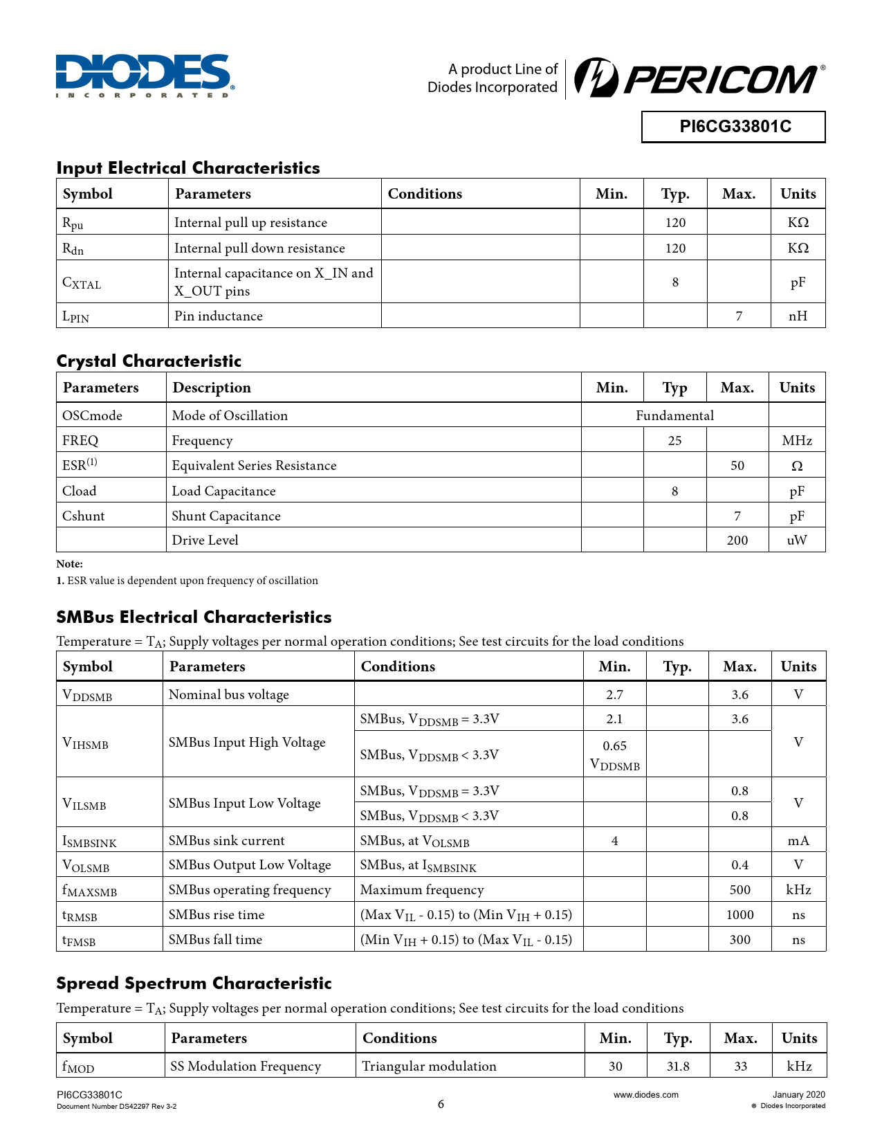

PI6CG33801C. Input Electrical Characteristics. Symbol. Parameters. Conditions. Min. Typ. Max. Units. Crystal Characteristic. Description. Typ
PI6CG33801C Input Electrical Characteristics Symbol Parameters Conditions Min Typ Max Units Crystal Characteristic Description Typ
A product Line of Diodes Incorporated
PI6CG33801C Input Electrical Characteristics Symbol Parameters Conditions Min. Typ. Max. Units
Rpu Internal pull up resistance 120 KW Rdn Internal pull down resistance 120 KW C Internal capacitance on X_IN and XTAL X_OUT pins 8 pF LPIN Pin inductance 7 nH
Crystal Characteristic Parameters Description Min. Typ Max. Units
OSCmode Mode of Oscillation Fundamental FREQ Frequency 25 MHz ESR(1) Equivalent Series Resistance 50 W Cload Load Capacitance 8 pF Cshunt Shunt Capacitance 7 pF Drive Level 200 uW
Note: 1.
ESR value is dependent upon frequency of oscillation
SMBus Electrical Characteristics
Temperature = TA; Supply voltages per normal operation conditions; See test circuits for the load conditions
VDDSMB Nominal bus voltage 2.7 3.6 V SMBus, VDDSMB = 3.3V 2.1 3.6 VIHSMB SMBus Input High Voltage V SMBus, VDDSMB < 3.3V 0.65 VDDSMB SMBus, V V DDSMB = 3.3V 0.8 ILSMB SMBus Input Low Voltage V SMBus, VDDSMB < 3.3V 0.8 ISMBSINK SMBus sink current SMBus, at VOLSMB 4 mA VOLSMB SMBus Output Low Voltage SMBus, at ISMBSINK 0.4 V fMAXSMB SMBus operating frequency Maximum frequency 500 kHz tRMSB SMBus rise time (Max VIL - 0.15) to (Min VIH + 0.15) 1000 ns tFMSB SMBus fall time (Min VIH + 0.15) to (Max VIL - 0.15) 300 ns
Spread Spectrum Characteristic
fMOD SS Modulation Frequency Triangular modulation 30 31.8 33 kHz PI6CG33801C www.diodes.com January 2020 Document Number DS42297 Rev 3-2 6 Diodes Incorporated
