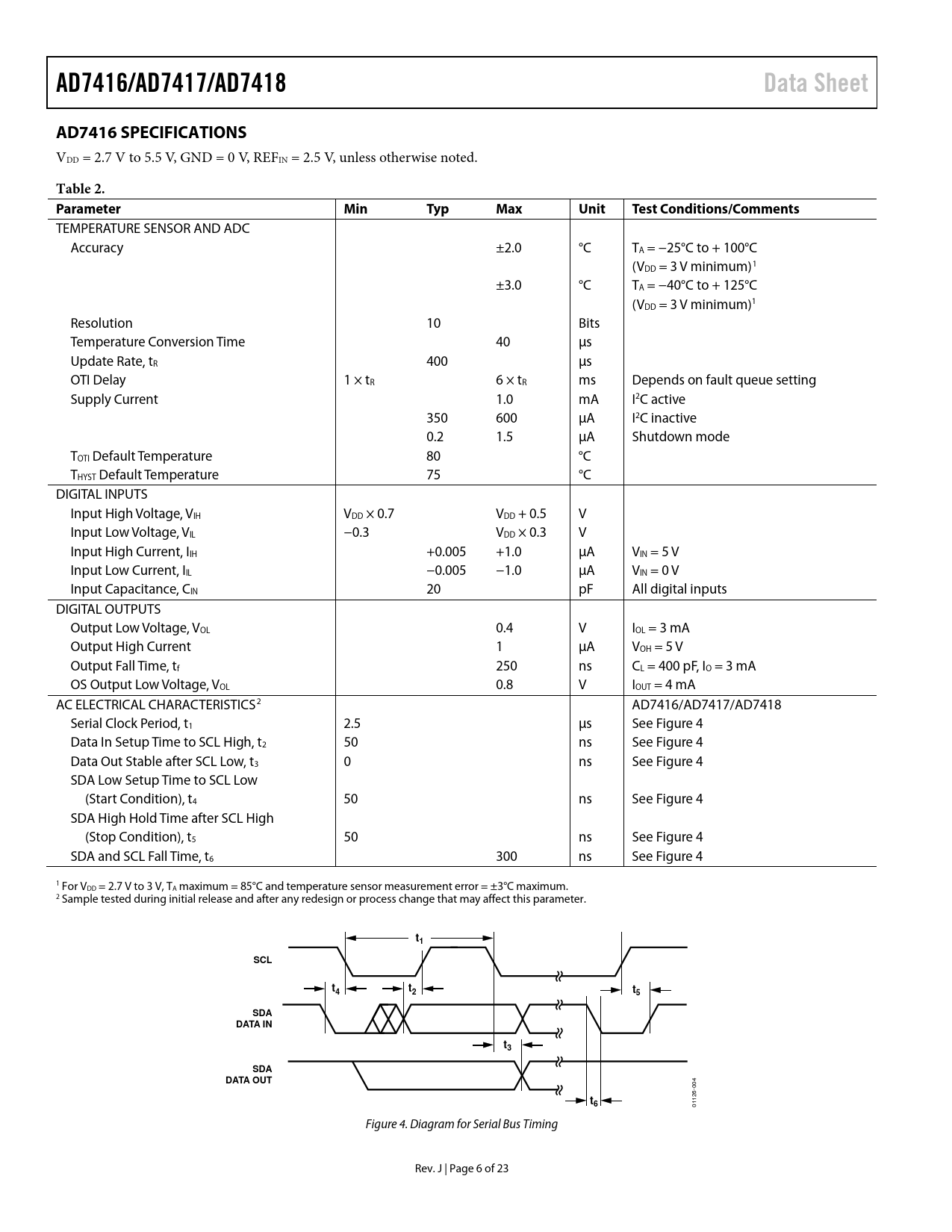

AD7416/AD7417/AD7418 Data Sheet AD7416 SPECIFICATIONS
VDD = 2.7 V to 5.5 V, GND = 0 V, REFIN = 2.5 V, unless otherwise noted.
Table 2. Parameter Min Typ Max Unit Test Conditions/Comments
TEMPERATURE SENSOR AND ADC Accuracy ±2.0 °C TA = −25°C to + 100°C (VDD = 3 V minimum)1 ±3.0 °C TA = −40°C to + 125°C (VDD = 3 V minimum)1 Resolution 10 Bits Temperature Conversion Time 40 μs Update Rate, tR 400 μs OTI Delay 1 × tR 6 × tR ms Depends on fault queue setting Supply Current 1.0 mA I2C active 350 600 μA I2C inactive 0.2 1.5 μA Shutdown mode TOTI Default Temperature 80 °C THYST Default Temperature 75 °C DIGITAL INPUTS Input High Voltage, VIH VDD × 0.7 VDD + 0.5 V Input Low Voltage, VIL −0.3 VDD × 0.3 V Input High Current, IIH +0.005 +1.0 μA VIN = 5 V Input Low Current, IIL −0.005 −1.0 μA VIN = 0 V Input Capacitance, CIN 20 pF All digital inputs DIGITAL OUTPUTS Output Low Voltage, VOL 0.4 V IOL = 3 mA Output High Current 1 μA VOH = 5 V Output Fall Time, tf 250 ns CL = 400 pF, IO = 3 mA OS Output Low Voltage, VOL 0.8 V IOUT = 4 mA AC ELECTRICAL CHARACTERISTICS2 AD7416/AD7417/AD7418 Serial Clock Period, t1 2.5 μs See Figure 4 Data In Setup Time to SCL High, t2 50 ns See Figure 4 Data Out Stable after SCL Low, t3 0 ns See Figure 4 SDA Low Setup Time to SCL Low (Start Condition), t4 50 ns See Figure 4 SDA High Hold Time after SCL High (Stop Condition), t5 50 ns See Figure 4 SDA and SCL Fall Time, t6 300 ns See Figure 4 1 For VDD = 2.7 V to 3 V, TA maximum = 85°C and temperature sensor measurement error = ±3°C maximum. 2 Sample tested during initial release and after any redesign or process change that may affect this parameter.
t1 SCL t4 t2 t5 SDA DATA IN t3 SDA DATA OUT
