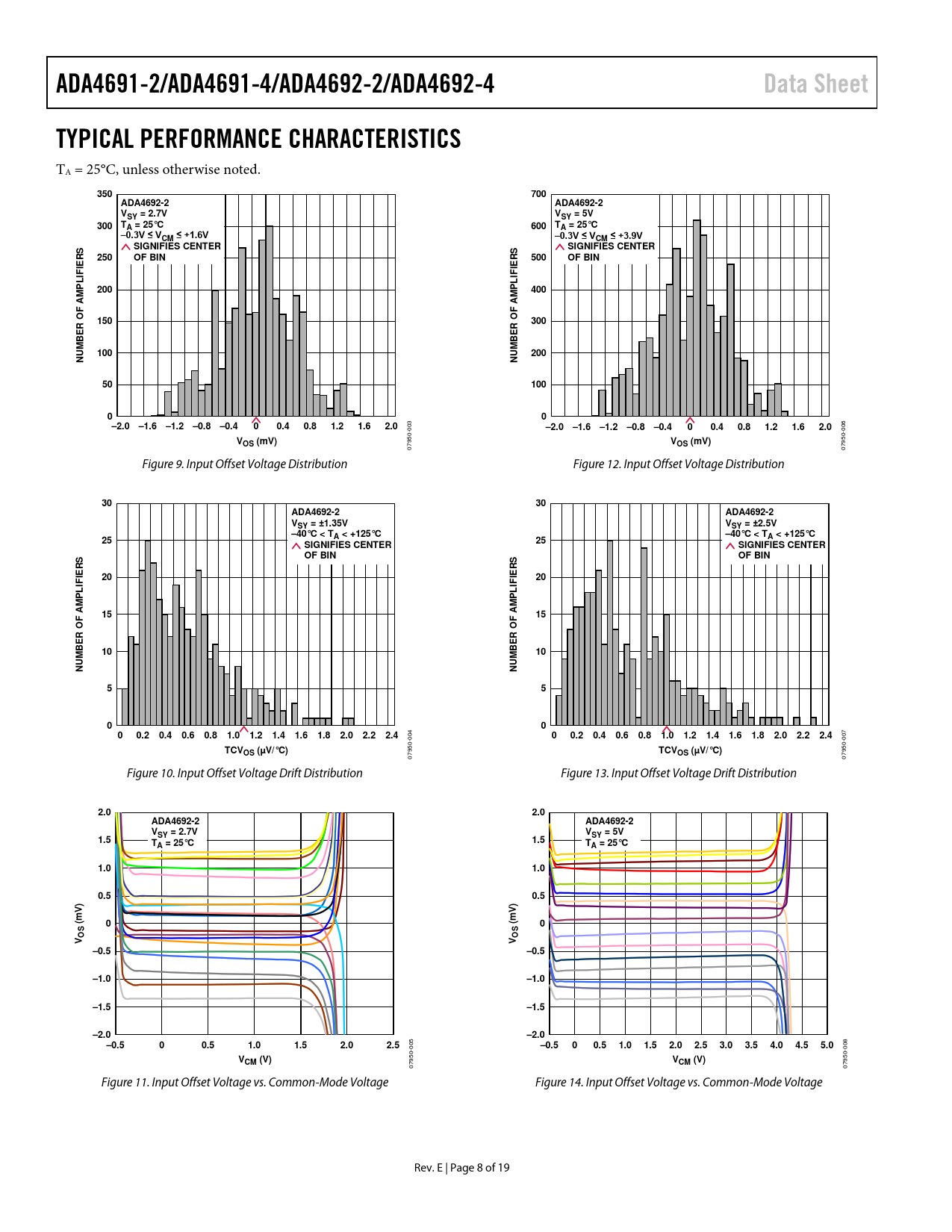

ADA4691-2/ADA4691-4/ADA4692-2/ADA4692-4. Data Sheet. TYPICAL PERFORMANCE CHARACTERISTICS. 350. 700. ADA4692-2. VSY = 2.7V. VSY = 5V
ADA4691-2/ADA4691-4/ADA4692-2/ADA4692-4 Data Sheet TYPICAL PERFORMANCE CHARACTERISTICS 350 700 ADA4692-2 VSY = 2.7V VSY = 5V
TA = 25°C, unless otherwise noted.
350 700 ADA4692-2 ADA4692-2 VSY = 2.7V VSY = 5V 300 TA = 25°C 600 TA = 25°C –0.3V ≤ VCM ≤ +1.6V –0.3V ≤ VCM ≤ +3.9V SIGNIFIES CENTER SIGNIFIES CENTER RS 250 OF BIN RS 500 OF BIN IE IE IF IF L L P 200 P 400 AM AM F F 150 300 R O R O BE BE 100 200 NUM NUM 50 100 0 0 –2.0 –1.6 –1.2 –0.8 –0.4 0 0.4 0.8 1.2 1.6 2.0
003
006
VOS (mV) VOS (mV)
07950- 07950- Figure 9. Input Offset Voltage Distribution Figure 12. Input Offset Voltage Distribution
30 30 ADA4692-2 ADA4692-2 VSY = ±1.35V VSY = ±2.5V –40°C < T –40°C < T 25 A < +125°C 25 A < +125°C SIGNIFIES CENTER SIGNIFIES CENTER OF BIN OF BIN RS RS IE 20 IE 20 IF IF L L P P AM 15 AM F 15 F R O R O BE 10 BE 10 NUM NUM 5 5 0 0 0 0.2 0.4 0.6 0.8 1.0 1.2 1.4 1.6 1.8 2.0 2.2 2.4
004
007
TCVOS (µV/°C) TCVOS (µV/°C)
07950- 07950- Figure 10. Input Offset Voltage Drift Distribution Figure 13. Input Offset Voltage Drift Distribution
2.0 2.0 ADA4692-2 ADA4692-2 VSY = 2.7V VSY = 5V 1.5 T 1.5 A = 25°C TA = 25°C 1.0 1.0 0.5 0.5 V) V) (m 0 (m 0 OS OS V V –0.5 –0.5 –1.0 –1.0 –1.5 –1.5 –2.0 –2.0 –0.5 0 0.5 1.0 1.5 2.0 2.5
005
–0.5 0 0.5 1.0 1.5 2.0 2.5 3.0 3.5 4.0 4.5 5.0
008
VCM (V) VCM (V)
07950- 07950- Figure 11. Input Offset Voltage vs. Common-Mode Voltage Figure 14. Input Offset Voltage vs. Common-Mode Voltage Rev. E | Page 8 of 19 Document Outline Features Applications General Description Revision History Specifications Electrical Characteristics—2.7 V Operation Electrical Characteristics—5 V Operation Absolute Maximum Ratings Thermal Resistance ESD Caution Pin Configurations Typical Performance Characteristics Shutdown Operation Input Pin Characteristics Input Threshold Outline Dimensions Ordering Guide
