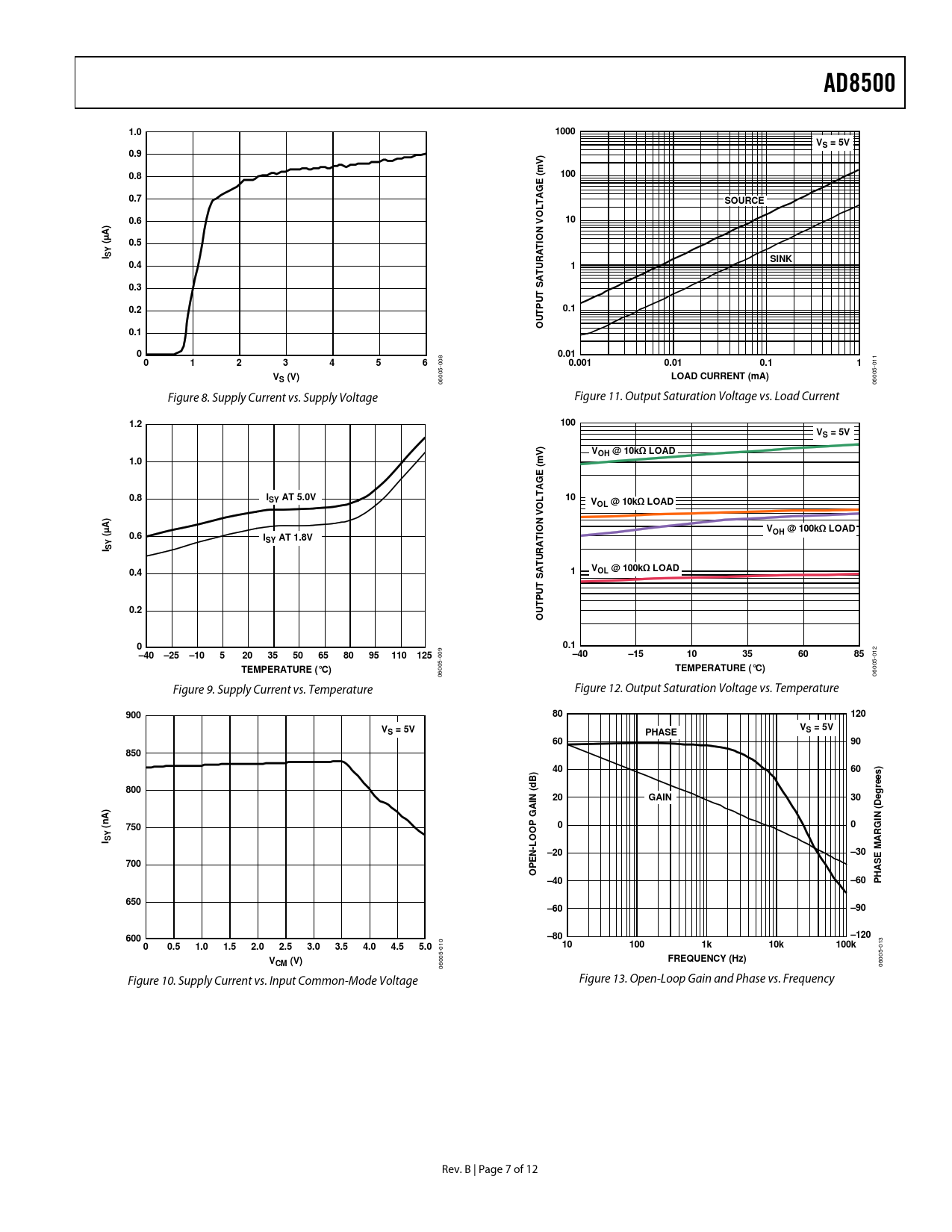

AD8500. 1.0. 1000. VS = 5V. 0.9. ) V m. 0.8. 100. E ( G. 0.7. A T. SOURCE. 0.6. VO N. (µA. 0.5. IO T. I SY. A R. SINK. 0.4. 0.3. SA T U. 0.2. 0.1. T U O. 0.01. 0.001. S (V)
AD8500 1.0 1000 VS = 5V 0.9 ) V m 0.8 100 E ( G 0.7 A T SOURCE 0.6 VO N (µA 0.5 IO T I SY A R SINK 0.4 0.3 SA T U 0.2 0.1 T U O 0.01 0.001 S (V)
AD8500 1.0 1000 VS = 5V 0.9 ) V m 0.8 100 E ( G 0.7 A T SOURCE L 0.6 10 ) VO N (µA 0.5 IO T I SY A R SINK 0.4 U 1 T 0.3 SA T U 0.2 P 0.1 T U O 0.1 0 0.01
1
0 1 2 3 4 5 6
08 0
0.001 0.01 0.1 1
01 5- 5-
V
00 00
S (V) LOAD CURRENT (mA)
06 06 Figure 8. Supply Current vs. Supply Voltage Figure 11. Output Saturation Voltage vs. Load Current
1.2 100 VS = 5V ) V VOH @ 10kΩ LOAD 1.0 m ( E AG T 0.8 ISY AT 5.0V L 10 O VOL @ 10kΩ LOAD ) N V IO VOH @ 100kΩ LOAD (µA 0.6 ISY AT 1.8V I SY RAT U V 0.4 AT 1 OL @ 100kΩ LOAD S UT P 0.2 UT O 0 0.1
12
–40 –25 –10 5 20 35 50 65 80 95 110 125
09 0
–40 –15 10 35 60 85
0 5- 5-
TEMPERATURE (°C)
00
TEMPERATURE (°C)
00 06 06 Figure 9. Supply Current vs. Temperature Figure 12. Output Saturation Voltage vs. Temperature
900 80 120 V V S = 5V PHASE S = 5V 60 90 850 40 60 ) B d rees) 800 ( g 20 GAIN 30 IN e D ) ( GA IN (nA 750 0 0 I SY OOP ARG -L M N –20 –30 E E 700 S A OP H –40 –60 P 650 –60 –90 600 –80 –120
3
0 0.5 1.0 1.5 2.0 2.5 3.0 3.5 4.0 4.5 5.0
10 0
10 100 1k 10k 100k
01 5- 5-
V
00
FREQUENCY (Hz)
00
CM (V)
06 06 Figure 10. Supply Current vs. Input Common-Mode Voltage Figure 13. Open-Loop Gain and Phase vs. Frequency Rev. B | Page 7 of 12 Document Outline FEATURES APPLICATIONS PIN CONFIGURATION GENERAL DESCRIPTION TABLE OF CONTENTS REVISION HISTORY SPECIFICATIONS ABSOLUTE MAXIMUM RATINGS THERMAL RESISTANCE ESD CAUTION TYPICAL PERFORMANCE CHARACTERISTICS OUTLINE DIMENSIONS ORDERING GUIDE
