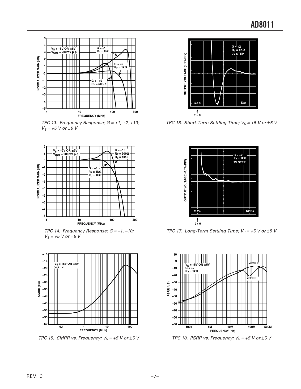

AD8011. G = +2. G = +1. S = +5V OR. F = 1K. F = 1k. OUT = 200mV p-p. 2V STEP. RF = 1k. G = +10 RF = 500. NORMALIZED GAIN (dB)
AD8011 G = +2 G = +1 S = +5V OR F = 1K F = 1k OUT = 200mV p-p 2V STEP RF = 1k G = +10 RF = 500 NORMALIZED GAIN (dB)
AD8011 5 4 G = +2 V G = +1 S = +5V OR
5V R 3 R V F = 1K
F = 1k
OUT = 200mV p-p 2V STEP 2 G = +2 1 RF = 1k
0 –1 G = +10 RF = 500
–2 NORMALIZED GAIN (dB) –3 OUTPUT VOLTAGE (0.1%/DIV) –4 0.1% 5ns –5 1 10 100 500 FREQUENCY (MHz) t = 0
TPC 13. Frequency Response; G = +1, +2, +10; TPC 16. Short-Term Settling Time; VS = +5 V or ±5 V VS = +5 V or ±5 V
2 V G = –10 S = +5V OR
5V 1 V RF = 500
OUT = 200mV p-p G = +2 RL = 1k
R 0 F = 1k
2V STEP –1 G = –1 RF = 1k
–2 RL = 1k
–3 –4 –5 NORMALIZED GAIN (dB) OUTPUT VOLTAGE (0.1%/DIV) –6 –7 0.1% 100ns –8 1 10 100 500 FREQUENCY (MHz) t = 0
TPC 14. Frequency Response; G = –1, –10; TPC 17. Long-Term Settling Time; VS = +5 V or ±5 V VS = +5 V or ±5 V
–10 10 –15 0 V –PSRR S = +5V OR
5V VS = +5V OR
5V –20 G = +2 –10 G = +2 RF = 1k
–25 –20 +PSRR –30 –30 –35 –40 CMRR (dB) –40 PSRR (dB) –50 –45 –60 –50 –70 –55 –80 –60 –90 0.1 1 10 100 100k 1M 10M 100M 500M FREQUENCY (MHz) FREQUENCY (Hz)
TPC 15. CMRR vs. Frequency; VS = +5 V or ±5 V TPC 18. PSRR vs. Frequency; VS = +5 V or ±5 V REV. C –7– Document Outline FEATURES APPLICATIONS FUNCTIONAL BLOCK DIAGRAM PRODUCT DESCRIPTION SPECIFICATIONS DUAL SUPPLY SINGLE SUPPLY ABSOLUTE MAXIMUM RATINGS MAXIMUM POWER DISSIPATION ORDERING GUIDE Typical Performance Characteristics THEORY OF OPERATION DC GAIN CHARACTERISTICS AC TRANSFER CHARACTERISTICS DRIVING CAPACITIVE LOADS OPTIMIZING FLATNESS INCREASING BW AT HIGH GAINS DRIVING A SINGLE-SUPPLY A/D CONVERTER LAYOUT CONSIDERATIONS OUTLINE DIMENSIONS Revision History
