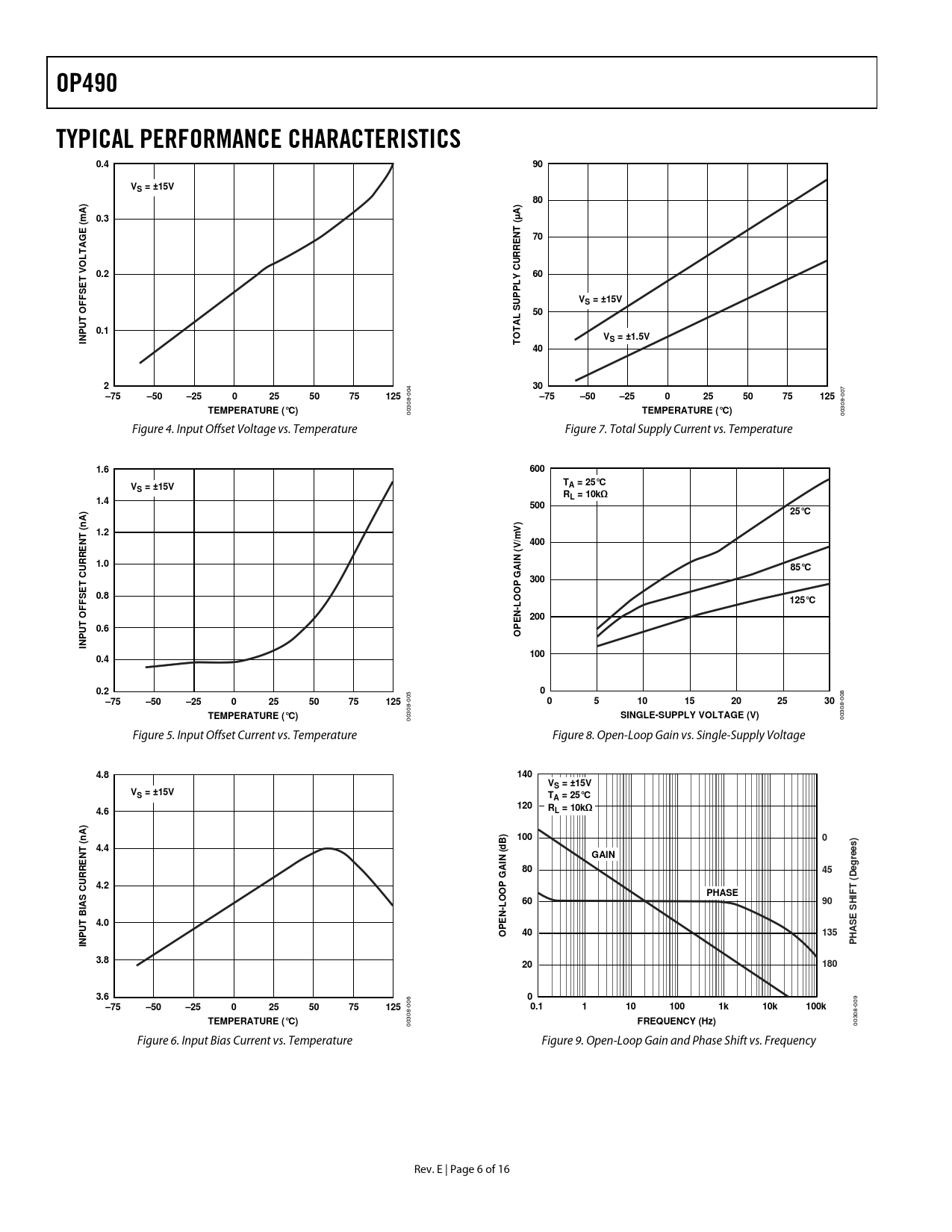

OP490. TYPICAL PERFORMANCE CHARACTERISTICS. 0.4. VS = ±15V. 0.3. E G. A T L O. URRE. 0.2. F F. 0.1. T O. S = ±1.5V. –75. –50. –25. 125. TEMPERATURE (°C)
OP490 TYPICAL PERFORMANCE CHARACTERISTICS 0.4 VS = ±15V 0.3 E G A T L O URRE 0.2 F F 0.1 T O S = ±1.5V –75 –50 –25 125 TEMPERATURE (°C)
OP490 TYPICAL PERFORMANCE CHARACTERISTICS 0.4 90 VS = ±15V ) 80 ) A A 0.3 µ (m ( E G NT 70 A T L O URRE V 0.2 C 60 Y ET L S P F F UP VS = ±15V O S 50 T AL PU 0.1 T O IN V T S = ±1.5V 40 2

00 Figure 4. Input Offset Voltage vs. Temperature Figure 7. Total Supply Current vs. Temperature
1.6 600 T V A = 25°C S = ±15V R 1.4 L = 10kΩ 500 25°C A) n ) ( 1.2 V T N /m 400 (V RRE 1.0 IN 85°C CU GA T 300 E OP S 0.8 F O 125°C F -L O N 200 E UT 0.6 P O INP 100 0.4 0.2 0

00 00 Figure 5. Input Offset Current vs. Temperature Figure 8. Open-Loop Gain vs. Single-Supply Voltage
4.8 140 VS = ±15V VS = ±15V TA = 25°C 120 4.6 RL = 10kΩ A) n ) 100 0 ( B 4.4 d NT ( GAIN rees) E IN 80 eg 45 GA (D 4.2 T CURR PHASE IF OOP AS 60 90 H -L S BI N E 4.0 E UT AS P OP 40 135 H IN P 3.8 20 180 3.6 0

00 00 Figure 6. Input Bias Current vs. Temperature Figure 9. Open-Loop Gain and Phase Shift vs. Frequency Rev. E | Page 6 of 16 Document Outline FEATURES GENERAL DESCRIPTION FUNCTIONAL BLOCK DIAGRAMS TABLE OF CONTENTS REVISION HISTORY SPECIFICATIONS ELECTRICAL CHARACTERISTICS ABSOLUTE MAXIMUM RATINGS THERMAL RESISTANCE ESD CAUTION TYPICAL PERFORMANCE CHARACTERISTICS APPLICATIONS INFORMATION BATTERY-POWERED APPLICATIONS SINGLE-SUPPLY OUTPUT VOLTAGE RANGE INPUT VOLTAGE PROTECTION MICROPOWER VOLTAGE-CONTROLLED OSCILLATOR MICROPOWER SINGLE-SUPPLY QUAD VOLTAGE-OUTPUT 8-BIT DAC HIGH OUTPUT AMPLIFIER SINGLE-SUPPLY MICROPOWER QUAD PROGRAMMABLE GAIN AMPLIFIER OUTLINE DIMENSIONS ORDERING GUIDE
