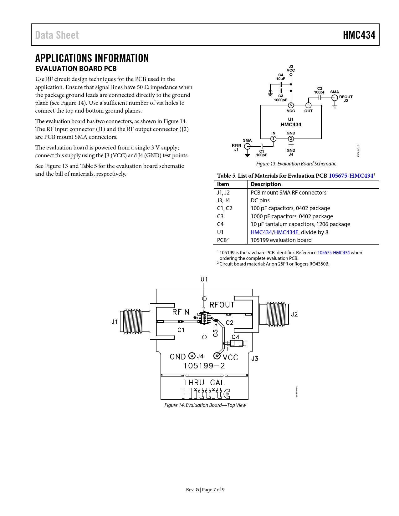

Data Sheet HMC434 APPLICATIONS INFORMATION EVALUATION BOARD PCB J3 VCC C4
Use RF circuit design techniques for the PCB used in the
10µF
application. Ensure that signal lines have 50 Ω impedance when
C2
the package ground leads are connected directly to the ground
100pF SMA C3 RFOUT
plane (see Figure 14). Use a sufficient number of via holes to
1000pF J2 5 6
connect the top and bottom ground planes.
VCC OUT
The evaluation board has two connectors, as shown in Figure 14.
U1 HMC434
The RF input connector (J1) and the RF output connector (J2) are PCB mount SMA connectors.
IN GND 3 2 SMA
The evaluation board is powered from a single 3 V supply;
RFIN J1
013
GND C1
connect this supply using the J3 (VCC) and J4 (GND) test points.
J4 100pF
15684- See Figure 13 and Table 5 for the evaluation board schematic Figure 13. Evaluation Board Schematic and the bill of materials, respectively.
Table 5. List of Materials for Evaluation PCB 105675-HMC4341 Item Description
