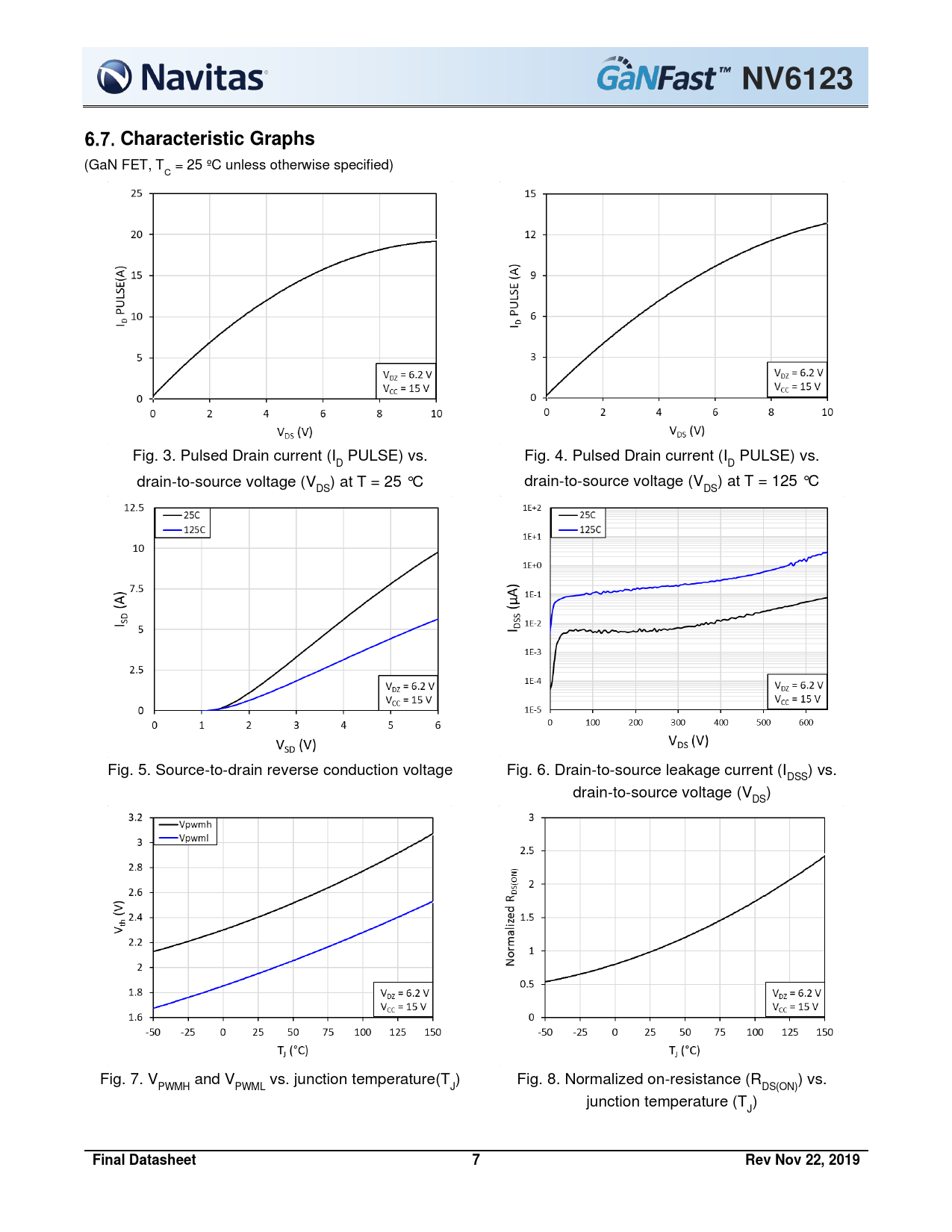

NV6123 Characteristic Graphs
(GaN FET, T = 25 ºC unless otherwise specified) C Fig. 3. Pulsed Drain current (I PULSE) vs. Fig. 4. Pulsed Drain current (I PULSE) vs. D D drain-to-source voltage (V ) at T = 25 °C drain-to-source voltage (V ) at T = 125 °C DS DS Fig. 5. Source-to-drain reverse conduction voltage Fig. 6. Drain-to-source leakage current (I ) vs. DSS drain-to-source voltage (V ) DS Fig. 7. V and V vs. junction temperature(T ) Fig. 8. Normalized on-resistance (R ) vs. PWMH PWML J DS(ON) junction temperature (T ) J
