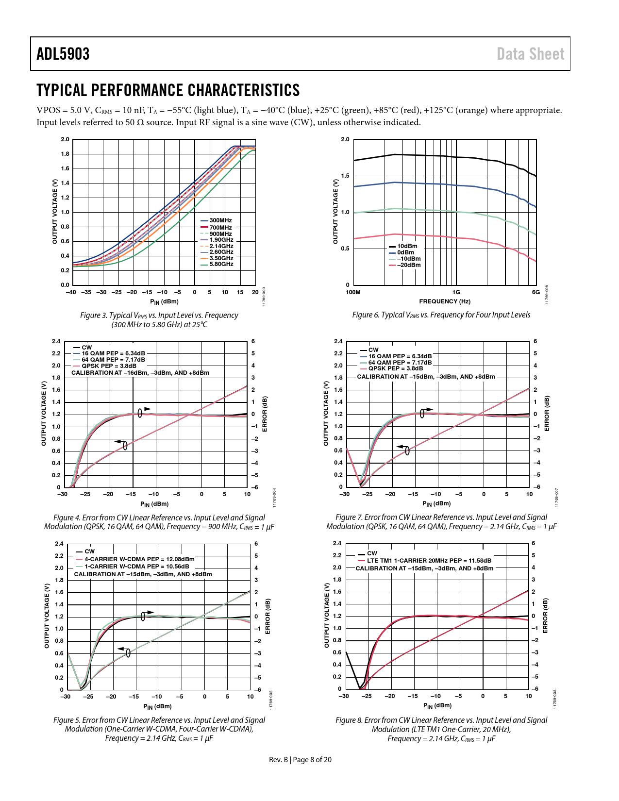

ADL5903. Data Sheet. TYPICAL PERFORMANCE CHARACTERISTICS. 2.0. 1.8. 1.6. 1.5. 1.4. E (V). G 1.2. O 1.0. T V. 300MHz. U 0.8. 700MHz. 900MHz. OU 0.6
ADL5903 Data Sheet TYPICAL PERFORMANCE CHARACTERISTICS 2.0 1.8 1.6 1.5 1.4 E (V) G 1.2 O 1.0 T V 300MHz U 0.8 700MHz 900MHz OU 0.6
VPOS = 5.0 V, CRMS = 10 nF, TA = −55°C (light blue), TA = −40°C (blue), +25°C (green), +85°C (red), +125°C (orange) where appropriate. Input levels referred to 50 Ω source. Input RF signal is a sine wave (CW), unless otherwise indicated.
2.0 2.0 1.8 1.6 1.5 1.4 E (V) E (V) G 1.2 G A A LT LT O 1.0 O 1.0 T V 300MHz T V U 0.8 U 700MHz TP 900MHz TP OU 0.6 1.90GHz OU 2.14GHz 0.5 10dBm 2.60GHz 0dBm 0.4 3.50GHz –10dBm 5.80GHz –20dBm 0.2 0.0 0 –40 –35 –30 –25 –20 –15 –10 –5 0 5 10 15 20

1 11769- Figure 3. Typical VRMS vs. Input Level vs. Frequency Figure 6. Typical VRMS vs. Frequency for Four Input Levels (300 MHz to 5.80 GHz) at 25°C
2.4 6 2.4 6 CW CW 2.2 16 QAM PEP = 6.34dB 5 2.2 5 16 QAM PEP = 6.34dB 64 QAM PEP = 7.17dB 64 QAM PEP = 7.17dB 2.0 QPSK PEP = 3.8dB 4 2.0 4 QPSK PEP = 3.8dB CALIBRATION AT –16dBm, –3dBm, AND +8dBm 1.8 3 1.8 CALIBRATION AT –15dBm, –3dBm, AND +8dBm 3 1.6 2 1.6 2 E (V) E (V) G G A 1.4 1 B) B) d A 1.4 1 d LT LT O 1.2 0 R ( O 1.2 0 R ( T V T V U 1.0 –1 RRO U 1.0 –1 RRO E E TP TP 0.8 –2 0.8 –2 OU OU 0.6 –3 0.6 –3 0.4 –4 0.4 –4 0.2 –5 0.2 –5 0 –6 0 –6

11769- Figure 4. Error from CW Linear Reference vs. Input Level and Signal Figure 7. Error from CW Linear Reference vs. Input Level and Signal Modulation (QPSK, 16 QAM, 64 QAM), Frequency = 900 MHz, CRMS = 1 µF Modulation (QPSK, 16 QAM, 64 QAM), Frequency = 2.14 GHz, CRMS = 1 µF
2.4 6 2.4 6 CW 2.2 5 2.2 CW 5 4-CARRIER W-CDMA PEP = 12.08dBm LTE TM1 1-CARRIER 20MHz PEP = 11.58dB 2.0 1-CARRIER W-CDMA PEP = 10.56dB 4 2.0 4 CALIBRATION AT –15dBm, –3dBm, AND +8dBm CALIBRATION AT –15dBm, –3dBm, AND +8dBm 1.8 3 1.8 3 1.6 2 1.6 2 E (V) E (V) G G A 1.4 1 B) B) d A 1.4 1 d LT LT O 1.2 0 R ( O 1.2 0 R ( T V T V U 1.0 –1 RRO U 1.0 –1 RRO E E TP TP 0.8 –2 0.8 –2 OU OU 0.6 –3 0.6 –3 0.4 –4 0.4 –4 0.2 –5 0.2 –5 0 –6 0 –6

11769- Figure 5. Error from CW Linear Reference vs. Input Level and Signal Figure 8. Error from CW Linear Reference vs. Input Level and Signal Modulation (One-Carrier W-CDMA, Four-Carrier W-CDMA), Modulation (LTE TM1 One-Carrier, 20 MHz), Frequency = 2.14 GHz, CRMS = 1 µF Frequency = 2.14 GHz, CRMS = 1 µF Rev. B | Page 8 of 20 Document Outline FEATURES APPLICATIONS FUNCTIONAL BLOCK DIAGRAM GENERAL DESCRIPTION TABLE OF CONTENTS REVISION HISTORY SPECIFICATIONS ABSOLUTE MAXIMUM RATINGS ESD CAUTION PIN CONFIGURATION AND FUNCTION DESCRIPTIONS TYPICAL PERFORMANCE CHARACTERISTICS MEASUREMENT SETUPS THEORY OF OPERATION RF INPUT INTERFACE BASIC CONNECTIONS CHOOSING A VALUE FOR CRMS DEVICE CALIBRATION AND ERROR CALCULATION EVALUATION BOARD SCHEMATIC AND CONFIGURATION OPTIONS OUTLINE DIMENSIONS ORDERING GUIDE
