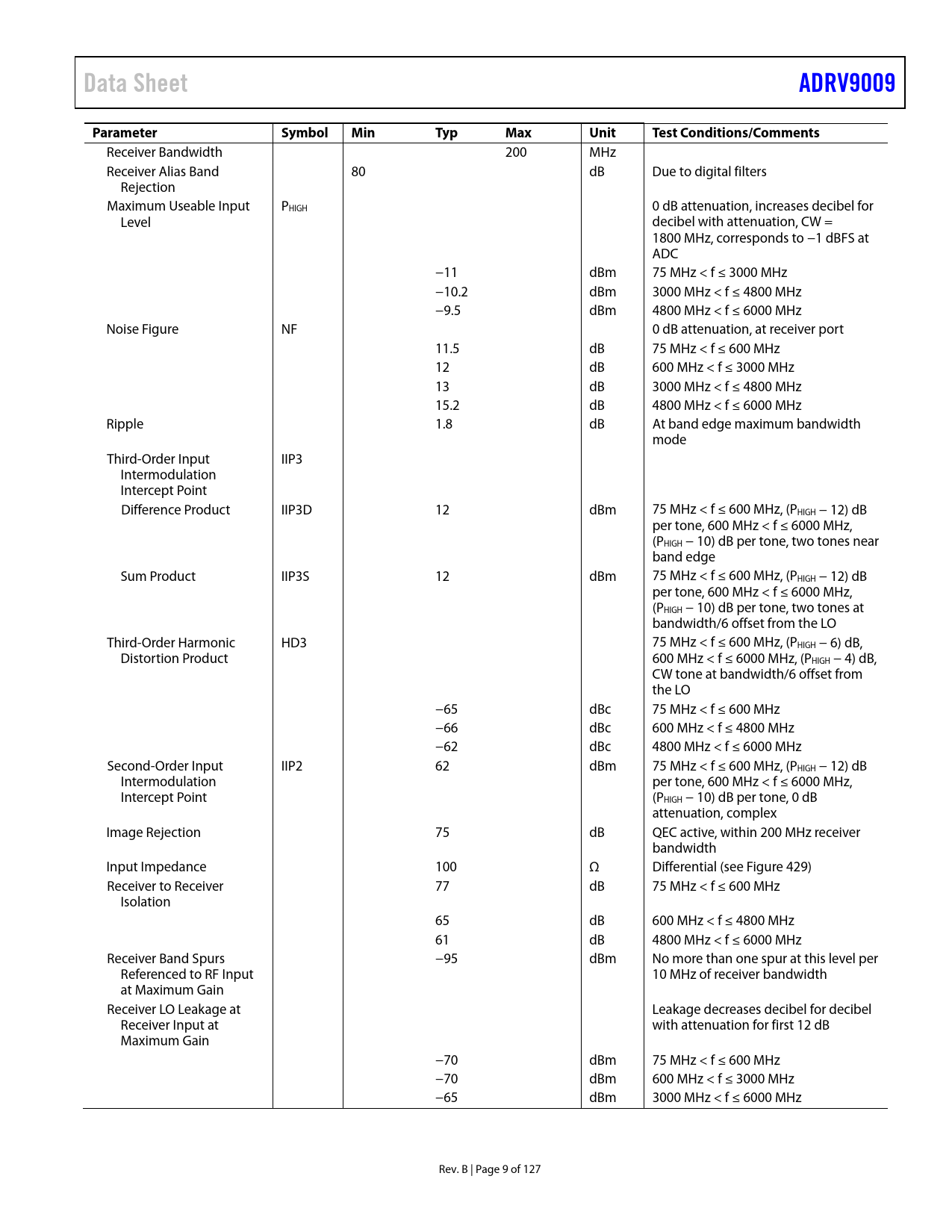

Data Sheet. ADRV9009. Parameter Symbol. Min. Typ. Max. Unit. Test. Conditions/Comments
Data Sheet ADRV9009 Parameter Symbol Min Typ Max Unit Test Conditions/Comments
link to page 96
Receiver Bandwidth 200 MHz Receiver Alias Band 80 dB Due to digital filters Rejection Maximum Useable Input PHIGH 0 dB attenuation, increases decibel for Level decibel with attenuation, CW = 1800 MHz, corresponds to −1 dBFS at ADC −11 dBm 75 MHz < f ≤ 3000 MHz −10.2 dBm 3000 MHz < f ≤ 4800 MHz −9.5 dBm 4800 MHz < f ≤ 6000 MHz Noise Figure NF 0 dB attenuation, at receiver port 11.5 dB 75 MHz < f ≤ 600 MHz 12 dB 600 MHz < f ≤ 3000 MHz 13 dB 3000 MHz < f ≤ 4800 MHz 15.2 dB 4800 MHz < f ≤ 6000 MHz Ripple 1.8 dB At band edge maximum bandwidth mode Third-Order Input IIP3 Intermodulation Intercept Point Difference Product IIP3D 12 dBm 75 MHz < f ≤ 600 MHz, (PHIGH − 12) dB per tone, 600 MHz < f ≤ 6000 MHz, (PHIGH − 10) dB per tone, two tones near band edge Sum Product IIP3S 12 dBm 75 MHz < f ≤ 600 MHz, (PHIGH − 12) dB per tone, 600 MHz < f ≤ 6000 MHz, (PHIGH − 10) dB per tone, two tones at bandwidth/6 offset from the LO Third-Order Harmonic HD3 75 MHz < f ≤ 600 MHz, (PHIGH − 6) dB, Distortion Product 600 MHz < f ≤ 6000 MHz, (PHIGH − 4) dB, CW tone at bandwidth/6 offset from the LO −65 dBc 75 MHz < f ≤ 600 MHz −66 dBc 600 MHz < f ≤ 4800 MHz −62 dBc 4800 MHz < f ≤ 6000 MHz Second-Order Input IIP2 62 dBm 75 MHz < f ≤ 600 MHz, (PHIGH − 12) dB Intermodulation per tone, 600 MHz < f ≤ 6000 MHz, Intercept Point (PHIGH − 10) dB per tone, 0 dB attenuation, complex Image Rejection 75 dB QEC active, within 200 MHz receiver bandwidth Input Impedance 100 Ω Differential (see Figure 429) Receiver to Receiver 77 dB 75 MHz < f ≤ 600 MHz Isolation 65 dB 600 MHz < f ≤ 4800 MHz 61 dB 4800 MHz < f ≤ 6000 MHz Receiver Band Spurs −95 dBm No more than one spur at this level per Referenced to RF Input 10 MHz of receiver bandwidth at Maximum Gain Receiver LO Leakage at Leakage decreases decibel for decibel Receiver Input at with attenuation for first 12 dB Maximum Gain −70 dBm 75 MHz < f ≤ 600 MHz −70 dBm 600 MHz < f ≤ 3000 MHz −65 dBm 3000 MHz < f ≤ 6000 MHz Rev. B | Page 9 of 127 Document Outline Features Applications General Description Revision History Functional Block Diagram Specifications Current and Power Consumption Specifications Timing Diagrams Absolute Maximum Ratings Reflow Profile Thermal Management Thermal Resistance ESD Caution Pin Configuration and Function Descriptions Typical Performance Characteristics 75 MHz to 525 MHz Band 650 MHz to 3000 MHz Band 3400 MHz to 4800 MHz Band 5100 MHz to 5900 MHz Band Transmitter Output Impedance Observation Receiver Input Impedance Receiver Input Impedance Terminology Theory of Operation Transmitter Receiver Observation Receiver Clock Input Synthesizers RF PLL Clock PLL SPI JTAG Boundary Scan Power Supply Sequence GPIO_x Pins Auxiliary Converters AUXADC_x Auxiliary DAC x JESD204B Data Interface Applications Information PCB Layout and Power Supply Recommendations Overview PCB Material and Stackup Selection Fanout and Trace Space Guidelines Component Placement and Routing Guidelines Signals with Highest Routing Priority Signals with Second Routing Priority Signals with Lowest Routing Priority RF and JESD204B Transmission Line Layout RF Routing Guidelines Transmitter Balun DC Feed Supplies JESD204B Trace Routing Recommendations Routing Recommendations Stripline Transmission Lines vs. Microstrip Transmission Lines Isolation Techniques Used on the ADRV9009-W/PCBZ Isolation Goals Isolation Between JESD204B Lines RF Port Interface Information RF Port Impedance Data Advanced Design System (ADS) Setup Using the DataAccessComponent and SEDZ File Transmitter Bias and Port Interface General Receiver Path Interface Impedance Matching Network Examples Outline Dimensions Ordering Guide
