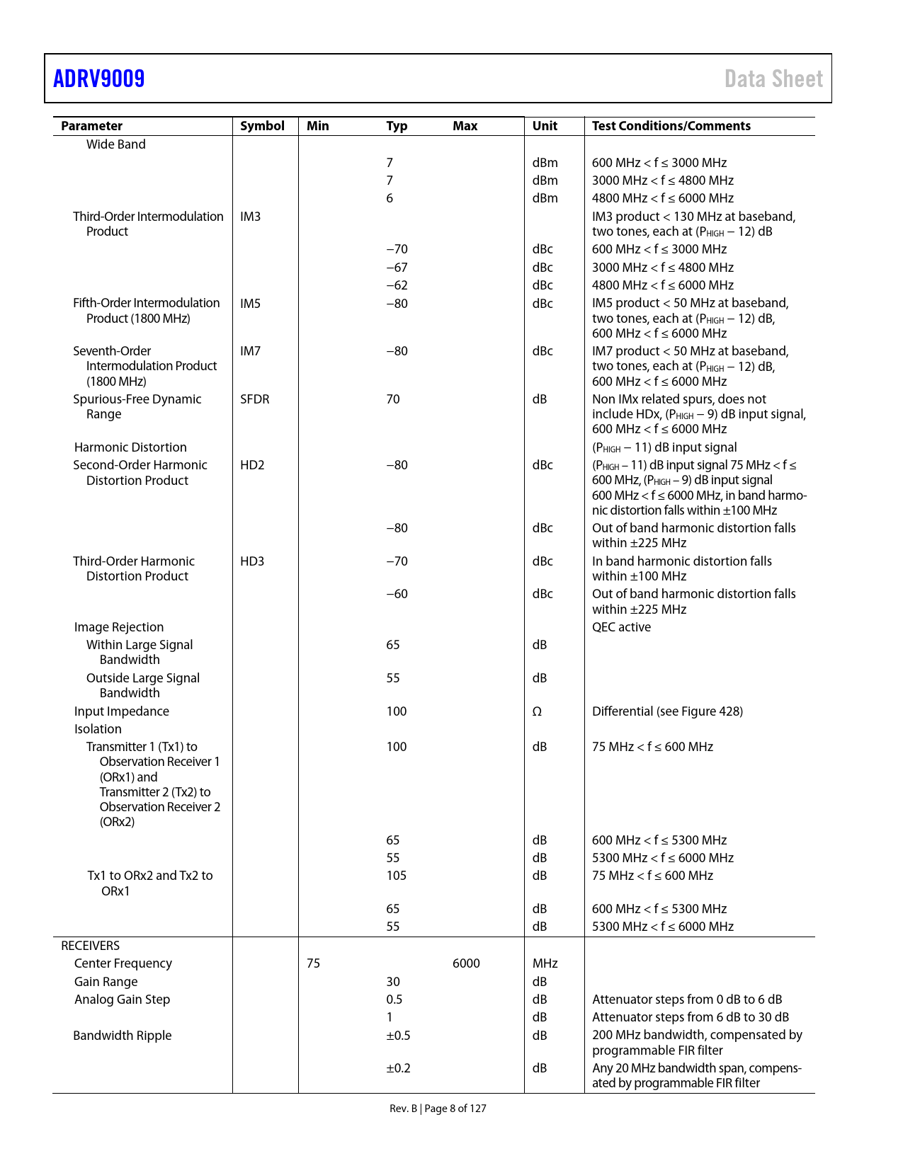

ADRV9009. Data Sheet. Parameter Symbol. Min. Typ. Max. Unit. Test. Conditions/Comments
ADRV9009 Data Sheet Parameter Symbol Min Typ Max Unit Test Conditions/Comments
link to page 95
Wide Band 7 dBm 600 MHz < f ≤ 3000 MHz 7 dBm 3000 MHz < f ≤ 4800 MHz 6 dBm 4800 MHz < f ≤ 6000 MHz Third-Order Intermodulation IM3 IM3 product < 130 MHz at baseband, Product two tones, each at (PHIGH − 12) dB −70 dBc 600 MHz < f ≤ 3000 MHz −67 dBc 3000 MHz < f ≤ 4800 MHz −62 dBc 4800 MHz < f ≤ 6000 MHz Fifth-Order Intermodulation IM5 −80 dBc IM5 product < 50 MHz at baseband, Product (1800 MHz) two tones, each at (PHIGH − 12) dB, 600 MHz < f ≤ 6000 MHz Seventh-Order IM7 −80 dBc IM7 product < 50 MHz at baseband, Intermodulation Product two tones, each at (PHIGH − 12) dB, (1800 MHz) 600 MHz < f ≤ 6000 MHz Spurious-Free Dynamic SFDR 70 dB Non IMx related spurs, does not Range include HDx, (PHIGH − 9) dB input signal, 600 MHz < f ≤ 6000 MHz Harmonic Distortion (PHIGH − 11) dB input signal Second-Order Harmonic HD2 −80 dBc (PHIGH – 11) dB input signal 75 MHz < f ≤ Distortion Product 600 MHz, (PHIGH – 9) dB input signal 600 MHz < f ≤ 6000 MHz, in band harmo- nic distortion falls within ±100 MHz −80 dBc Out of band harmonic distortion falls within ±225 MHz Third-Order Harmonic HD3 −70 dBc In band harmonic distortion falls Distortion Product within ±100 MHz −60 dBc Out of band harmonic distortion falls within ±225 MHz Image Rejection QEC active Within Large Signal 65 dB Bandwidth Outside Large Signal 55 dB Bandwidth Input Impedance 100 Ω Differential (see Figure 428) Isolation Transmitter 1 (Tx1) to 100 dB 75 MHz < f ≤ 600 MHz Observation Receiver 1 (ORx1) and Transmitter 2 (Tx2) to Observation Receiver 2 (ORx2) 65 dB 600 MHz < f ≤ 5300 MHz 55 dB 5300 MHz < f ≤ 6000 MHz Tx1 to ORx2 and Tx2 to 105 dB 75 MHz < f ≤ 600 MHz ORx1 65 dB 600 MHz < f ≤ 5300 MHz 55 dB 5300 MHz < f ≤ 6000 MHz RECEIVERS Center Frequency 75 6000 MHz Gain Range 30 dB Analog Gain Step 0.5 dB Attenuator steps from 0 dB to 6 dB 1 dB Attenuator steps from 6 dB to 30 dB Bandwidth Ripple ±0.5 dB 200 MHz bandwidth, compensated by programmable FIR filter ±0.2 dB Any 20 MHz bandwidth span, compens- ated by programmable FIR filter Rev. B | Page 8 of 127 Document Outline Features Applications General Description Revision History Functional Block Diagram Specifications Current and Power Consumption Specifications Timing Diagrams Absolute Maximum Ratings Reflow Profile Thermal Management Thermal Resistance ESD Caution Pin Configuration and Function Descriptions Typical Performance Characteristics 75 MHz to 525 MHz Band 650 MHz to 3000 MHz Band 3400 MHz to 4800 MHz Band 5100 MHz to 5900 MHz Band Transmitter Output Impedance Observation Receiver Input Impedance Receiver Input Impedance Terminology Theory of Operation Transmitter Receiver Observation Receiver Clock Input Synthesizers RF PLL Clock PLL SPI JTAG Boundary Scan Power Supply Sequence GPIO_x Pins Auxiliary Converters AUXADC_x Auxiliary DAC x JESD204B Data Interface Applications Information PCB Layout and Power Supply Recommendations Overview PCB Material and Stackup Selection Fanout and Trace Space Guidelines Component Placement and Routing Guidelines Signals with Highest Routing Priority Signals with Second Routing Priority Signals with Lowest Routing Priority RF and JESD204B Transmission Line Layout RF Routing Guidelines Transmitter Balun DC Feed Supplies JESD204B Trace Routing Recommendations Routing Recommendations Stripline Transmission Lines vs. Microstrip Transmission Lines Isolation Techniques Used on the ADRV9009-W/PCBZ Isolation Goals Isolation Between JESD204B Lines RF Port Interface Information RF Port Impedance Data Advanced Design System (ADS) Setup Using the DataAccessComponent and SEDZ File Transmitter Bias and Port Interface General Receiver Path Interface Impedance Matching Network Examples Outline Dimensions Ordering Guide
