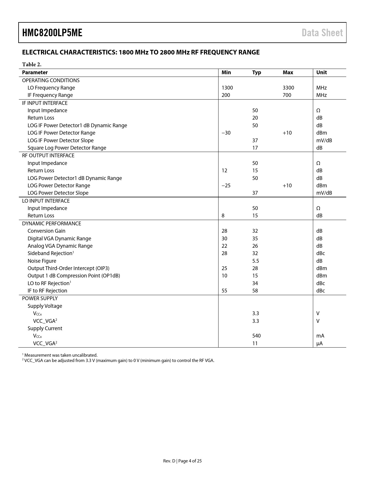

HMC8200LP5ME. Data Sheet. ELECTRICAL CHARACTERISTICS: 1800 MHz TO 2800 MHz RF FREQUENCY RANGE. Table 2. Parameter. Min. Typ. Max
HMC8200LP5ME Data Sheet ELECTRICAL CHARACTERISTICS: 1800 MHz TO 2800 MHz RF FREQUENCY RANGE Table 2 Parameter Min Typ Max
HMC8200LP5ME Data Sheet ELECTRICAL CHARACTERISTICS: 1800 MHz TO 2800 MHz RF FREQUENCY RANGE Table 2. Parameter Min Typ Max Unit
OPERATING CONDITIONS LO Frequency Range 1300 3300 MHz IF Frequency Range 200 700 MHz IF INPUT INTERFACE Input Impedance 50 Ω Return Loss 20 dB LOG IF Power Detector1 dB Dynamic Range 50 dB LOG IF Power Detector Range −30 +10 dBm LOG IF Power Detector Slope 37 mV/dB Square Log Power Detector Range 17 dB RF OUTPUT INTERFACE Input Impedance 50 Ω Return Loss 12 15 dB LOG Power Detector1 dB Dynamic Range 50 dB LOG Power Detector Range −25 +10 dBm LOG Power Detector Slope 37 mV/dB LO INPUT INTERFACE Input Impedance 50 Ω Return Loss 8 15 dB DYNAMIC PERFORMANCE Conversion Gain 28 32 dB Digital VGA Dynamic Range 30 35 dB Analog VGA Dynamic Range 22 26 dB Sideband Rejection1 28 32 dBc Noise Figure 5.5 dB Output Third-Order Intercept (OIP3) 25 28 dBm Output 1 dB Compression Point (OP1dB) 10 15 dBm LO to RF Rejection1 34 dBc IF to RF Rejection 55 58 dBc POWER SUPPLY Supply Voltage VCCx 3.3 V VCC_VGA2 3.3 V Supply Current VCCx 540 mA VCC_VGA2 11 μA 1 Measurement was taken uncalibrated. 2 VCC_VGA can be adjusted from 3.3 V (maximum gain) to 0 V (minimum gain) to control the RF VGA. Rev. D | Page 4 of 25 Document Outline Features Applications Functional Block Diagram General Description Revision History Specifications Electrical Characteristics: 800 MHz to 1800 MHz RF Frequency Range Electrical Characteristics: 1800 MHz to 2800 MHz RF Frequency Range Electrical Characteristics: 2800 MHz to 4000 MHz RF Frequency Range Absolute Maximum Ratings ESD Caution Pin Configuration and Function Descriptions Typical Performance Characteristics Theory of Operation Register Array Assignments and Serial Interface Read Example Register Descriptions Register Array Assignments Enable Bits Digital Gain Amplifier: DGA Control Digital Gain Amplifier: Amplifier Current, Envelope Level, and VGA Attenuation Bias Image Reject Mixer: Sideband, and Polarity and Offset for I Image Reject Mixer: Polarity and Offset for Q Phase I: Adjust Phase Q: Adjust Evaluation Printed Circuit Board (PCB) Evaluation PCB Schematic Outline Dimensions Ordering Guide
