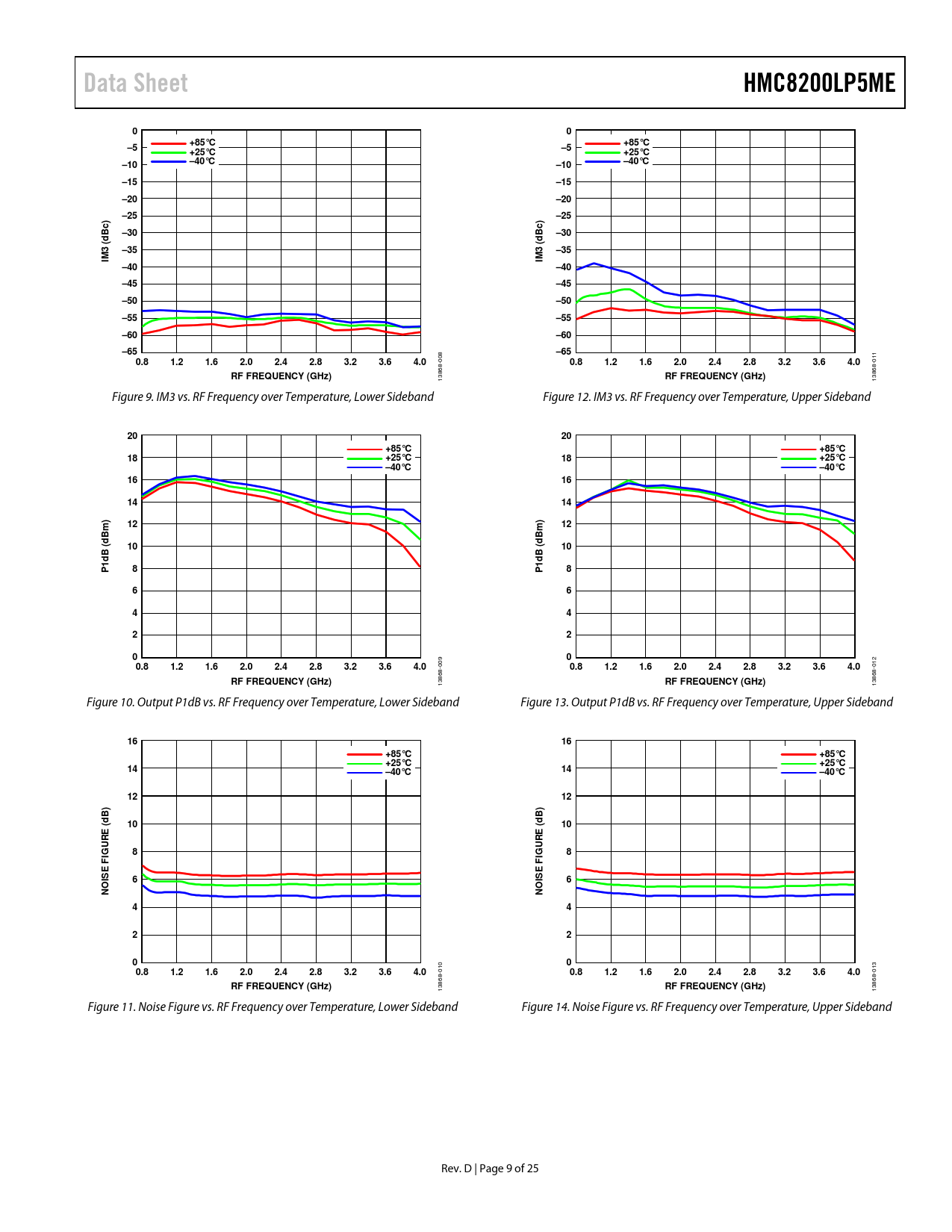

Data Sheet. HMC8200LP5ME. +85°C. +25°C. –10. –40°C. –15. –20. –25. Bc). –30. 3 (. –35. –40. –45. –50. –55. –60. –65. 0.8. 1.2. 1.6. 2.0. 2.4. 2.8. 3.2. 3.6. 4.0
Data Sheet HMC8200LP5ME +85°C +25°C –10 –40°C –15 –20 –25 Bc) –30 3 ( –35 –40 –45 –50 –55 –60 –65 0.8 1.2 1.6 2.0 2.4 2.8 3.2 3.6 4.0
Data Sheet HMC8200LP5ME 0 0 +85°C +85°C –5 +25°C –5 +25°C –10 –40°C –10 –40°C –15 –15 –20 –20 –25 –25 Bc) –30 Bc) –30 d d 3 ( –35 3 ( –35 IM IM –40 –40 –45 –45 –50 –50 –55 –55 –60 –60 –65 –65

13868- Figure 9. IM3 vs. RF Frequency over Temperature, Lower Sideband Figure 12. IM3 vs. RF Frequency over Temperature, Upper Sideband
20 20 +85°C +85°C 18 +25°C 18 +25°C –40°C –40°C 16 16 14 14 12 12 Bm) Bm) d d 10 10 B ( B ( 1d 1d P 8 P 8 6 6 4 4 2 2 0 0 0.8 1.2 1.6 2.0 2.4 2.8 3.2 3.6 4.0

13868- Figure 10. Output P1dB vs. RF Frequency over Temperature, Lower Sideband Figure 13. Output P1dB vs. RF Frequency over Temperature, Upper Sideband
16 16 +85°C +85°C +25°C +25°C 14 –40°C 14 –40°C 12 12 ) ) dB dB ( 10 ( 10 E E R R 8 8 FIGU FIGU E E 6 6 OIS OIS N N 4 4 2 2 0 0 0.8 1.2 1.6 2.0 2.4 2.8 3.2 3.6 4.0

13868- Figure 11. Noise Figure vs. RF Frequency over Temperature, Lower Sideband Figure 14. Noise Figure vs. RF Frequency over Temperature, Upper Sideband Rev. D | Page 9 of 25 Document Outline Features Applications Functional Block Diagram General Description Revision History Specifications Electrical Characteristics: 800 MHz to 1800 MHz RF Frequency Range Electrical Characteristics: 1800 MHz to 2800 MHz RF Frequency Range Electrical Characteristics: 2800 MHz to 4000 MHz RF Frequency Range Absolute Maximum Ratings ESD Caution Pin Configuration and Function Descriptions Typical Performance Characteristics Theory of Operation Register Array Assignments and Serial Interface Read Example Register Descriptions Register Array Assignments Enable Bits Digital Gain Amplifier: DGA Control Digital Gain Amplifier: Amplifier Current, Envelope Level, and VGA Attenuation Bias Image Reject Mixer: Sideband, and Polarity and Offset for I Image Reject Mixer: Polarity and Offset for Q Phase I: Adjust Phase Q: Adjust Evaluation Printed Circuit Board (PCB) Evaluation PCB Schematic Outline Dimensions Ordering Guide
