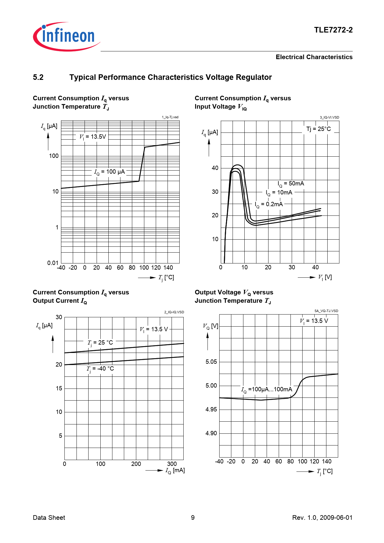

TLE7272-2. Electrical Characteristics. 5.2. Typical Performance Characteristics Voltage Regulator. Current Consumption I
TLE7272-2 Electrical Characteristics 5.2 Typical Performance Characteristics Voltage Regulator Current Consumption I
TLE7272-2 Electrical Characteristics 5.2 Typical Performance Characteristics Voltage Regulator Current Consumption I q versus Current Consumption I q versus Junction Temperature T J Input Voltage V IQ
1_Iq-Tj.vsd 3_IQ-VI.VSD I [µA] q I [µA] Tj = 25°C V = 13.5V q I 100 40 I = 100 µA Q I = 50mA Q 10 30 I = 10mA Q I = 0.2mA Q 20 1 10 0.01-40 -20 0 20 40 60 80 100 120 140 0 10 20 30 40 T [°C] V [V] j I
Current Consumption I q versus Output Voltage V Q versus Output Current I Q Junction Temperature T J
2_IQ-IQ.VSD 5A_VQ-TJ.VSD 30 V = 13.5 V I [µA] I q V V [V] = 13.5 V Q I T = 25 °C j 20 5.05 T = -40 °C j 15 5.00 I =100µA...100mA Q 10 4.95 5 4.90 0 100 200 300 -40 -20 0 20 40 60 80 100 120 140 I [mA] Q T [°C] j Data Sheet 9 Rev. 1.0, 2009-06-01 Document Outline 1 Overview 2 Block Diagram 3 Pin Configuration 3.1 Pin Assignment PG-SSOP-14 Exposed Pad 3.2 Pin Definitions and Functions PG-SSOP-14 Exposed Pad 3.3 Pin Assignment PG-TO252-5 3.4 Pin Definitions and Functions PG-TO252-5 4 General Product Characteristics 4.1 Absolute Maximum Ratings 4.2 Functional Range 4.3 Thermal Resistance 5 Electrical Characteristics 5.1 Electrical Characteristics Voltage Regulator 5.2 Typical Performance Characteristics Voltage Regulator 5.3 Electrical Characteristics Enable Function 5.4 Typical Performance Characteristics Enable Function 5.5 Electrical Characteristics Reset Function 5.6 Typical Performance Characteristics Reset Function 6 Package Outlines 7 Revision History
