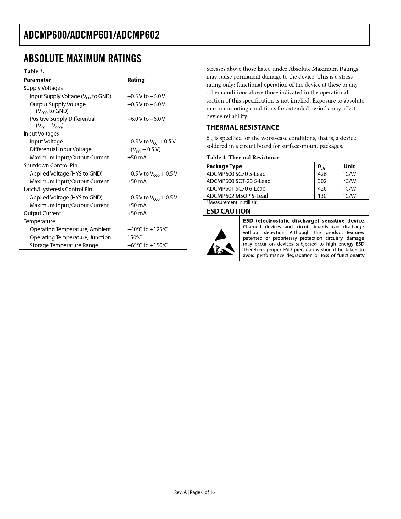

ADCMP600/ADCMP601/ADCMP602 ABSOLUTE MAXIMUM RATINGS Table 3.
Stresses above those listed under Absolute Maximum Ratings
Parameter Rating
may cause permanent damage to the device. This is a stress rating only; functional operation of the device at these or any Supply Voltages other conditions above those indicated in the operational Input Supply Voltage (V to GND) −0.5 V to +6.0 V CCI section of this specification is not implied. Exposure to absolute Output Supply Voltage −0.5 V to +6.0 V (V to GND) maximum rating conditions for extended periods may affect CCO Positive Supply Differential −6.0 V to +6.0 V device reliability. (V − V ) CCI CCO
THERMAL RESISTANCE
Input Voltages θ Input Voltage −0.5 V to V + 0.5 V JA is specified for the worst-case conditions, that is, a device CCI soldered in a circuit board for surface-mount packages. Differential Input Voltage ±(V + 0.5 V) CCI Maximum Input/Output Current ±50 mA
Table 4. Thermal Resistance
Shutdown Control Pin
Package Type θ 1 Unit JA
Applied Voltage (HYS to GND) −0.5 V to V + 0.5 V CCO ADCMP600 SC70 5-Lead 426 °C/W Maximum Input/Output Current ±50 mA ADCMP600 SOT-23 5-Lead 302 °C/W Latch/Hysteresis Control Pin ADCMP601 SC70 6-Lead 426 °C/W Applied Voltage (HYS to GND) −0.5 V to V + 0.5 V ADCMP602 MSOP 5-Lead 130 °C/W CCO 1 Maximum Input/Output Current ±50 mA Measurement in stil air. Output Current ±50 mA

Temperature Operating Temperature, Ambient −40°C to +125°C Operating Temperature, Junction 150°C Storage Temperature Range −65°C to +150°C Rev. A | Page 6 of 16 Document Outline Features Applications Functional Block Diagram General Description Revision History Specifications Electrical Characteristics Timing Information Absolute Maximum Ratings Thermal Resistance ESD Caution Pin Configuration and Function Descriptions Typical Performance Characteristics Application Information Power/Ground Layout and Bypassing TTL-/CMOS-Compatible Output Stage Using/Disabling the Latch Feature Optimizing Performance Comparator Propagation Delay Dispersion Comparator Hysteresis Crossover Bias Point Minimum Input Slew Rate Requirement Typical Application Circuits Outline Dimensions Ordering Guide
