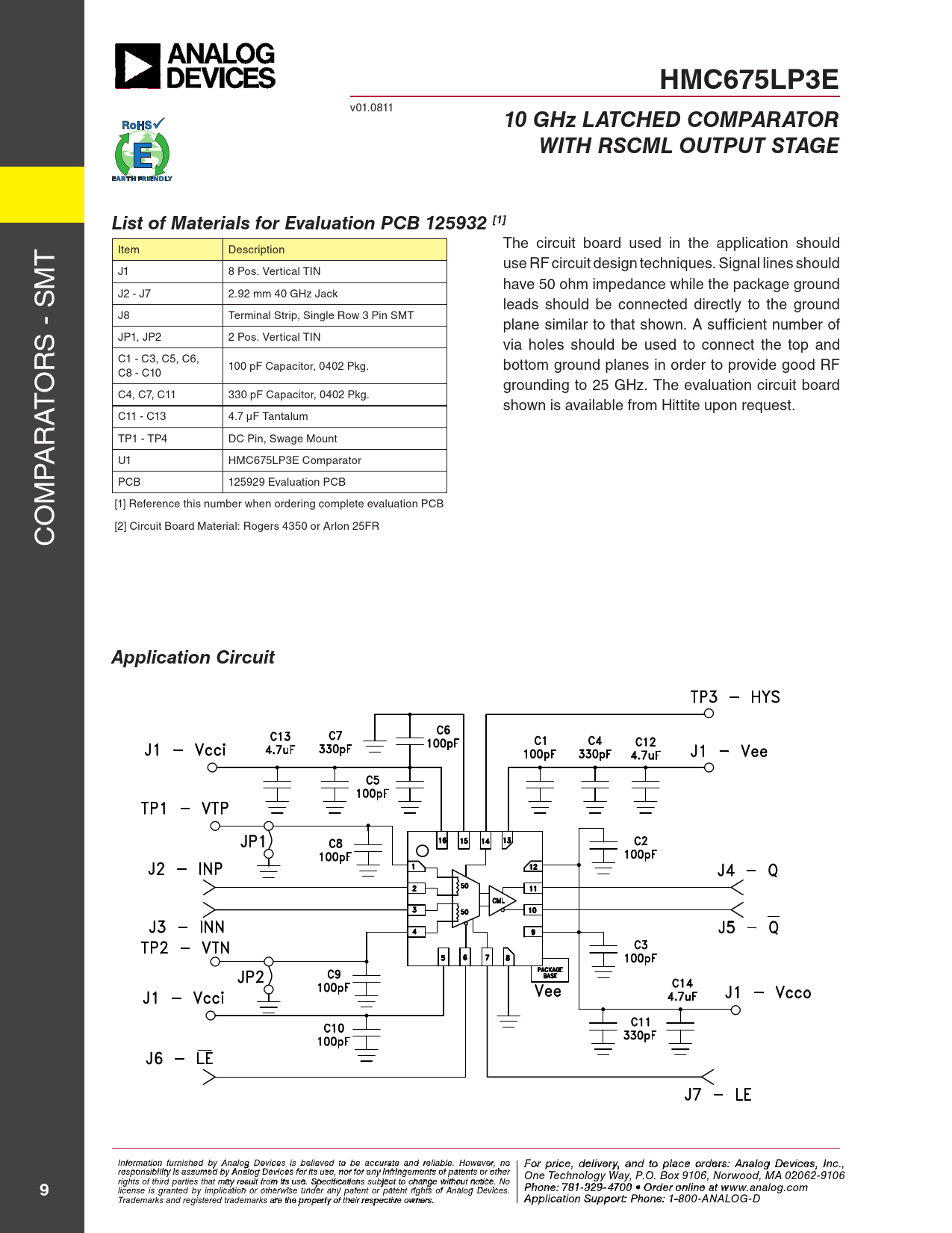

HMC675LP3E. 10 GHz LATCHED COMPARATOR. WITH RSCML OUTPUT STAGE. List of Materials for Evaluation PCB 125932 [1]
HMC675LP3E 10 GHz LATCHED COMPARATOR WITH RSCML OUTPUT STAGE List of Materials for Evaluation PCB 125932 [1]
HMC675LP3E
v01.0811
T The circuit board used in the application should Item Description use RF circuit design techniques. Signal lines should M J1 8 Pos. Vertical TIN have 50 ohm impedance while the package ground J2 - J7 2.92 mm 40 GHz Jack leads should be connected directly to the ground J8 Terminal Strip, Single Row 3 Pin SMT plane similar to that shown. A sufficient number of S - S JP1, JP2 2 Pos. Vertical TIN via holes should be used to connect the top and R C1 - C3, C5, C6, 100 pF Capacitor, 0402 Pkg. bottom ground planes in order to provide good RF O C8 - C10 grounding to 25 GHz. The evaluation circuit board C4, C7, C11 330 pF Capacitor, 0402 Pkg. AT shown is available from Hittite upon request. C11 - C13 4.7 µF Tantalum R TP1 - TP4 DC Pin, Swage Mount A P U1 HMC675LP3E Comparator PCB 125929 Evaluation PCB OM [1] Reference this number when ordering complete evaluation PCB C [2] Circuit Board Material: Rogers 4350 or Arlon 25FR
