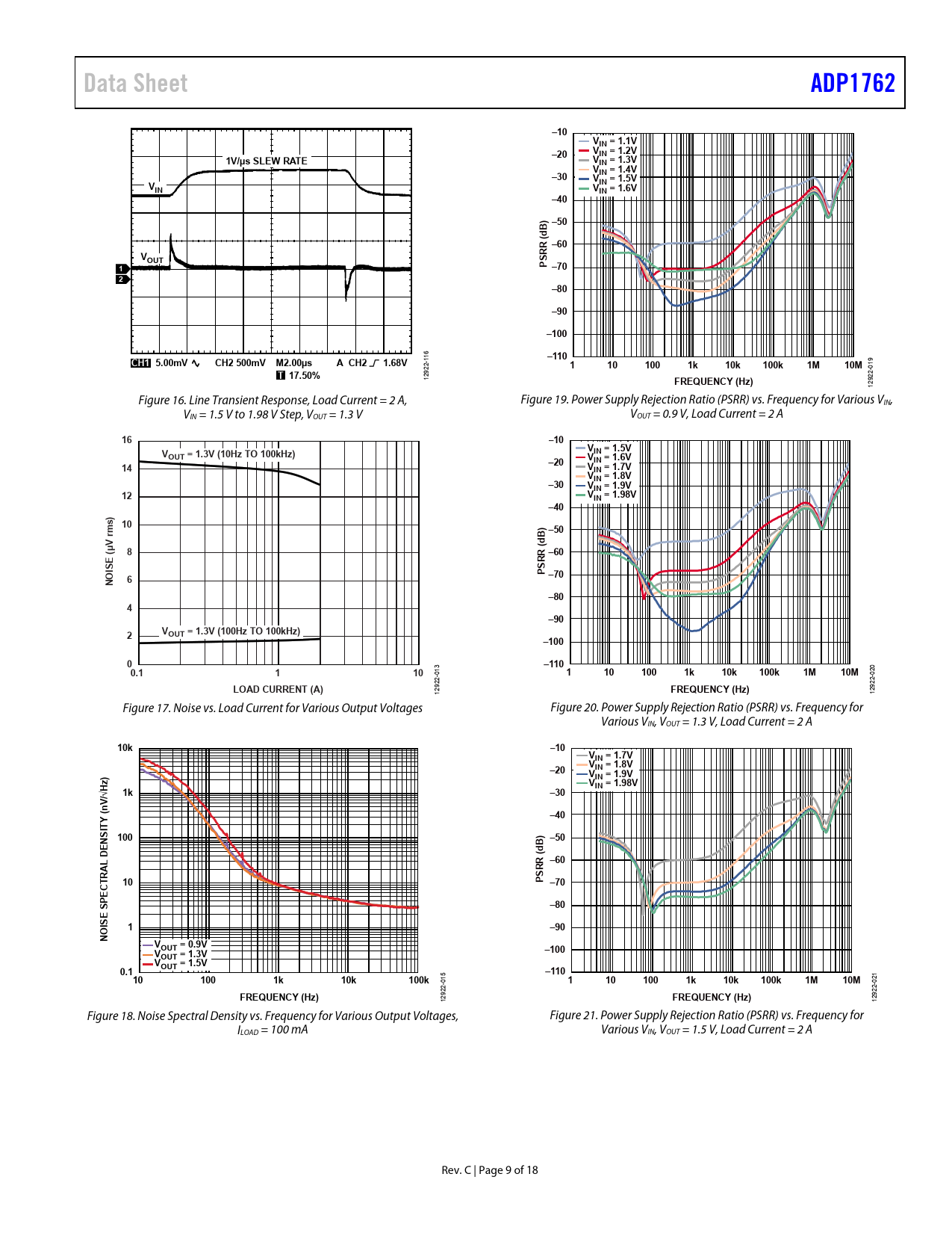

Description2 A, Low VIN, Low Noise, CMOS Linear Regulator
Pages / Page18 / 9 — Data Sheet. ADP1762. –10. VIN = 1.1V. –20. VIN = 1.2V. 1V/µs SLEW RATE. …
RevisionC
File Format / SizePDF / 928 Kb
Data Sheet. ADP1762. –10. VIN = 1.1V. –20. VIN = 1.2V. 1V/µs SLEW RATE. VIN = 1.3V. –30. IN = 1.4V. VIN = 1.5V. VIN. VIN = 1.6V. –40. –50. B) (d –60
Data Sheet ADP1762 –10 VIN = 1.1V –20 VIN = 1.2V 1V/µs SLEW RATE VIN = 1.3V –30 IN = 1.4V VIN = 1.5V VIN VIN = 1.6V –40 –50 B) (d –60
Data Sheet ADP1762 –10 VIN = 1.1V –20 VIN = 1.2V 1V/µs SLEW RATE VIN = 1.3V V –30 IN = 1.4V VIN = 1.5V VIN VIN = 1.6V –40 –50 B) (d –60 RR VOUT S P 1 –70 2 –80 –90 –100 –110 CH1 5.00mV CH2 500mV M2.00µs A CH2 1.68V

129 Figure 16. Line Transient Response, Load Current = 2 A, Figure 19. Power Supply Rejection Ratio (PSRR) vs. Frequency for Various VIN, VIN = 1.5 V to 1.98 V Step, VOUT = 1.3 V VOUT = 0.9 V, Load Current = 2 A
16 –10 V V IN = 1.5V OUT = 1.3V (10Hz TO 100kHz) –20 VIN = 1.6V 14 VIN = 1.7V VIN = 1.8V –30 VIN = 1.9V 12 VIN = 1.98V –40 s) 10 rm –50 B) (d (µV 8 –60 RR ISE S O P –70 6 N –80 4 –90 2 VOUT = 1.3V (100Hz TO 100kHz) –100 0 –110

12 Figure 17. Noise vs. Load Current for Various Output Voltages Figure 20. Power Supply Rejection Ratio (PSRR) vs. Frequency for Various VIN, VOUT = 1.3 V, Load Current = 2 A
10k –10 VIN = 1.7V VIN = 1.8V –20 V z) IN = 1.9V VIN = 1.98V 1k /√H –30 V (n –40 TY SI 100 –50 EN B) (d D L –60 A RR R S T 10 P –70 SPEC –80 ISE 1 O –90 N VOUT = 0.9V V –100 OUT = 1.3V VOUT = 1.5V 0.1

12 Figure 18. Noise Spectral Density vs. Frequency for Various Output Voltages, Figure 21. Power Supply Rejection Ratio (PSRR) vs. Frequency for ILOAD = 100 mA Various VIN, VOUT = 1.5 V, Load Current = 2 A Rev. C | Page 9 of 18 Document Outline Features Applications General Description Typical Application Circuits Revision History Specifications Input and Output Capacitor: Recommended Specifications Absolute Maximum Ratings Thermal Data Thermal Resistance/Parameter ESD Caution Pin Configuration and Function Descriptions Typical Performance Characteristics Theory of Operation Soft Start Function Adjustable Output Voltage Enable Feature Power-Good (PG) Feature Applications Information Capacitor Selection Output Capacitor Input Bypass Capacitor Input and Output Capacitor Properties Undervoltage Lockout Current-Limit and Thermal Overload Protection Thermal Considerations PCB Layout Considerations Outline Dimensions Ordering Guide
