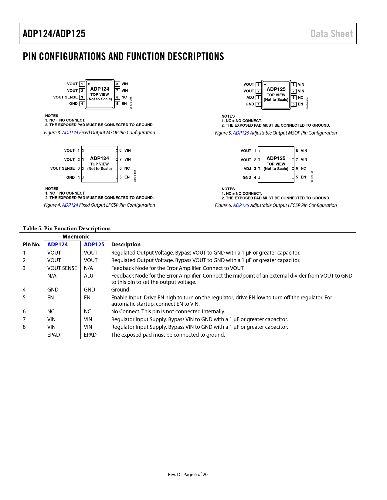

ADP124/ADP125. Data Sheet. PIN CONFIGURATIONS AND FUNCTION DESCRIPTIONS. VOUT. VIN. ADP124. ADP125. TOP VIEW. VOUT SENSE 3
ADP124/ADP125 Data Sheet PIN CONFIGURATIONS AND FUNCTION DESCRIPTIONS VOUT VIN ADP124 ADP125 TOP VIEW VOUT SENSE 3
ADP124/ADP125 Data Sheet PIN CONFIGURATIONS AND FUNCTION DESCRIPTIONS VOUT 1 8 VIN VOUT 1 8 VIN VOUT ADP124 2 7 VIN VOUT ADP125 2 7 VIN TOP VIEW TOP VIEW VOUT SENSE 3 6 NC (Not to Scale)
3
ADJ 3 6 NC
4
(Not to Scale)
-00 -00
GND 4 5 EN GND
6
5 EN
476
4
47 08 08
NOTES NOTES 1. NC = NO CONNECT. 1. NC = NO CONNECT. 2. THE EXPOSED PAD MUST BE CONNECTED TO GROUND. 2. THE EXPOSED PAD MUST BE CONNECTED TO GROUND.
Figure 3. ADP124 Fixed Output MSOP Pin Configuration Figure 5. ADP125 Adjustable Output MSOP Pin Configuration
VOUT 1 8 VIN VOUT 1 8 VIN VOUT 2 ADP124 7 VIN VOUT 2 ADP125 7 VIN TOP VIEW TOP VIEW VOUT SENSE 3 (Not to Scale) 6 NC ADJ 3 (Not to Scale) 6 NC
5 10 06 6- -1
GND 4 5 EN GND 4 5 EN
76 847 0 084
Figure 4. ADP124 Fixed Output LFCSP Pin Configuration Figure 6. ADP125 Adjustable Output LFCSP Pin Configuration
Table 5. Pin Function Descriptions Mnemonic Pin No. ADP124 ADP125 Description
1 VOUT VOUT Regulated Output Voltage. Bypass VOUT to GND with a 1 μF or greater capacitor. 2 VOUT VOUT Regulated Output Voltage. Bypass VOUT to GND with a 1 μF or greater capacitor. 3 VOUT SENSE N/A Feedback Node for the Error Amplifier. Connect to VOUT. N/A ADJ Feedback Node for the Error Amplifier. Connect the midpoint of an external divider from VOUT to GND to this pin to set the output voltage. 4 GND GND Ground. 5 EN EN Enable Input. Drive EN high to turn on the regulator; drive EN low to turn off the regulator. For automatic startup, connect EN to VIN. 6 NC NC No Connect. This pin is not connected internally. 7 VIN VIN Regulator Input Supply. Bypass VIN to GND with a 1 μF or greater capacitor. 8 VIN VIN Regulator Input Supply. Bypass VIN to GND with a 1 μF or greater capacitor. EPAD EPAD The exposed pad must be connected to ground. Rev. D | Page 6 of 20 Document Outline FEATURES APPLICATIONS TYPICAL APPLICATION CIRCUITS GENERAL DESCRIPTION TABLE OF CONTENTS REVISION HISTORY SPECIFICATIONS RECOMMENDED CAPACITOR SPECIFICATIONS ABSOLUTE MAXIMUM RATINGS THERMAL DATA THERMAL RESISTANCE ESD CAUTION PIN CONFIGURATIONS AND FUNCTION DESCRIPTIONS TYPICAL PERFORMANCE CHARACTERISTICS THEORY OF OPERATION APPLICATIONS INFORMATION CAPACITOR SELECTION Output Capacitor Input Bypass Capacitor Input and Output Capacitor Properties UNDERVOLTAGE LOCKOUT ENABLE FEATURE CURRENT LIMIT AND THERMAL OVERLOAD PROTECTION THERMAL CONSIDERATIONS JUNCTION TEMPERATURE CALCULATIONS PRINTED CIRCUIT BOARD LAYOUT CONSIDERATIONS OUTLINE DIMENSIONS ORDERING GUIDE
