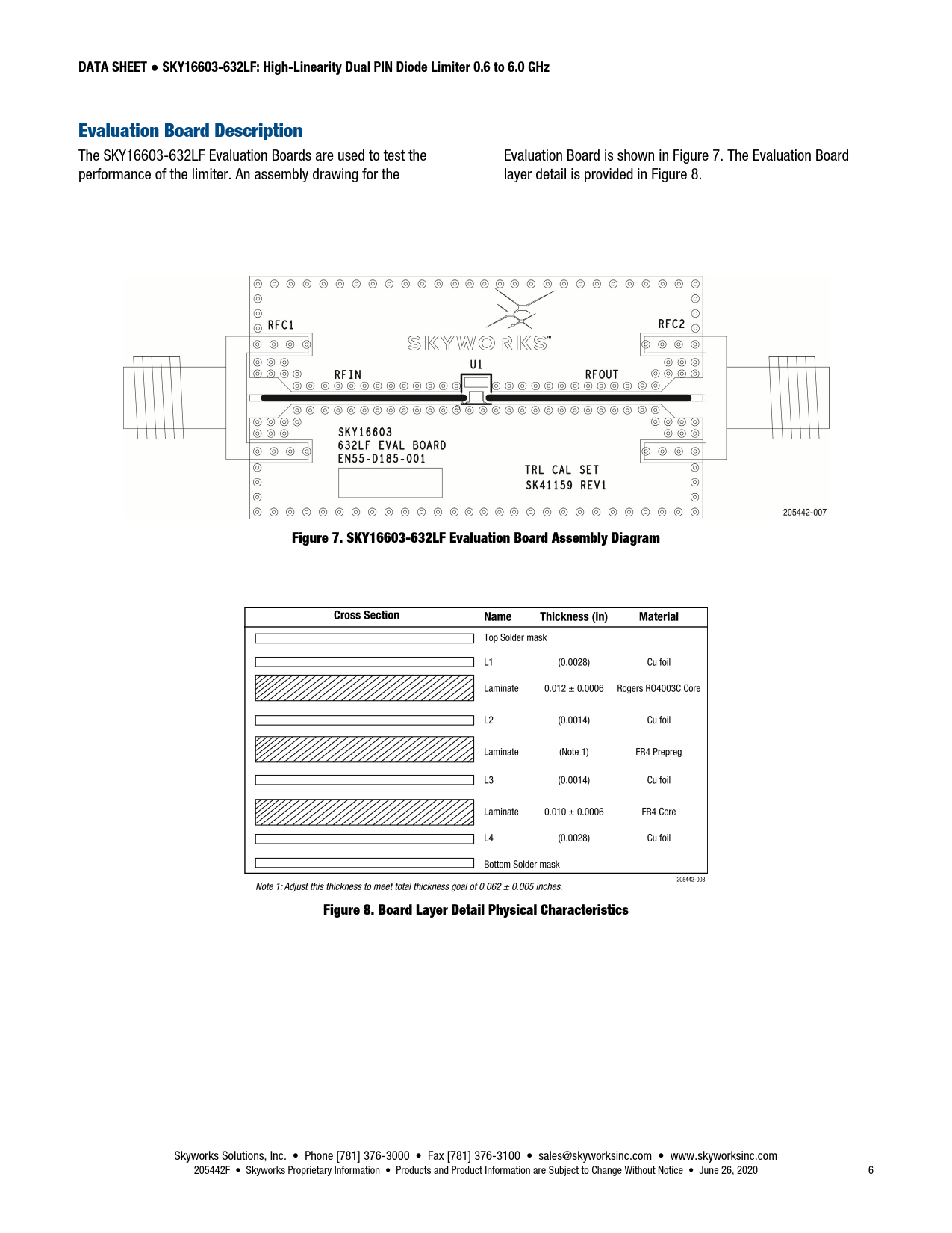

The SKY16603-632LF Evaluation Boards are used to test the Evaluation Board is shown in Figure 7. The Evaluation Board performance of the limiter. An assembly drawing for the layer detail is provided in Figure 8.
Figure 7. SKY16603-632LF Evaluation Board Assembly Diagram Figure 8. Board Layer Detail Physical Characteristics
