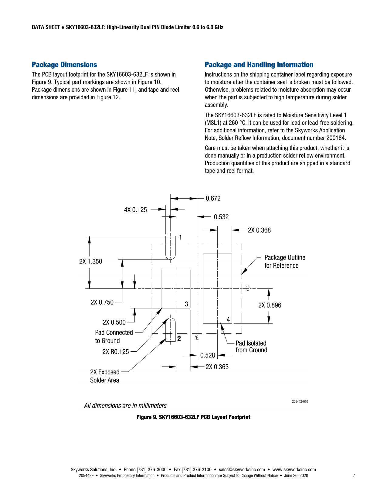

DATA SHEET ● SKY16603-632LF: High-Linearity Dual PIN Diode Limiter 0.6 to 6.0 GHz. Package Dimensions
DATA SHEET ● SKY16603-632LF: High-Linearity Dual PIN Diode Limiter 0.6 to 6.0 GHz Package Dimensions
DATA SHEET ● SKY16603-632LF: High-Linearity Dual PIN Diode Limiter 0.6 to 6.0 GHz Package Dimensions Package and Handling Information
The PCB layout footprint for the SKY16603-632LF is shown in Instructions on the shipping container label regarding exposure Figure 9. Typical part markings are shown in Figure 10. to moisture after the container seal is broken must be followed. Package dimensions are shown in Figure 11, and tape and reel Otherwise, problems related to moisture absorption may occur dimensions are provided in Figure 12. when the part is subjected to high temperature during solder assembly. The SKY16603-632LF is rated to Moisture Sensitivity Level 1 (MSL1) at 260 °C. It can be used for lead or lead-free soldering. For additional information, refer to the Skyworks Application Note, Solder Reflow Information, document number 200164. Care must be taken when attaching this product, whether it is done manually or in a production solder reflow environment. Production quantities of this product are shipped in a standard tape and reel format.
Figure 9. SKY16603-632LF PCB Layout Footprint
