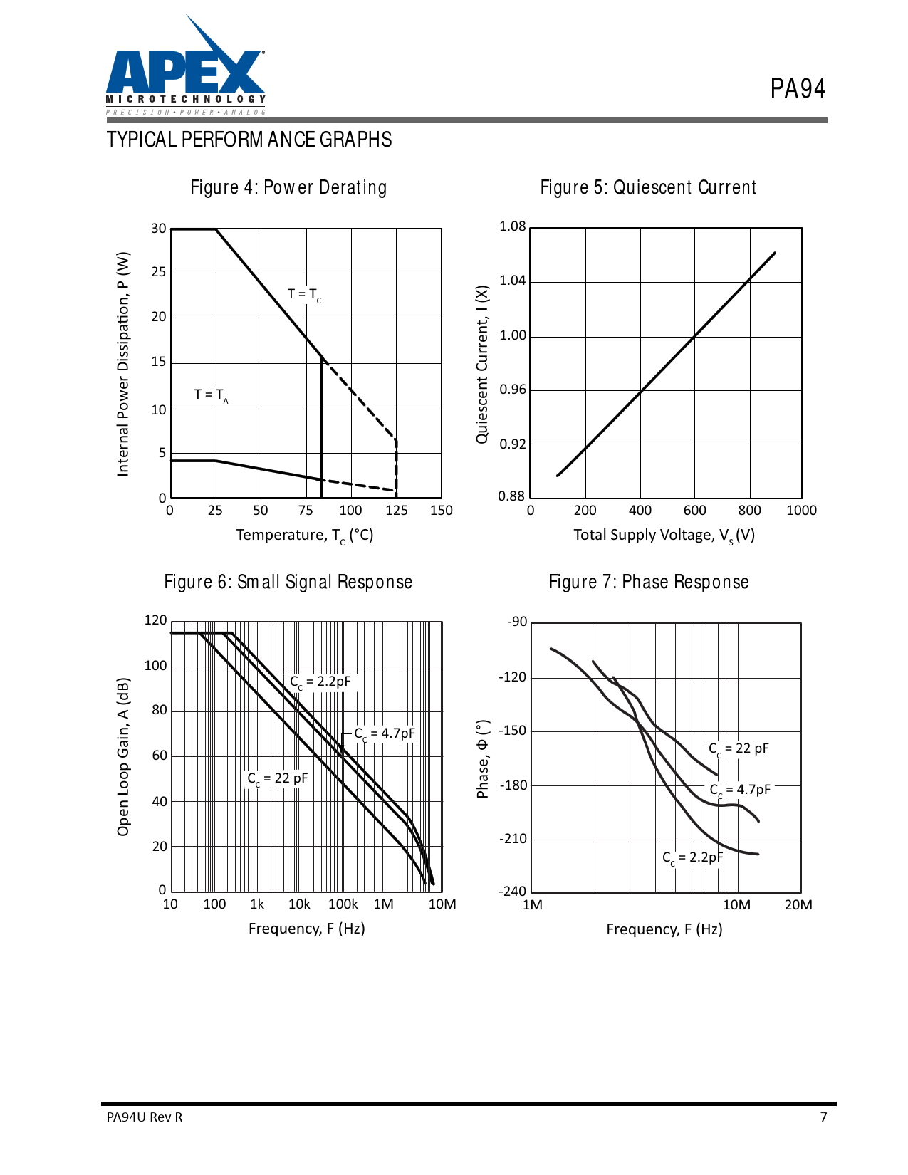

Pages / Page13 / 7 — PA94. TYPICAL PERFORMANCE GRAPHS. Figure 4: Power Derating. Figure 5: …
PA94. TYPICAL PERFORMANCE GRAPHS. Figure 4: Power Derating. Figure 5: Quiescent Current. Figure 6: Small Signal Response
PA94 TYPICAL PERFORMANCE GRAPHS Figure 4: Power Derating Figure 5: Quiescent Current Figure 6: Small Signal Response
30 1.08 ) 25 1.04 T = TC 20 1.00 15 T = T 0.96 A 10 Quiescent Current, I (X) 0.92 5 /ŶƚĞƌŶĂůWŽǁĞƌŝƐƐŝƉĂƟŽŶ͕W;t 0 0.88 0 25 50 75 100 125 150 0 200 400 600 800 1000 Temperature, T (°C) Total Supply Voltage, V (V) C S
Figure 6: Small Signal Response Figure 7: Phase Response
120 -90 100 C = 2.2pF -120 C 80 C = 4.7pF -150 C ˇ;ΣͿ C = 22 pF 60 C C = 22 pF C -180 Phase, C = 4.7pF 40 C Open Loop Gain, A (dB) -210 20 C = 2.2pF C 0 -240 10 100 1k 10k 100k 1M 10M 1M 10M 20M Frequency, F (Hz) Frequency, F (Hz) PA94U Rev R 7 Document Outline PA94 Features Applications Description Figure 1: Equivalent Schematic Typical connection Figure 2: Typical Connection Pinout and Description Table Figure 3: External Connections Specifications Absolute Maximum Ratings Input Gain Output Power Supply Thermal Typical Performance Graphs Safe Operating Area (SOA) Figure 12: SOA General Typical Application Figure 13: Typical Application Phase Compensation Internal Power Dissipation And Heatsink Selection Current Limit Common Mode Input Range Input Protection Figure 14: Overvoltage Protection Power Supply Protection Stability External Components Cautions Package Options Package Style DQ
