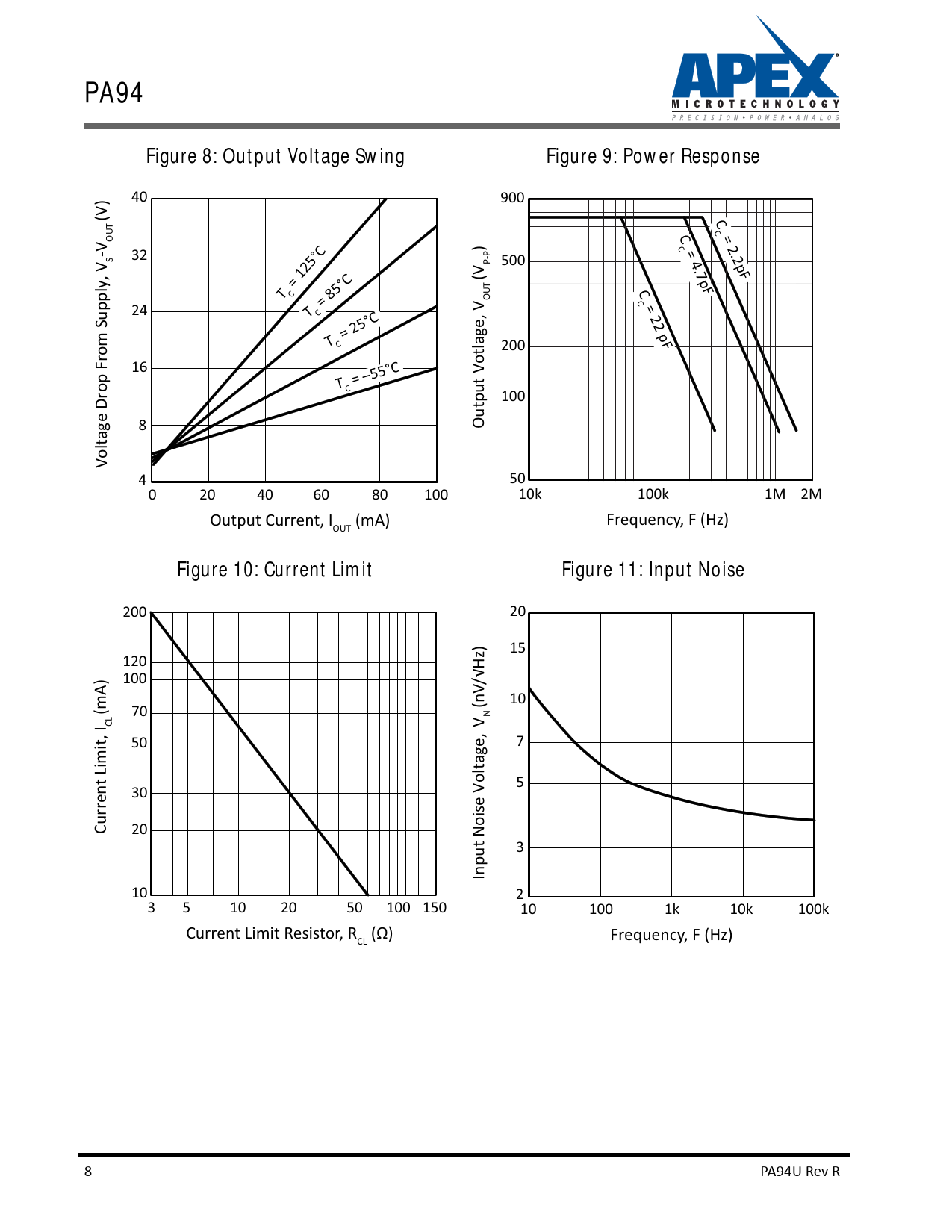

Pages / Page13 / 8 — PA94. Figure 8: Output Voltage Swing. Figure 9: Power Response. Figure …
PA94. Figure 8: Output Voltage Swing. Figure 9: Power Response. Figure 10: Current Limit. Figure 11: Input Noise
PA94 Figure 8: Output Voltage Swing Figure 9: Power Response Figure 10: Current Limit Figure 11: Input Noise
40 900 (V) C C C = 2.2pF OUT -V ) C = 4.7pF S 32 V P-P 500 (V = 125°C C T C OUT C = 22 pF 24 = 85°C V T C T = 25°C C 200 16 T = –55°C C 100 8 Output Votlage, Voltage Drop From Supply, 4 50 0 20 40 60 80 100 10k 100k 1M 2M Output Current, I (mA) Frequency, F (Hz) OUT
200 20 15 120 100 ͬя,njͿ 10 (mA) ;Ŷs 70 N CL V 50 7 5 30 Current Limit, I 20 3 Input Noise Voltage, 10 2 3 5 10 20 50 100 150 10 100 1k 10k 100k Current Limit Resistor, R (ɏ) Frequency, F (Hz) CL 8 PA94U Rev R Document Outline PA94 Features Applications Description Figure 1: Equivalent Schematic Typical connection Figure 2: Typical Connection Pinout and Description Table Figure 3: External Connections Specifications Absolute Maximum Ratings Input Gain Output Power Supply Thermal Typical Performance Graphs Safe Operating Area (SOA) Figure 12: SOA General Typical Application Figure 13: Typical Application Phase Compensation Internal Power Dissipation And Heatsink Selection Current Limit Common Mode Input Range Input Protection Figure 14: Overvoltage Protection Power Supply Protection Stability External Components Cautions Package Options Package Style DQ
