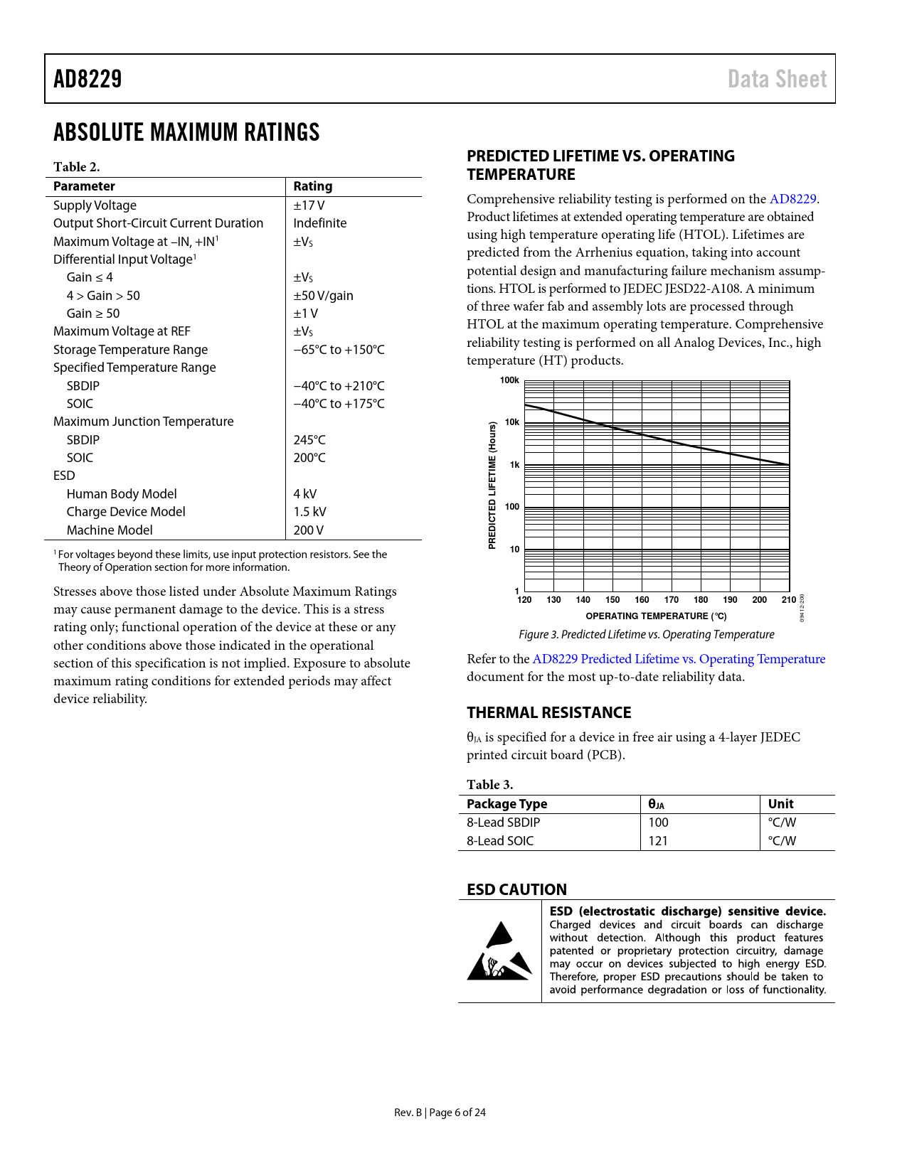

AD8229 Data Sheet ABSOLUTE MAXIMUM RATINGS PREDICTED LIFETIME VS. OPERATING Table 2. TEMPERATURE Parameter Rating
Supply Voltage ±17 V Comprehensive reliability testing is performed on the AD8229. Output Short-Circuit Current Duration Indefinite Product lifetimes at extended operating temperature are obtained Maximum Voltage at –IN, +IN1 ±V using high temperature operating life (HTOL). Lifetimes are S Differential Input Voltage1 predicted from the Arrhenius equation, taking into account Gain ≤ 4 ±V potential design and manufacturing failure mechanism assump- S 4 > Gain > 50 ±50 V/gain tions. HTOL is performed to JEDEC JESD22-A108. A minimum Gain ≥ 50 ±1 V of three wafer fab and assembly lots are processed through Maximum Voltage at REF ±V HTOL at the maximum operating temperature. Comprehensive S Storage Temperature Range −65°C to +150°C reliability testing is performed on all Analog Devices, Inc., high Specified Temperature Range temperature (HT) products. SBDIP −40°C to +210°C

SOIC −40°C to +175°C Maximum Junction Temperature

SBDIP 245°C

SOIC 200°C

Human Body Model 4 kV
LIFE D
Charge Device Model 1.5 kV
100 TE
Machine Model 200 V

1 For voltages beyond these limits, use input protection resistors. See the

Theory of Operation section for more information. Stresses above those listed under Absolute Maximum Ratings

rating only; functional operation of the device at these or any 09412- Figure 3. Predicted Lifetime vs. Operating Temperature other conditions above those indicated in the operational section of this specification is not implied. Exposure to absolute Refer to the AD8229 Predicted Lifetime vs. Operating Temperature maximum rating conditions for extended periods may affect document for the most up-to-date reliability data. device reliability.
THERMAL RESISTANCE
θJA is specified for a device in free air using a 4-layer JEDEC printed circuit board (PCB).
Table 3. Package Type θJA Unit
8-Lead SBDIP 100 °C/W 8-Lead SOIC 121 °C/W
