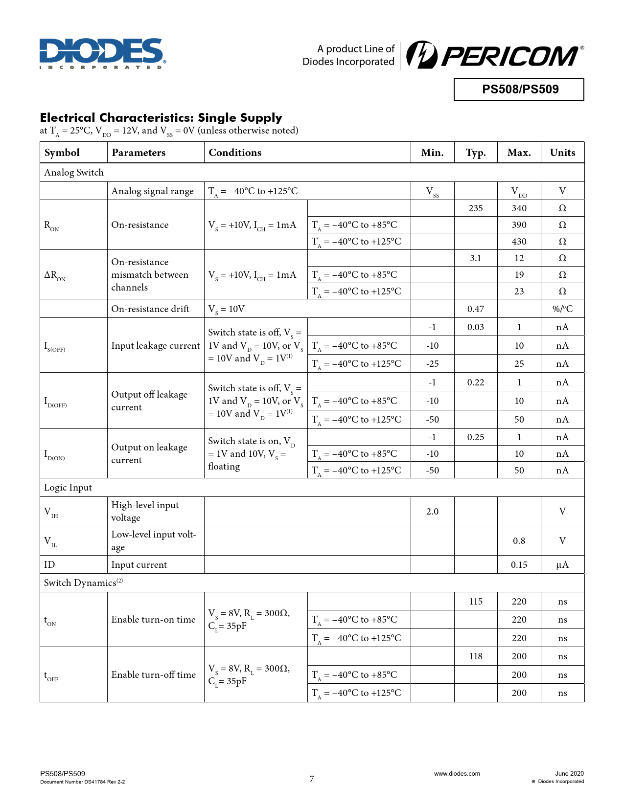

DescriptionPrecision 8-Channels, Differential 4-Channels, 36V Analog Multiplexers
Pages / Page15 / 7 — PS508/PS509. Electrical Characteristics: Single Supply. Symbol. …
PS508/PS509. Electrical Characteristics: Single Supply. Symbol. Parameters. Conditions. Min. Typ. Max. Units
PS508/PS509 Electrical Characteristics: Single Supply Symbol Parameters Conditions Min Typ Max Units
A product Line of Diodes Incorporated
at T = 25°C, V = 12V, and V = 0V (unless otherwise noted) A DD SS
Symbol Parameters Conditions Min. Typ. Max. Units
Analog Switch Analog signal range T = –40°C to +125°C V V V A SS DD 235 340 Ω R On-resistance V = +10V, I = 1mA T = –40°C to +85°C 390 Ω ON S CH A T = –40°C to +125°C 430 Ω A On-resistance 3.1 12 Ω ∆R mismatch between V = +10V, I = 1mA T = –40°C to +85°C 19 Ω ON S CH A channels T = –40°C to +125°C 23 Ω A On-resistance drift V = 10V 0.47 %/oC S Switch state is off, V = -1 0.03 1 nA S I Input leakage current 1V and V = 10V, or V T = –40°C to +85°C -10 10 nA S(OFF) D S A = 10V and V = 1V(1) D T = –40°C to +125°C -25 25 nA A Switch state is off, V = -1 0.22 1 nA S I Output off leakage 1V and V = 10V, or V T = –40°C to +85°C -10 10 nA D(OFF) current D S A = 10V and V = 1V(1) D T = –40°C to +125°C -50 50 nA A Switch state is on, V -1 0.25 1 nA D I Output on leakage = 1V and 10V, V = T = –40°C to +85°C -10 10 nA D(ON) current S A floating T = –40°C to +125°C -50 50 nA A Logic Input V High-level input IH voltage 2.0 V V Low-level input volt- IL age 0.8 V ID Input current 0.15 μA Switch Dynamics(2) 115 220 ns t Enable turn-on time V = 8V, R = 300Ω, S L T = –40°C to +85°C 220 ns ON C = 35pF A L T = –40°C to +125°C 220 ns A 118 200 ns t Enable turn-off time V = 8V, R = 300Ω, S L T = –40°C to +85°C 200 ns OFF C = 35pF A L T = –40°C to +125°C 200 ns A PS508/PS509 Document Number DS41784 Rev 2-2 7 www.diodes.com June 2020 Diodes Incorporated
