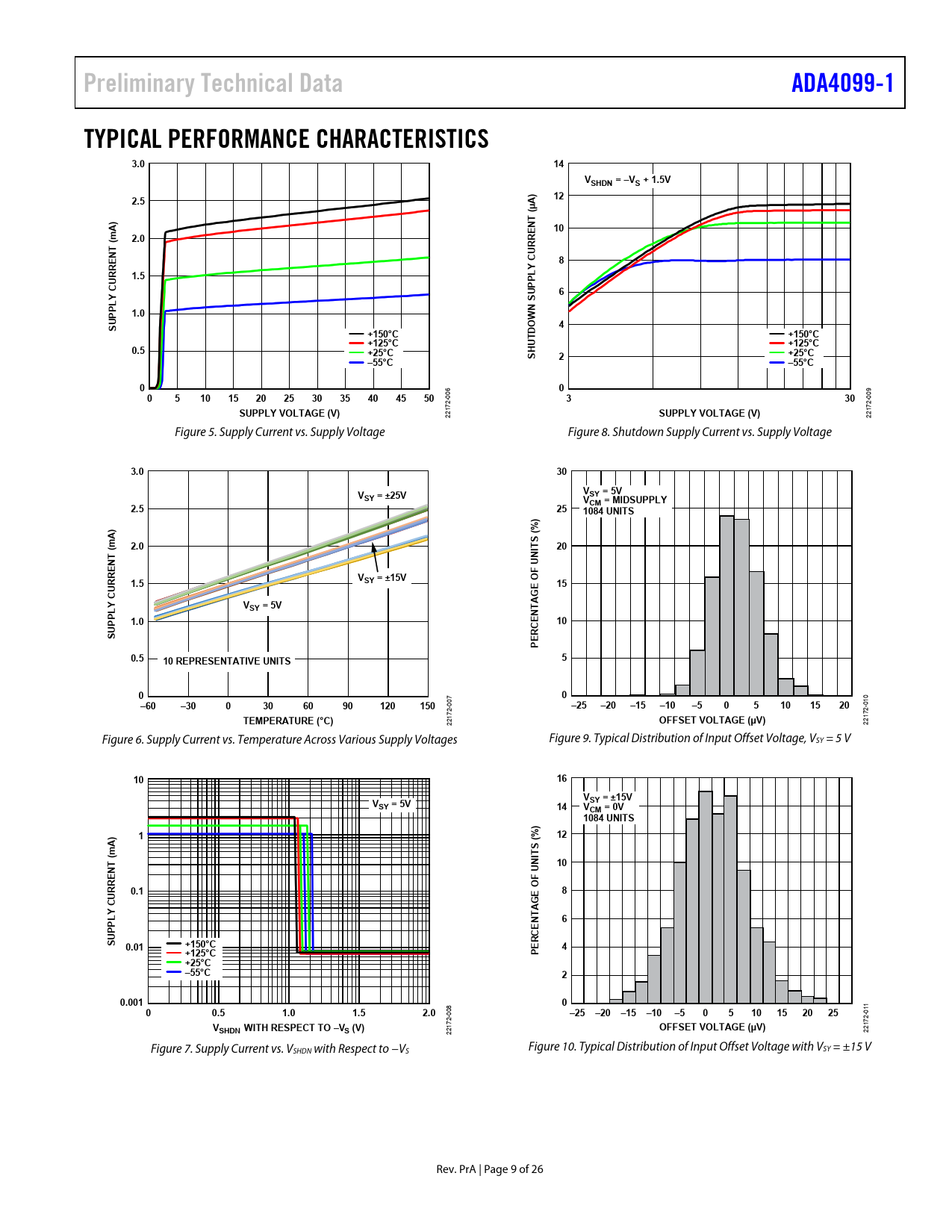

Preliminary Technical Data. ADA4099-1. TYPICAL PERFORMANCE CHARACTERISTICS. 3.0. VSHDN = –VS + 1.5V. 2.5. A (µ. 2.0. (m T. N E. 1.5. URR. P P
Preliminary Technical Data ADA4099-1 TYPICAL PERFORMANCE CHARACTERISTICS 3.0 VSHDN = –VS + 1.5V 2.5 A (µ 2.0 (m T N E 1.5 URR P P
Preliminary Technical Data ADA4099-1 TYPICAL PERFORMANCE CHARACTERISTICS 3.0 14 VSHDN = –VS + 1.5V ) 12 2.5 A (µ A) NT 10 E 2.0 (m T RR N E CU 8 Y 1.5 L URR P P C U Y 6 L S P N 1.0 W UP S O 4 +150°C D +150°C +125°C +125°C 0.5 +25°C HUT S 2 +25°C –55°C –55°C 0 0 0 5 10 15 20 25 30 35 40 45 50
006
3 30
009 72- 72-
SUPPLY VOLTAGE (V)
221
SUPPLY VOLTAGE (V)
221 Figure 5. Supply Current vs. Supply Voltage Figure 8. Shutdown Supply Current vs. Supply Voltage
3.0 30 V V SY = ±25V SY = 5V VCM = MIDSUPPLY 2.5 25 1084 UNITS ) (% A) S 2.0 (m IT 20 T N N E U F V O 1.5 SY = ±15V 15 URR E C G Y V A L SY = 5V T P 1.0 EN 10 UP C S R PE 0.5 10 REPRESENTATIVE UNITS 5 0 0
0
–60 –30 0 30 60 90 120 150
007
–25 –20 –15 –10 –5 0 5 10 15 20
01 2- 72-
TEMPERATURE (°C) OFFSET VOLTAGE (µV)
221 2217 Figure 6. Supply Current vs. Temperature Across Various Supply Voltages Figure 9. Typical Distribution of Input Offset Voltage, VSY = 5 V
10 16 V V SY = ±15V SY = 5V 14 VCM = 0V 1084 UNITS ) 1 12 (% S (mA) IT N 10 NT U F 0.1 O 8 E CURRE G Y A L T 6 P EN UP C S R 0.01 +150°C 4 +125°C PE +25°C –55°C 2 0.001 0
8
0 0.5 1.0 1.5 2.0
011 -00
–25 –20 –15 –10 –5 0 5 10 15 20 25
72-
V
172
SHDN WITH RESPECT TO –VS (V) OFFSET VOLTAGE (µV)
22 221 Figure 7. Supply Current vs. V Figure 10. Typical Distribution of Input Offset Voltage with V SHDN with Respect to −VS SY = ±15 V Rev. PrA | Page 9 of 26 Document Outline FEATURES APPLICATIONS GENERAL DESCRIPTION TYPICAL APPLICATION CIRCUIT TABLE OF CONTENTS SPECIFICATIONS 5 V SUPPLY ±15 V SUPPLY ABSOLUTE MAXIMUM RATINGS MAXIMUM POWER DISSIPATION THERMAL RESISTANCE ESD CAUTION PIN CONFIGURATION AND FUNCTION DESCRIPTIONS TYPICAL PERFORMANCE CHARACTERISTICS THEORY OF OPERATION INPUT PROTECTION OVER-THE-TOP OPERATION CONSIDERATIONS OUTPUT SHUTDOWN PIN (SHDN) APPLICATIONS INFORMATION LARGE RESISTOR GAIN OPERATION RECOMMENDED VALUES FOR VARIOUS GAINS NOISE DISTORTION POWER DISSIPATION AND THERMAL SHUTDOWN CIRCUIT LAYOUT CONSIDERATIONS POWER SUPPLY BYPASSING GROUNDING ESD PROTECTION WHEN POWERED RELATED PRODUCTS TYPICAL APPLICATIONS OUTLINE DIMENSIONS
