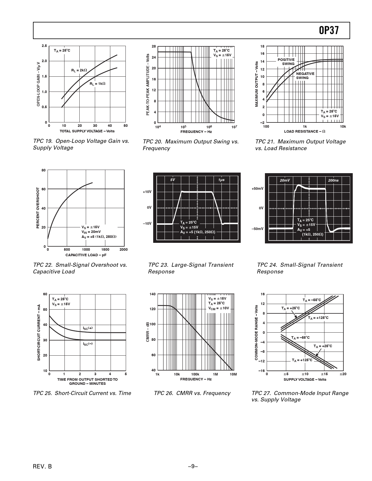

OP37. 2.5. TA = 25. C V. S =. 15V. olts 24. 2.0. POSITIVE. SWING. olts. V 12. L = 2k. NEGATIVE. 1.5. RL = 1k. 1.0. O-PEAK AMPLITUDE –. OPEN-LOOP GAIN – 0.5
OP37 2.5 TA = 25 C V S = 15V olts 24 2.0 POSITIVE SWING olts V 12 L = 2k NEGATIVE 1.5 RL = 1k 1.0 O-PEAK AMPLITUDE – OPEN-LOOP GAIN – 0.5
OP37 2.5 28 18 TA = 25 C TA = 25 C V 16 S = 15V olts 24 2.0 V 14 POSITIVE V SWING olts V/ 20 R V 12 L = 2k NEGATIVE 1.5 10 16 SWING RL = 1k 8 1.0 12 6 O-PEAK AMPLITUDE – 4 8 OPEN-LOOP GAIN – 0.5 MAXIMUM OUTPUT – 2 4 TA = 25 C PEAK-T 0 VS = 15V 0 0 –2 0 10 20 30 40 50 104 105 106 107 100 1k 10k TOTAL SUPPLY VOLTAGE – Volts FREQUENCY – Hz LOAD RESISTANCE –
TPC 19. Open-Loop Voltage Gain vs. TPC 20. Maximum Output Swing vs. TPC 21. Maximum Output Voltage Supply Voltage Frequency vs. Load Resistance
80 5V 1µs 20mV 200ns T 60 +50mV +10V VERSHOO 40 0V 0V TA = 25 C –10V TA = 25 C V PERCENT O 20 V S = 15V S = 15V VS = 15V –50mV A V V = +5 IN = 20mV AV = +5 (1k , 250 ) (1k , 250 ) AV = +5 (1k , 250 ) 0 0 500 1000 1500 2000 CAPACITIVE LOAD – pF
TPC 22. Small-Signal Overshoot vs. TPC 23. Large-Signal Transient TPC 24. Small-Signal Transient Capacitive Load Response Response
60 140 16 T V A = 25 C S = 15V TA = –55 C V T S = 15V A = 25 C 12 50 120 VCM = 10V T olts A = +25 C V 8 TA = +125 C 4 40 100 ISC(+) 0 T 30 A = –55 C CMRR – dB 80 I –4 SC(–) TA = +25 C T-CIRCUIT CURRENT – mA –8 20 60 SHOR COMMON-MODE RANGE – –12 TA = +125 C 10 40 –16 0 1 2 3 4 5 1k 10k 100k 1M 10M 0 5 10 15 20 TIME FROM OUTPUT SHORTED TO FREQUENCY – Hz SUPPLY VOLTAGE – Volts GROUND – MINUTES
TPC 25. Short-Circuit Current vs. Time TPC 26. CMRR vs. Frequency TPC 27. Common-Mode Input Range vs. Supply Voltage REV. B –9– Document Outline FEATURES GENERAL DESCRIPTION PIN CONNECTIONS SIMPLIFIED SCHEMATIC ABSOLUTE MAXIMUM RATINGS ORDERING GUIDE SPECIFICATIONS BINDING DIAGRAM Wafer Test Limits Typical Electrical Characteristics Typical Performance Characteristics APPLICATIONS INFORMATION Offset Voltage Adjustment Noise Measurements Optimizing Linearity Instrumentation Amplifier Comments on Noise Audio Applications OUTLINE DIMENSIONS Revision History
