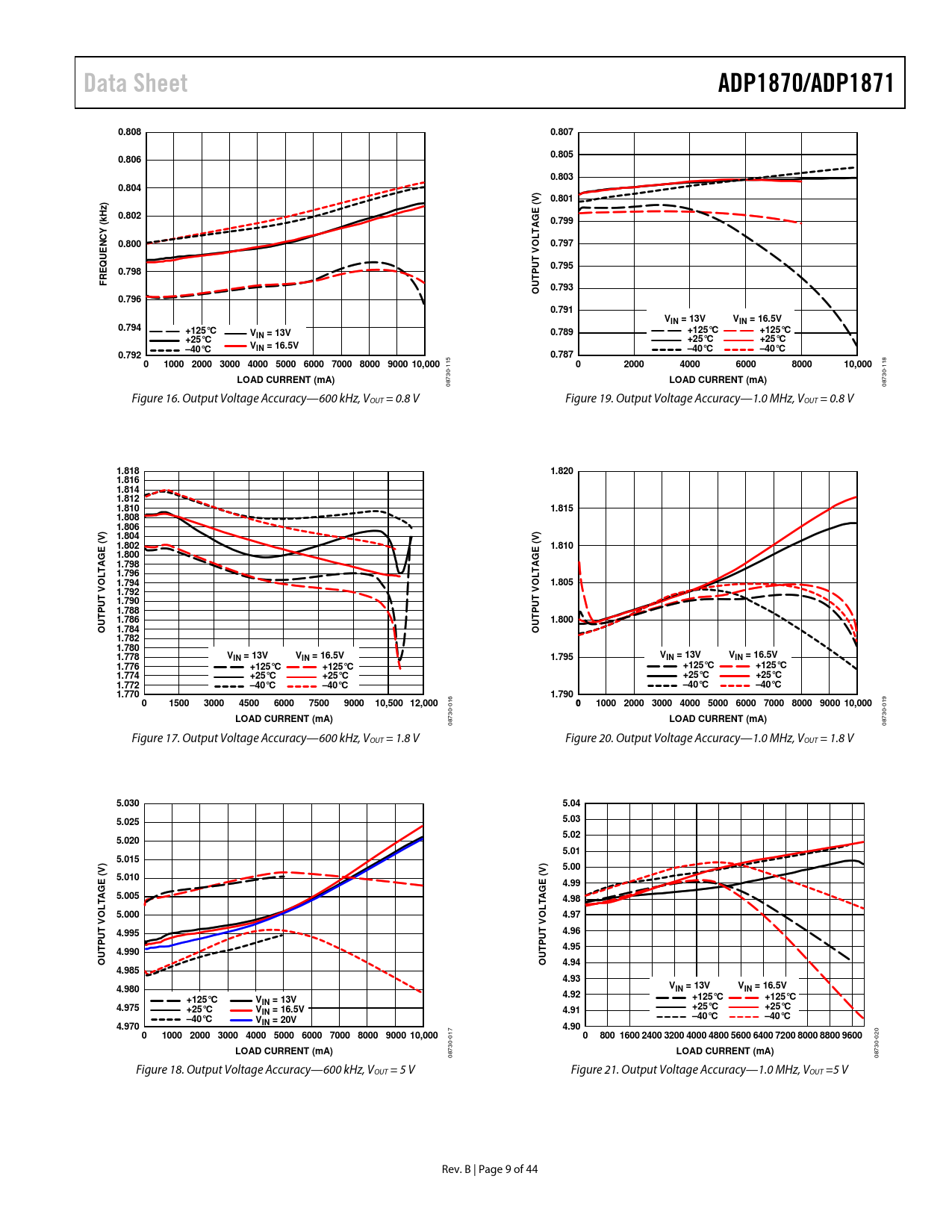

DescriptionSynchronous Buck Controller with Constant On-Time and Valley Current Mode
Pages / Page44 / 9 — Data Sheet. ADP1870/ADP1871. 0.808. 0.807. 0.805. 0.806. 0.803. 0.804. …
RevisionB
Data Sheet. ADP1870/ADP1871. 0.808. 0.807. 0.805. 0.806. 0.803. 0.804. 0.801. 0.802. 0.799. 0.800. 0.797. V T. 0.795. 0.798. 0.793. 0.796. 0.791. VIN = 13V
Data Sheet ADP1870/ADP1871 0.808 0.807 0.805 0.806 0.803 0.804 0.801 0.802 0.799 0.800 0.797 V T 0.795 0.798 0.793 0.796 0.791 VIN = 13V
Data Sheet ADP1870/ADP1871 0.808 0.807 0.805 0.806 0.803 0.804 ) ) V 0.801 ( Hz E 0.802 k G ( A 0.799 Y LT NC 0.800 O 0.797 UE V T Q U 0.795 E 0.798 R TP F OU 0.793 0.796 0.791 VIN = 13V VIN = 16.5V 0.794 +125°C V +125°C +125°C 0.789 +25°C IN = 13V +25°C +25°C –40°C VIN = 16.5V –40°C –40°C 0.792 0.787 0 1000 2000 3000 4000 5000 6000 7000 8000 9000 10,000

73 08 08 Figure 16. Output Voltage Accuracy—600 kHz, VOUT = 0.8 V Figure 19. Output Voltage Accuracy—1.0 MHz, VOUT = 0.8 V

73 08 08 Figure 17. Output Voltage Accuracy—600 kHz, VOUT = 1.8 V Figure 20. Output Voltage Accuracy—1.0 MHz, VOUT = 1.8 V

73 08 08 Figure 18. Output Voltage Accuracy—600 kHz, VOUT = 5 V Figure 21. Output Voltage Accuracy—1.0 MHz, VOUT =5 V Rev. B | Page 9 of 44 Document Outline Features Applications General Description Typical Applications Circuit Revision History Specifications Absolute Maximum Ratings Thermal Resistance Boundary Condition ESD Caution Pin Configuration and Function Descriptions Typical Performance Characteristics ADP1870/ADP1871 Block Diagram Theory of Operation Startup Soft Start Precision Enable Circuitry Undervoltage Lockout On-Board Low Dropout Regulator Thermal Shutdown Programming Resistor (RES) Detect Circuit Valley Current-Limit Setting Hiccup Mode During Short Circuit Synchronous Rectifier Power Saving Mode (PSM) Version (ADP1871) Timer Operation Pseudo-Fixed Frequency Applications Information Feedback Resistor Divider Inductor Selection Output Ripple Voltage (ΔVRR) Output Capacitor Selection Compensation Network Output Filter Impedance (ZFILT) Error Amplifier Output Impedance (ZCOMP) Error Amplifier Gain (GM) Current-Sense Loop Gain (GCS) Crossover Frequency Efficiency Considerations Channel Conduction Loss MOSFET Driver Loss Switching Loss Diode Conduction Loss Inductor Loss Input Capacitor Selection Thermal Considerations Design Example Input Capacitor Inductor Current Limit Programming Output Capacitor Feedback Resistor Network Setup Compensation Network Loss Calculations External Component Recommendations Layout Considerations IC Section (Left Side of Evaluation Board) Power Section Differential Sensing Typical Applications Circuits 15 A, 300 kHz High Current Application Circuit 5.5 V Input, 600 kHz Application Circuit 300 kHz High Current Application Circuit Outline Dimensions Ordering Guide
