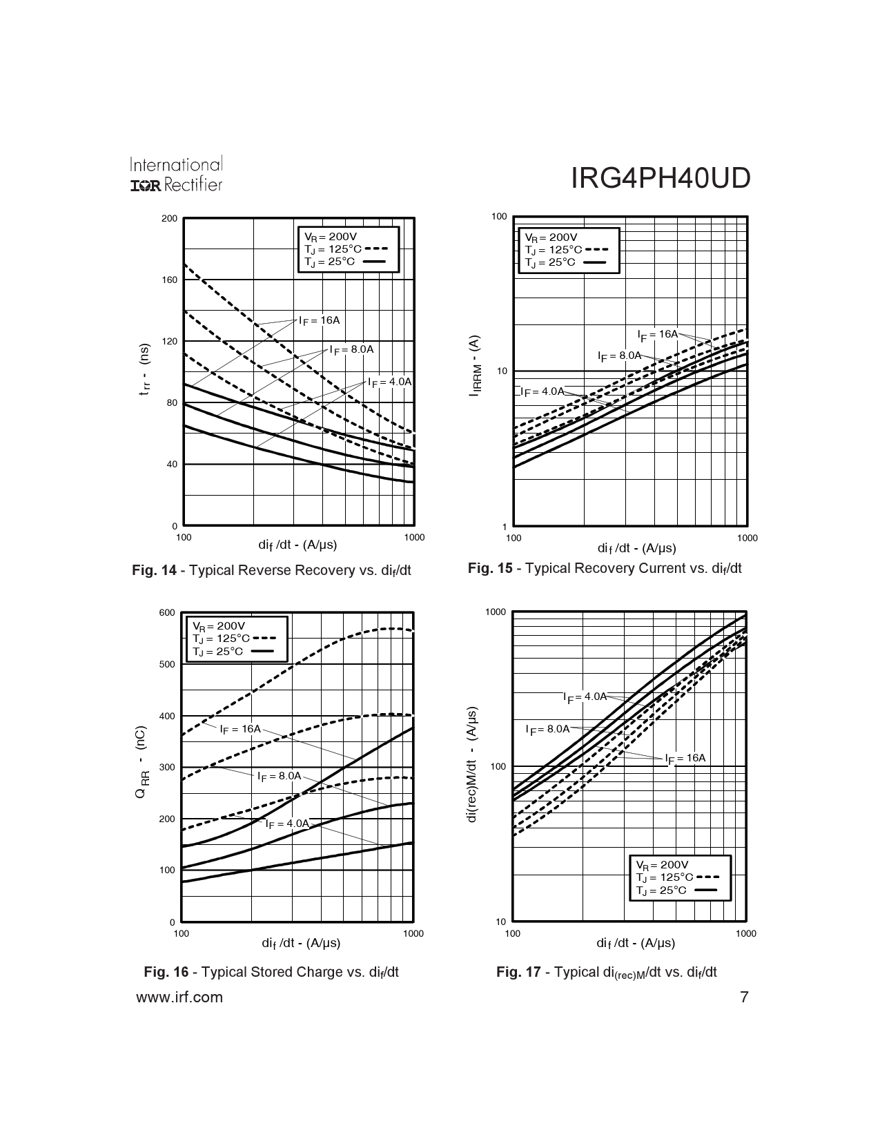

Fig. 14. Fig. 15. Fig. 16. Fig. 17
Fig 14 Fig 15 Fig 16 Fig 17
IRG4PH40UD 200 100 V R = 200V V R = 200V T = 12 J 5°C T = 12 J 5°C T = 25 J °C T = 25 J °C 160 I = F 16A ) I = 16A 120 F s) I = 8.0A F (A (n - I = 8.0A F - 10 I = 4.0A RM t rr F I IR I F = 4.0A 80 40 0 1 100 1000 di 100 1000 f /dt - (A/µs) dif /dt - (A/µs)
Fig. 14
- Typical Reverse Recovery vs. dif/dt
Fig. 15
- Typical Recovery Current vs. dif/dt 600 1000 V R = 200V T = 12 J 5°C T = 25 J °C 500 I = 4.0A F 400 s) /µ C I F = 16A I = 8.0A F n (A ( I = 16A - t - F 300 100 I = /d F 8.0A RR Q c)M e i(r 200 I = d F 4.0A V R = 200V 100 T = 12 J 5°C T = 25 J °C 0 10 100 1000 100 1000 dif /dt - (A/µs) dif /dt - (A/µs)
Fig. 16
- Typical Stored Charge vs. dif/dt
Fig. 17
- Typical di(rec)M/dt vs. dif/dt www.irf.com 7
