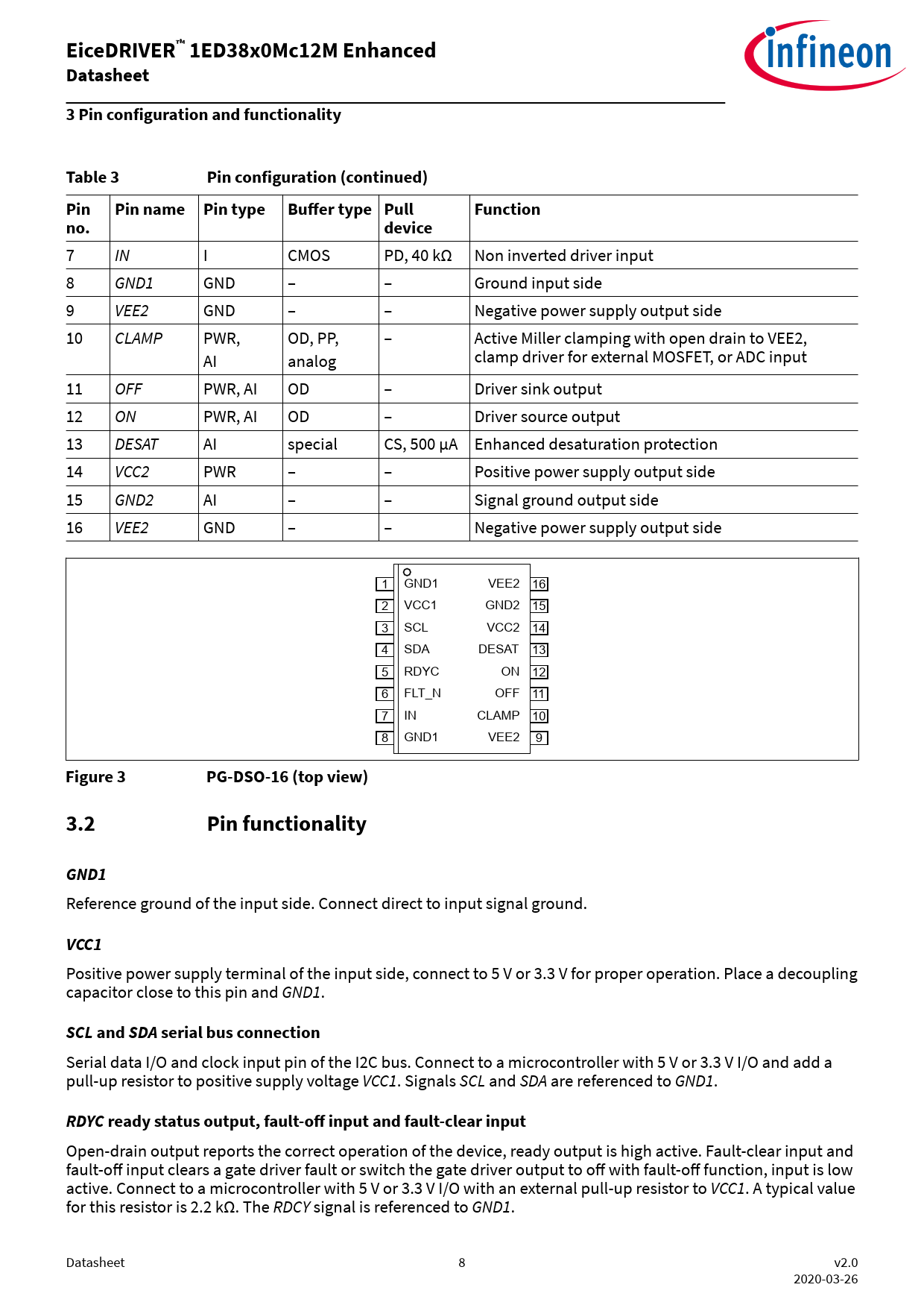

EiceDRIVER™ 1ED38x0Mc12M Enhanced. Datasheet. 3 Pin configuration and functionality. Table 3. Pin configuration (continued). Pin
EiceDRIVER™ 1ED38x0Mc12M Enhanced Datasheet 3 Pin configuration and functionality Table 3 Pin configuration (continued) Pin
EiceDRIVER™ 1ED38x0Mc12M Enhanced Datasheet 3 Pin configuration and functionality Table 3 Pin configuration (continued) Pin Pin name Pin type Buffer type Pull Function no. device
7 IN I CMOS PD, 40 kΩ Non inverted driver input 8 GND1 GND – – Ground input side 9 VEE2 GND – – Negative power supply output side 10 CLAMP PWR, OD, PP, – Active Miller clamping with open drain to VEE2, AI analog clamp driver for external MOSFET, or ADC input 11 OFF PWR, AI OD – Driver sink output 12 ON PWR, AI OD – Driver source output 13 DESAT AI special CS, 500 µA Enhanced desaturation protection 14 VCC2 PWR – – Positive power supply output side 15 GND2 AI – – Signal ground output side 16 VEE2 GND – – Negative power supply output side 1 GND1 VEE2 16 2 VCC1 GND2 15 3 SCL VCC2 14 4 SDA DESAT 13 5 RDYC ON 12 6 FLT_N OFF 11 7 IN CLAMP 10 8 GND1 VEE2 9
Figure 3 PG-DSO-16 (top view) 3.2 Pin functionality GND1
Reference ground of the input side. Connect direct to input signal ground.
VCC1
Positive power supply terminal of the input side, connect to 5 V or 3.3 V for proper operation. Place a decoupling capacitor close to this pin and GND1.
SCL and SDA serial bus connection
Serial data I/O and clock input pin of the I2C bus. Connect to a microcontroller with 5 V or 3.3 V I/O and add a pull-up resistor to positive supply voltage VCC1. Signals SCL and SDA are referenced to GND1.
RDYC ready status output, fault-off input and fault-clear input
Open-drain output reports the correct operation of the device, ready output is high active. Fault-clear input and fault-off input clears a gate driver fault or switch the gate driver output to off with fault-off function, input is low active. Connect to a microcontroller with 5 V or 3.3 V I/O with an external pull-up resistor to VCC1. A typical value for this resistor is 2.2 kΩ. The RDCY signal is referenced to GND1. Datasheet 8 v2.0 2020-03-26 Document Outline Table of contents 1 Block diagram 2 Related products 3 Pin configuration and functionality 3.1 Pin configuration 3.2 Pin functionality 3.3 Configurable parameters via I2C 4 Functional description 4.1 Start-up and fault clearing 4.2 Supply 4.3 Input side logic 4.4 I2C bus 4.5 Operating states 4.6 Measurement 4.7 Monitoring 4.8 Desaturation protection 4.8.1 DESAT behavior 4.9 Gate driver output 4.9.1 Turn-on behavior 4.9.2 Turn-off and fault turn-off behavior 4.9.2.1 Hard switching turn-off 4.9.2.2 Two-level turn-off 4.9.2.3 Soft turn-off 4.9.3 Active shut-down 4.9.4 Active Miller clamp 4.10 Short circuit clamping 5 Electrical parameters 5.1 Absolute maximum ratings 5.2 Thermal parameters 5.3 Operating parameters 5.4 Electrical characteristics 5.4.1 Voltage supply 5.4.2 Logic input and output 5.4.3 Gate driver 5.4.4 Active Miller clamp 5.4.5 Dynamic characteristics 5.4.6 Desaturation protection 5.4.7 Two-level turn-off 5.4.8 Soft-off current source 5.4.9 Over-temperature protection 5.4.10 ADC measurement 6 Insulation characteristics 6.1 Certified according to VDE 0884-11 and IEC 60747-17 reinforced insulation (planned) 6.2 Recognized under UL 1577 (planned) 7 Package information Revision history Disclaimer
