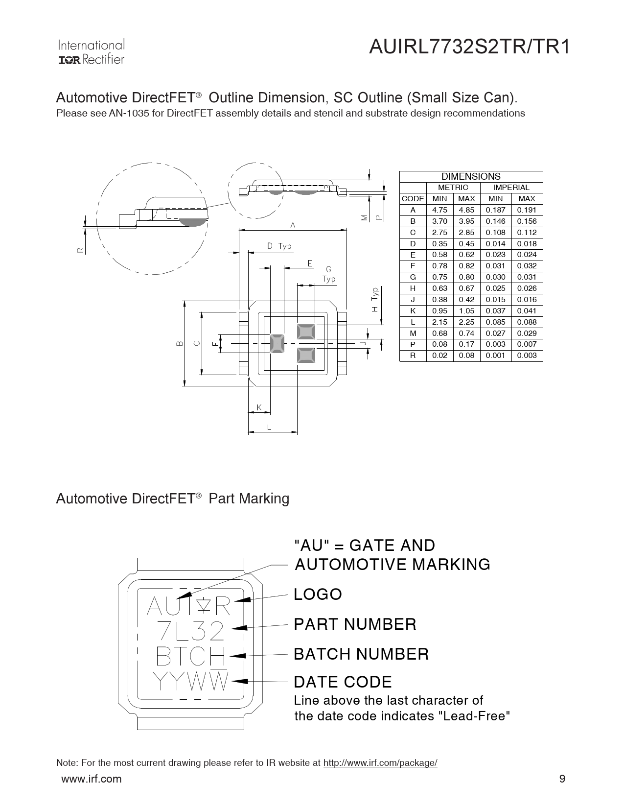

AUIRL7732S2TR/TR1. Automotive. DirectFET®. Outline. Dimension,. SC. Outline. (Small. Size. Can). Please. see. AN-1035. for. DirectFET. assembly
AUIRL7732S2TR/TR1 Automotive DirectFET® Outline Dimension, SC Outline (Small Size Can) Please see AN-1035 for DirectFET assembly
AUIRL7732S2TR/TR1 Automotive DirectFET® Outline Dimension, SC Outline (Small Size Can). Please see AN-1035 for DirectFET assembly details and stencil and substrate design recommendations DIMENSIONS METRIC IMPERIAL CODE MIN MAX MIN MAX A 4.75 4.85 0.187 0.191 B 3.70 3.95 0.146 0.156 C 2.75 2.85 0.108 0.112 D 0.35 0.45 0.014 0.018 E 0.58 0.62 0.023 0.024 F 0.78 0.82 0.031 0.032 G 0.75 0.80 0.030 0.031 H 0.63 0.67 0.025 0.026 J 0.38 0.42 0.015 0.016 K 0.95 1.05 0.037 0.041 L 2.15 2.25 0.085 0.088 M 0.68 0.74 0.027 0.029 P 0.08 0.17 0.003 0.007 R 0.02 0.08 0.001 0.003 Automotive DirectFET® Part Marking "AU" = GATE AND AUTOMOTIVE MARKING LOGO PART NUMBER BATCH NUMBER DATE CODE Line above the last character of the date code indicates "Lead-Free" Note: For the most current drawing please refer to IR website at http://www.irf.com/package/ www.irf.com 9
