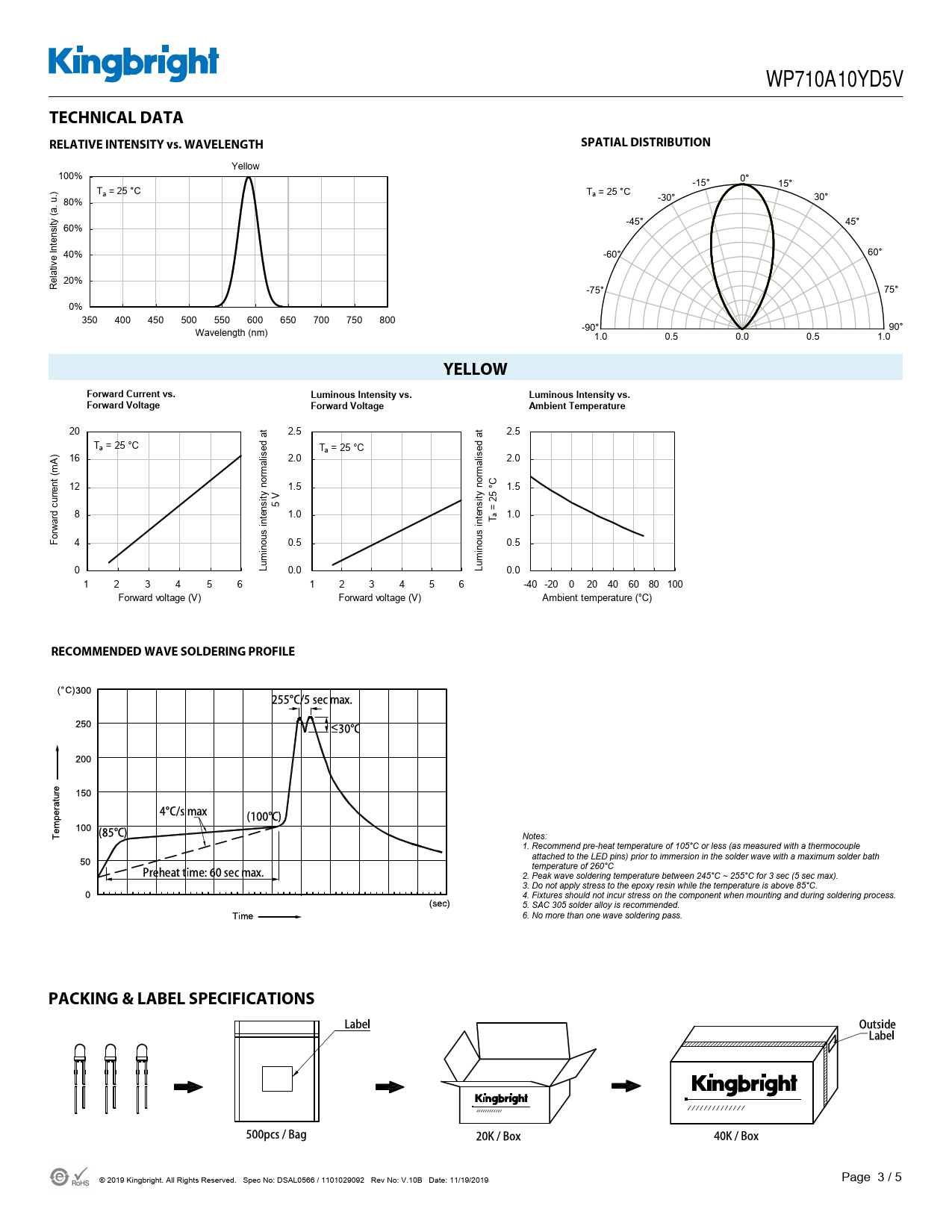

WP710A10YD5V. TECHNICAL DATA. RELATIVE INTENSITY vs. WAVELENGTH. SPATIAL DISTRIBUTION. YELLOW. Forward Current vs
![WP710A10YD5V TECHNICAL DATA RELATIVE INTENSITY vs WAVELENGTH SPATIAL DISTRIBUTION YELLOW Forward Current vs](https://www.rlocman.ru/datasheet/img.php?di=171417&p=2)
WP710A10YD5V TECHNICAL DATA RELATIVE INTENSITY vs. WAVELENGTH SPATIAL DISTRIBUTION
Yellow 100% -15° 0° 15° T .) a = 25 °C Ta = 25 °C -30° 30° 80% a. u -45° 45° sity ( 60% n te 40% -60° 60° tive In la 20% Re -75° 75° 0% 350 400 450 500 550 600 650 700 750 800 -90° 90° Wavelength (nm) 1.0 0.5 0.0 0.5 1.0
YELLOW Forward Current vs. Luminous Intensity vs. Luminous Intensity vs. Forward Voltage Forward Voltage Ambient Temperature
20 2.5 2.5 Ta = 25 °C T ) a = 25 °C 16 A 2.0 alised at 2.0 alised at m m C ent (m 12 1.5 1.5 5 ° urr ity nor ity nor 5 V = 2 rd c 8 1.0 1.0 Ta orwa s intens s intens F 4 0.5 0.5 inou inou 0 Lum 0.0 Lum 0.0 1 2 3 4 5 6 1 2 3 4 5 6 -40 -20 0 20 40 60 80 100 Forward voltage (V) Forward voltage (V) Ambient temperature (°C)
RECOMMENDED WAVE SOLDERING PROFILE
Notes: 1. Recommend pre-heat temperature of 105°C or less (as measured with a thermocouple attached to the LED pins) prior to immersion in the solder wave with a maximum solder bath temperature of 260°C 2. Peak wave soldering temperature between 245°C ~ 255°C for 3 sec (5 sec max). 3. Do not apply stress to the epoxy resin while the temperature is above 85°C. 4. Fixtures should not incur stress on the component when mounting and during soldering process. 5. SAC 305 solder alloy is recommended. 6. No more than one wave soldering pass.
