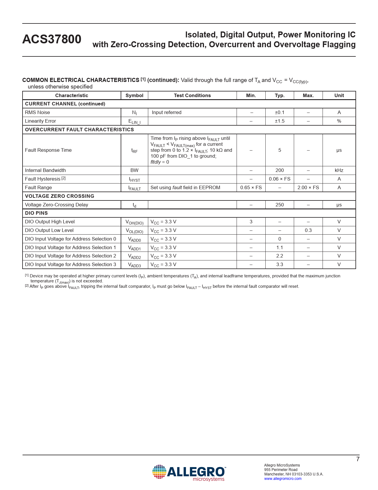

Isolated, Digital Output, Power Monitoring IC ACS37800 with Zero-Crossing Detection, Overcurrent and Overvoltage Flagging COMMON ELECTRICAL CHARACTERISTICS [1] (continued):
Valid through the full range of TA and VCC = VCC(typ), unless otherwise specified
Characteristic Symbol Test Conditions Min. Typ. Max. Unit CURRENT CHANNEL (continued)
RMS Noise NI Input referred – ±0.1 – A Linearity Error ELIN_I – ±1.5 – %
OVERCURRENT FAULT CHARACTERISTICS
Time from IP rising above IFAULT until VFAULT < VFAULT(max) for a current Fault Response Time tRF step from 0 to 1.2 × IFAULT; 10 kΩ and – 5 – μs 100 pF from DIO_1 to ground; fltdly = 0 Internal Bandwidth BW – 200 – kHz Fault Hysteresis [2] IHYST – 0.06 × FS – A Fault Range IFAULT Set using fault field in EEPROM 0.65 × FS – 2.00 × FS A
VOLTAGE ZERO CROSSING
Voltage Zero-Crossing Delay td – 250 – µs
