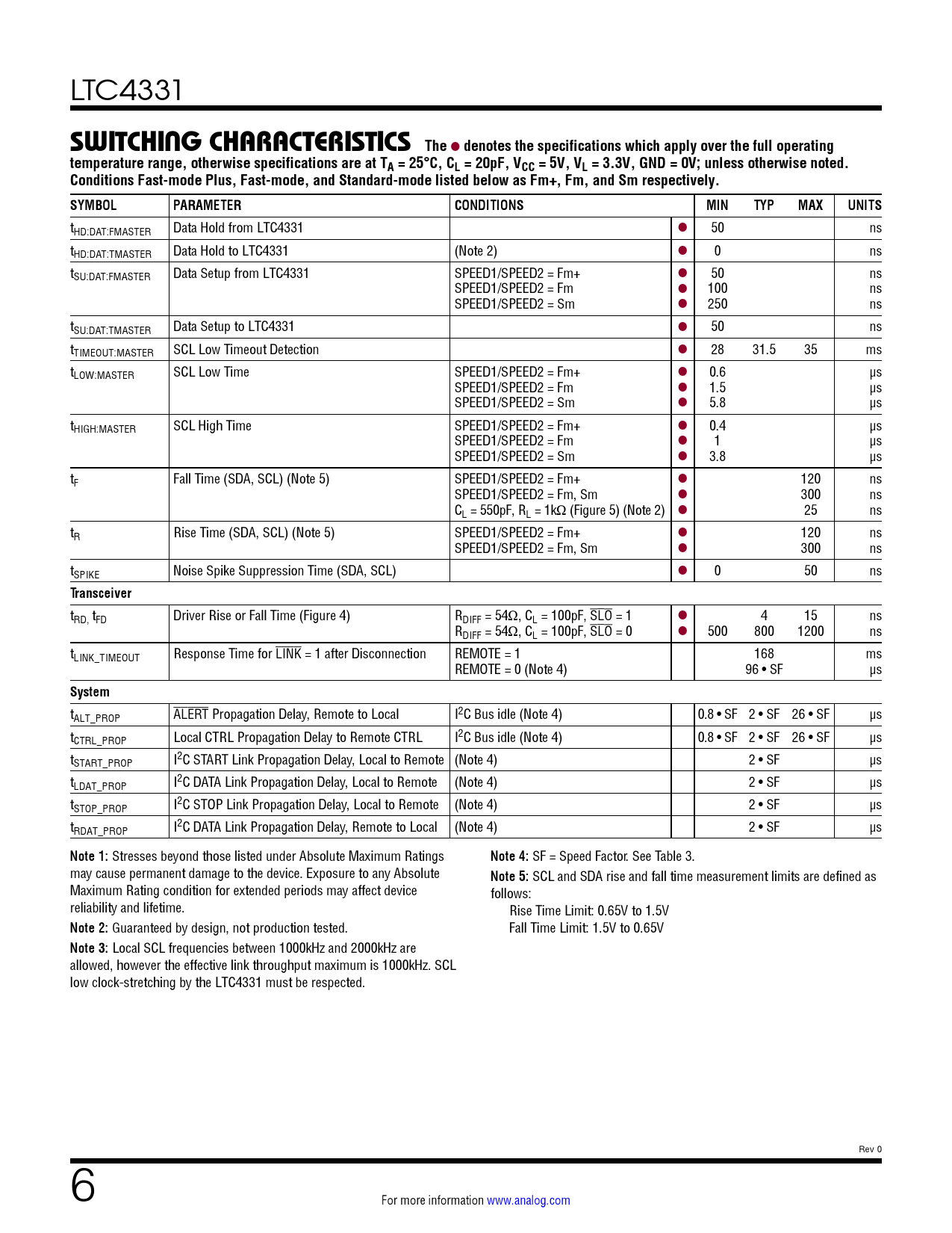

LTC4331 SWITCHING CHARACTERISTICS
The
l
denotes the specifications which apply over the full operating temperature range, otherwise specifications are at TA = 25°C, CL = 20pF, VCC = 5V, VL = 3.3V, GND = 0V; unless otherwise noted. Conditions Fast-mode Plus, Fast-mode, and Standard-mode listed below as Fm+, Fm, and Sm respectively. SYMBOL PARAMETER CONDITIONS MIN TYP MAX UNITS
tHD:DAT:FMASTER Data Hold from LTC4331 l 50 ns tHD:DAT:TMASTER Data Hold to LTC4331 (Note 2) l 0 ns tSU:DAT:FMASTER Data Setup from LTC4331 SPEED1/SPEED2 = Fm+ l 50 ns SPEED1/SPEED2 = Fm l 100 ns SPEED1/SPEED2 = Sm l 250 ns tSU:DAT:TMASTER Data Setup to LTC4331 l 50 ns tTIMEOUT:MASTER SCL Low Timeout Detection l 28 31.5 35 ms tLOW:MASTER SCL Low Time SPEED1/SPEED2 = Fm+ l 0.6 µs SPEED1/SPEED2 = Fm l 1.5 µs SPEED1/SPEED2 = Sm l 5.8 µs tHIGH:MASTER SCL High Time SPEED1/SPEED2 = Fm+ l 0.4 µs SPEED1/SPEED2 = Fm l 1 µs SPEED1/SPEED2 = Sm l 3.8 µs tF Fall Time (SDA, SCL) (Note 5) SPEED1/SPEED2 = Fm+ l 120 ns SPEED1/SPEED2 = Fm, Sm l 300 ns CL = 550pF, RL = 1kΩ (Figure 5) (Note 2) l 25 ns tR Rise Time (SDA, SCL) (Note 5) SPEED1/SPEED2 = Fm+ l 120 ns SPEED1/SPEED2 = Fm, Sm l 300 ns tSPIKE Noise Spike Suppression Time (SDA, SCL) l 0 50 ns
Transceiver
tRD, tFD Driver Rise or Fall Time (Figure 4) RDIFF = 54Ω, CL = 100pF, SLO = 1 l 4 15 ns RDIFF = 54Ω, CL = 100pF, SLO = 0 l 500 800 1200 ns tLINK_TIMEOUT Response Time for LINK = 1 after Disconnection REMOTE = 1 168 ms REMOTE = 0 (Note 4) 96 • SF µs
System
tALT_PROP ALERT Propagation Delay, Remote to Local I2C Bus idle (Note 4) 0.8 • SF 2 • SF 26 • SF µs tCTRL_PROP Local CTRL Propagation Delay to Remote CTRL I2C Bus idle (Note 4) 0.8 • SF 2 • SF 26 • SF µs tSTART_PROP I2C START Link Propagation Delay, Local to Remote (Note 4) 2 • SF µs tLDAT_PROP I2C DATA Link Propagation Delay, Local to Remote (Note 4) 2 • SF µs tSTOP_PROP I2C STOP Link Propagation Delay, Local to Remote (Note 4) 2 • SF µs tRDAT_PROP I2C DATA Link Propagation Delay, Remote to Local (Note 4) 2 • SF µs
Note 1:
Note 4:
SF = Speed Factor. See Table 3. may cause permanent damage to the device. Exposure to any Absolute
Note 5:
SCL and SDA rise and fall time measurement limits are defined as Maximum Rating condition for extended periods may affect device follows: reliability and lifetime. Rise Time Limit: 0.65V to 1.5V
Note 2:
Guaranteed by design, not production tested. Fall Time Limit: 1.5V to 0.65V
