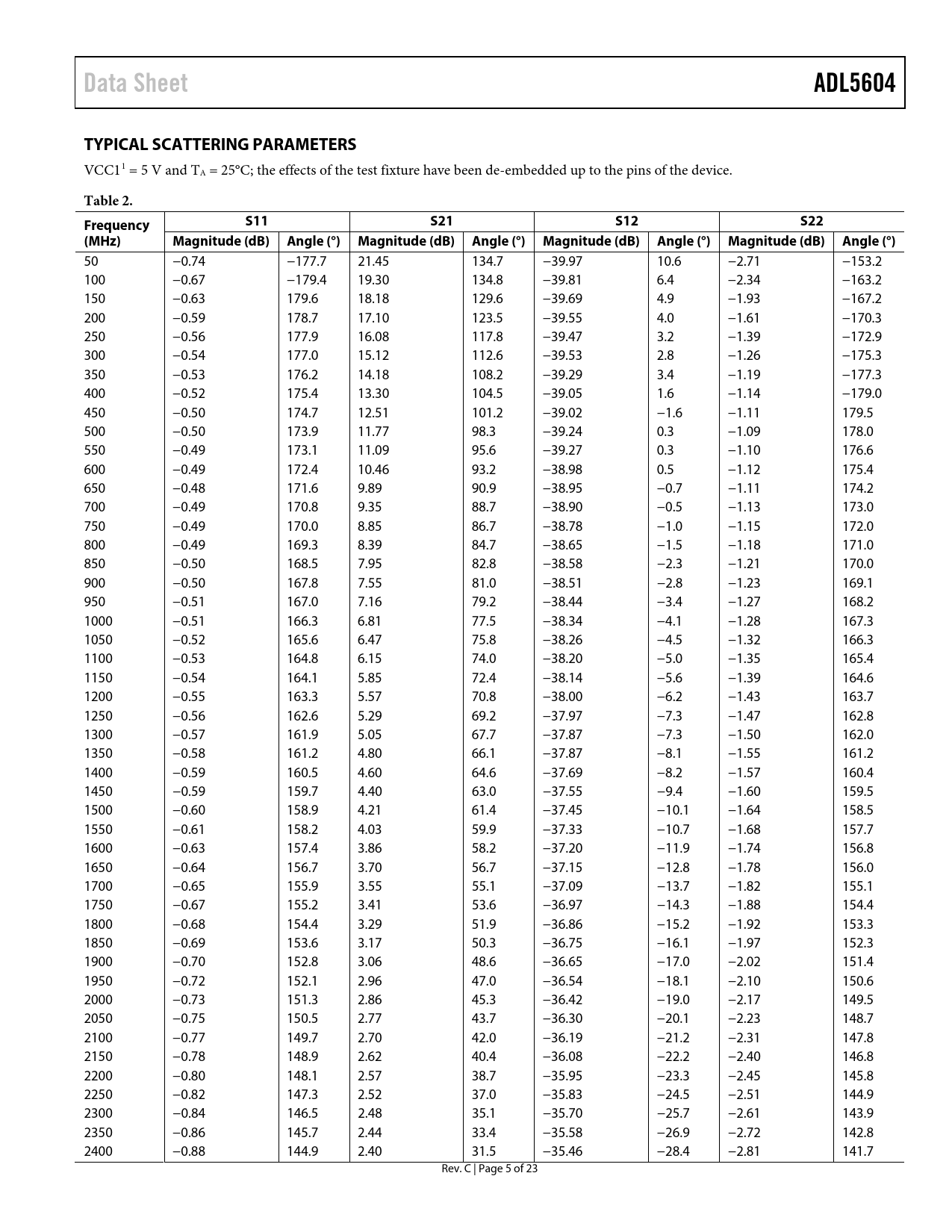

Data Sheet. ADL5604. TYPICAL SCATTERING PARAMETERS. Table 2. Frequency. S11. S21. S12. S22. (MHz)
Data Sheet ADL5604 TYPICAL SCATTERING PARAMETERS Table 2 Frequency S11 S21 S12 S22 (MHz)
link to page 6
VCC11 = 5 V and TA = 25°C; the effects of the test fixture have been de-embedded up to the pins of the device.
Table 2. Frequency S11 S21 S12 S22 (MHz) Magnitude (dB) Angle (°) Magnitude (dB) Angle (°) Magnitude (dB) Angle (°) Magnitude (dB) Angle (°)
50 −0.74 −177.7 21.45 134.7 −39.97 10.6 −2.71 −153.2 100 −0.67 −179.4 19.30 134.8 −39.81 6.4 −2.34 −163.2 150 −0.63 179.6 18.18 129.6 −39.69 4.9 −1.93 −167.2 200 −0.59 178.7 17.10 123.5 −39.55 4.0 −1.61 −170.3 250 −0.56 177.9 16.08 117.8 −39.47 3.2 −1.39 −172.9 300 −0.54 177.0 15.12 112.6 −39.53 2.8 −1.26 −175.3 350 −0.53 176.2 14.18 108.2 −39.29 3.4 −1.19 −177.3 400 −0.52 175.4 13.30 104.5 −39.05 1.6 −1.14 −179.0 450 −0.50 174.7 12.51 101.2 −39.02 −1.6 −1.11 179.5 500 −0.50 173.9 11.77 98.3 −39.24 0.3 −1.09 178.0 550 −0.49 173.1 11.09 95.6 −39.27 0.3 −1.10 176.6 600 −0.49 172.4 10.46 93.2 −38.98 0.5 −1.12 175.4 650 −0.48 171.6 9.89 90.9 −38.95 −0.7 −1.11 174.2 700 −0.49 170.8 9.35 88.7 −38.90 −0.5 −1.13 173.0 750 −0.49 170.0 8.85 86.7 −38.78 −1.0 −1.15 172.0 800 −0.49 169.3 8.39 84.7 −38.65 −1.5 −1.18 171.0 850 −0.50 168.5 7.95 82.8 −38.58 −2.3 −1.21 170.0 900 −0.50 167.8 7.55 81.0 −38.51 −2.8 −1.23 169.1 950 −0.51 167.0 7.16 79.2 −38.44 −3.4 −1.27 168.2 1000 −0.51 166.3 6.81 77.5 −38.34 −4.1 −1.28 167.3 1050 −0.52 165.6 6.47 75.8 −38.26 −4.5 −1.32 166.3 1100 −0.53 164.8 6.15 74.0 −38.20 −5.0 −1.35 165.4 1150 −0.54 164.1 5.85 72.4 −38.14 −5.6 −1.39 164.6 1200 −0.55 163.3 5.57 70.8 −38.00 −6.2 −1.43 163.7 1250 −0.56 162.6 5.29 69.2 −37.97 −7.3 −1.47 162.8 1300 −0.57 161.9 5.05 67.7 −37.87 −7.3 −1.50 162.0 1350 −0.58 161.2 4.80 66.1 −37.87 −8.1 −1.55 161.2 1400 −0.59 160.5 4.60 64.6 −37.69 −8.2 −1.57 160.4 1450 −0.59 159.7 4.40 63.0 −37.55 −9.4 −1.60 159.5 1500 −0.60 158.9 4.21 61.4 −37.45 −10.1 −1.64 158.5 1550 −0.61 158.2 4.03 59.9 −37.33 −10.7 −1.68 157.7 1600 −0.63 157.4 3.86 58.2 −37.20 −11.9 −1.74 156.8 1650 −0.64 156.7 3.70 56.7 −37.15 −12.8 −1.78 156.0 1700 −0.65 155.9 3.55 55.1 −37.09 −13.7 −1.82 155.1 1750 −0.67 155.2 3.41 53.6 −36.97 −14.3 −1.88 154.4 1800 −0.68 154.4 3.29 51.9 −36.86 −15.2 −1.92 153.3 1850 −0.69 153.6 3.17 50.3 −36.75 −16.1 −1.97 152.3 1900 −0.70 152.8 3.06 48.6 −36.65 −17.0 −2.02 151.4 1950 −0.72 152.1 2.96 47.0 −36.54 −18.1 −2.10 150.6 2000 −0.73 151.3 2.86 45.3 −36.42 −19.0 −2.17 149.5 2050 −0.75 150.5 2.77 43.7 −36.30 −20.1 −2.23 148.7 2100 −0.77 149.7 2.70 42.0 −36.19 −21.2 −2.31 147.8 2150 −0.78 148.9 2.62 40.4 −36.08 −22.2 −2.40 146.8 2200 −0.80 148.1 2.57 38.7 −35.95 −23.3 −2.45 145.8 2250 −0.82 147.3 2.52 37.0 −35.83 −24.5 −2.51 144.9 2300 −0.84 146.5 2.48 35.1 −35.70 −25.7 −2.61 143.9 2350 −0.86 145.7 2.44 33.4 −35.58 −26.9 −2.72 142.8 2400 −0.88 144.9 2.40 31.5 −35.46 −28.4 −2.81 141.7 Rev. C | Page 5 of 23 Document Outline Features Functional Block Diagram General Description Table of Contents Revision History Specifications Typical Scattering Parameters Absolute Maximum Ratings ESD Caution Pin Configuration and Function Descriptions Typical Performance Characteristics Applications Information Basic Layout Connections Power Supply RF Input Interface RF Output Interface Power-Down Circuit ADL5604 Match ACPR and EVM Thermal Considerations Soldering Information and Recommended PCB Land Pattern Evaluation Board Outline Dimensions Ordering Guide
