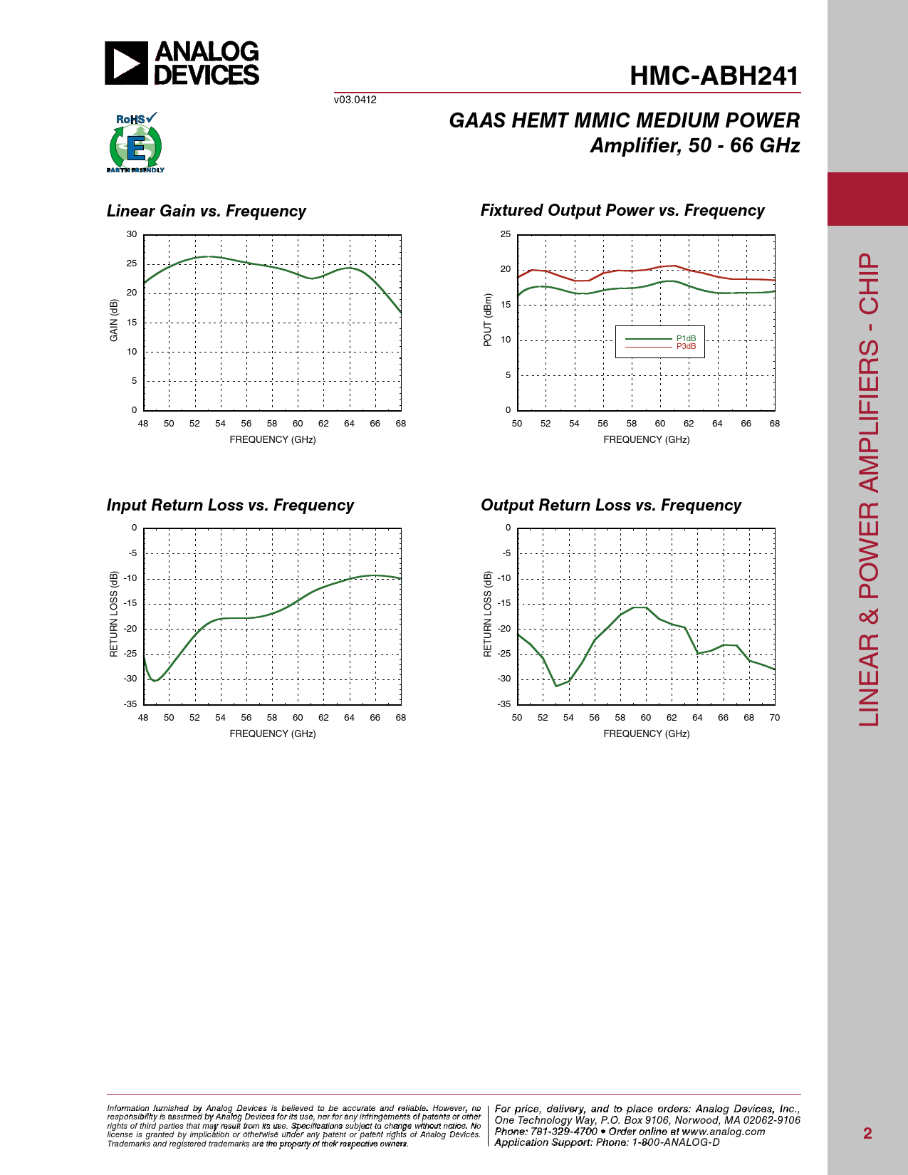

DescriptionGaAs HEMT MMIC MEDIUM POWER Amplifier, 50 - 66 GHz
Pages / Page6 / 2 — HMC-ABH241. Gaas HEMT MMIC MEDIUM POWER. amplifier, 50 - 66 GHz. Linear …
File Format / SizePDF / 390 Kb
HMC-ABH241. Gaas HEMT MMIC MEDIUM POWER. amplifier, 50 - 66 GHz. Linear Gain vs. Frequency. Fixtured Output Power vs. Frequency
HMC-ABH241 Gaas HEMT MMIC MEDIUM POWER amplifier, 50 - 66 GHz Linear Gain vs Frequency Fixtured Output Power vs Frequency
HMC-ABH241
v03.0412
Gaas HEMT MMIC MEDIUM POWER amplifier, 50 - 66 GHz Linear Gain vs. Frequency Fixtured Output Power vs. Frequency
30 25 25 20 iP 20 H 15 (dB) (dBm) 15 GAIN 10 P1dB POUT 10 P3dB s - C 5 r 5 ie 0 0 48 50 52 54 56 58 60 62 64 66 68 50 52 54 56 58 60 62 64 66 68 Lif FREQUENCY (GHz) FREQUENCY (GHz) P m a
Input Return Loss vs. Frequency Output Return Loss vs. Frequency
r 0 0 e -5 -5 w -10 -10 (dB) (dB) o -15 -15 LOSS LOSS -20 -20 RETURN -25 RETURN -25 r & P a -30 -30 e -35 -35 48 50 52 54 56 58 60 62 64 66 68 50 52 54 56 58 60 62 64 66 68 70 Lin FREQUENCY (GHz) FREQUENCY (GHz) Inf F or o m r p atio r n ifc ur e n , d ishe e d lbiv y e A r n y a alog n D d t evic o p es is la beclie o eved rd to ebre sa: H ccur iattti e tae M nd re ilicarbloew . H a o ve C wever, o n rp o For price, delivery, and to place orders: Analog Devices, Inc., responsibility is assumed by Analog Devices for its use, nor for any infringements of patents or other oration, 2 Elizabeth Drive, Chelmsford, MA 01824 One Technology Way, P.O. Box 9106, Norwood, MA 02062-9106 Phone: 978-250-3343 Fax: 978-250-3373 O rights of third parties that may result from its use. Specifications subject to change without notice. No P rd ho e ne r O : 7 n 81- -3li 2n 9 e a -47 t w 0 w 0 • O w rd .h e it r o tniltie n .c e ao t m license is granted by implication or otherwise under any patent or patent rights of Analog Devices. www.analog.com
