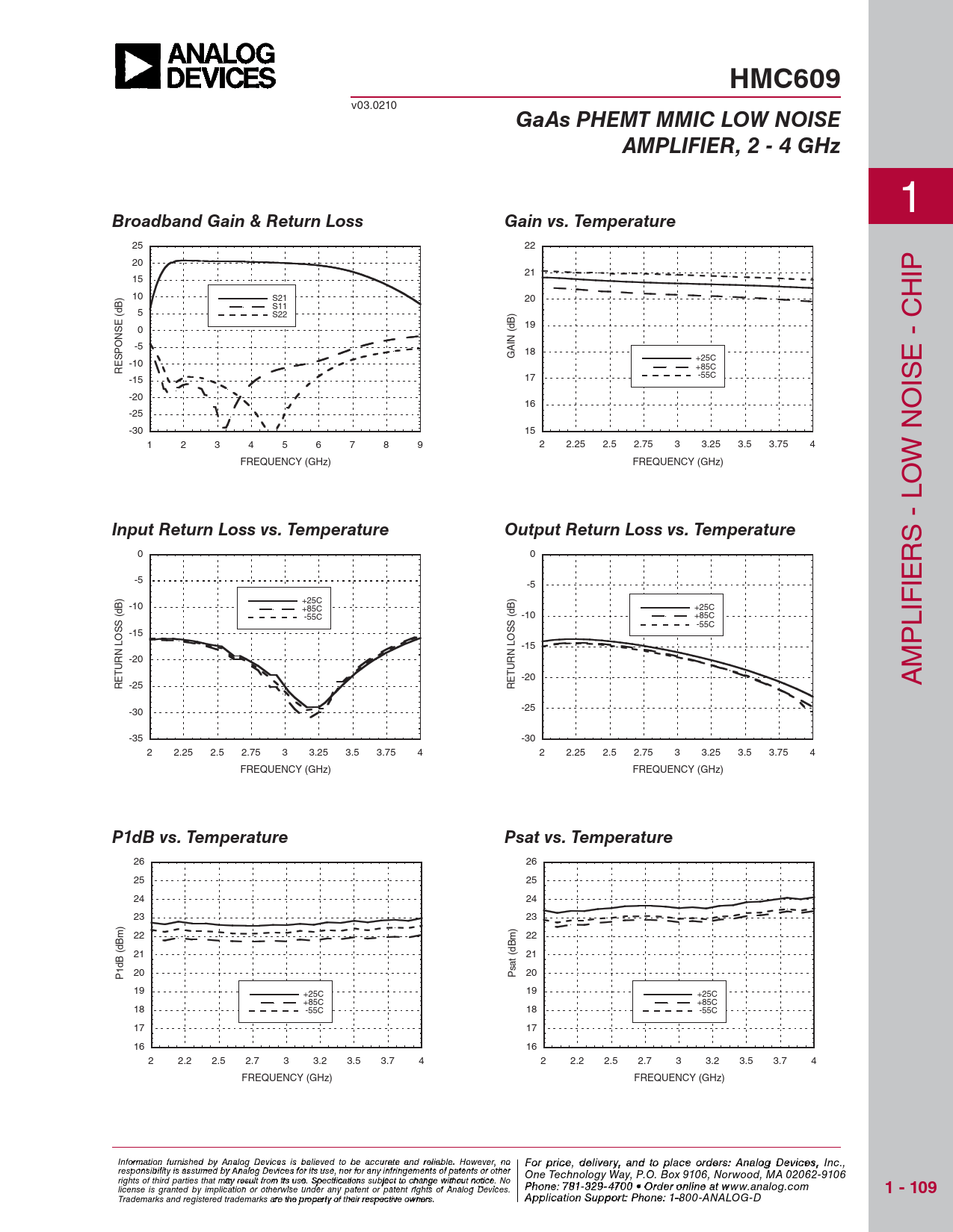

HMC609. GaAs PHEMT MMIC LOW NOISE. AMPLIFIER, 2 - 4 GHz. Broadband Gain & Return Loss. Gain vs. Temperature
HMC609 GaAs PHEMT MMIC LOW NOISE AMPLIFIER, 2 - 4 GHz Broadband Gain & Return Loss Gain vs Temperature
HMC609
v03.0210
1
Broadband Gain & Return Loss Gain vs. Temperature
25 22 20 21 IP 15 10 S21 H 20 S11 5 S22 0 19 (dB) -5 18 GAIN +25C E - C -10 RESPONSE (dB) +85C -15 17 -55C IS -20 16 -25 -30 15 1 2 3 4 5 6 7 8 9 2 2.25 2.5 2.75 3 3.25 3.5 3.75 4 FREQUENCY (GHz) FREQUENCY (GHz) W NO O
Input Return Loss vs. Temperature Output Return Loss vs. Temperature
S - L 0 0 R -5 -5 IE +25C -10 +85C +25C IF -55C -10 +85C -55C L -15 P -15 -20 M -20 RETURN LOSS (dB) -25 A RETURN LOSS (dB) -30 -25 -35 -30 2 2.25 2.5 2.75 3 3.25 3.5 3.75 4 2 2.25 2.5 2.75 3 3.25 3.5 3.75 4 FREQUENCY (GHz) FREQUENCY (GHz)
P1dB vs. Temperature Psat vs. Temperature
26 26 25 25 24 24 23 23 22 22 21 21 20 P1dB (dBm) Psat (dBm) 20 19 +25C 19 +25C +85C +85C 18 -55C 18 -55C 17 17 16 16 2 2.2 2.5 2.7 3 3.2 3.5 3.7 4 2 2.2 2.5 2.7 3 3.2 3.5 3.7 4 FREQUENCY (GHz) FREQUENCY (GHz) Inf F or o m r pr ation ifc ur e, de nished lbiv y e Anry alo a g n D d to p evices is la beclie o eved rde to b r e sa: H ccur iattti e tae M nd reliicr abl ow e. H a o v wee C ver, o n rp o o F roar tiporin c ,e 2 , 0 de A liv lepha R ry, an o d t ad, C o plac h e eolm rdesrfo s: rd, MA 01 Analog Devi 8 c 2 e 4 s, Inc., responsibility is assumed by Analog Devices for its use, nor for any infringements of patents or other One Technology Way, P.O. Box 9106, Norwood, MA 02062-9106 Phone: 978-250-3343 Fax: 978-250-3373 O rights of third parties that may result from its use. Specifications subject to change without notice. No rde Phon r O e: 7 n- 81 li 3 n 2 e a 9-4 t w 70 ww 0 • O . rdh e itt r o ite nli .c n o e a m license is granted by implication or otherwise under any patent or patent rights of Analog Devices. t www.analog.com
