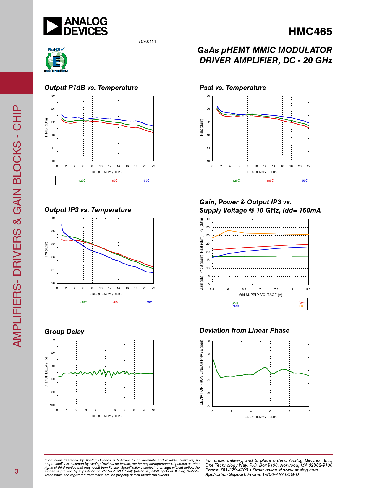

DescriptionGaAs pHEMT MMIC MODULATOR DRIVER AMPLIFIER, DC - 20 GHz

HMC465. GaAs pHEMT MMIC MODULATOR. DRIVER AMPLIFIER, DC - 20 GHz. Output P1dB vs. Temperature. Psat vs. Temperature
HMC465 GaAs pHEMT MMIC MODULATOR DRIVER AMPLIFIER, DC - 20 GHz Output P1dB vs Temperature Psat vs Temperature
HMC465
v09.0114
GaAs pHEMT MMIC MODULATOR DRIVER AMPLIFIER, DC - 20 GHz Output P1dB vs. Temperature Psat vs. Temperature
30 30 IP 26 26 H ) m 22 m 22 (dB (dB at 1dB s 18 P P 18 S - C K 14 14 C 10 10 0 2 4 6 8 10 12 14 16 18 20 22 0 2 4 6 8 10 12 14 16 18 20 22 LO FREQUENCY (GHz) FREQUENCY (GHz) +25C +85C -55C +25C +85C -55C IN B A
Gain, Power & Output IP3 vs. Output IP3 vs. Temperature Supply Voltage @ 10 GHz, Idd= 160mA
40 ) 40 m B S & G d ( 35 3 36 R ), IP 30 m E ) B 32 d m 25 t ( a (dB s IV 3 20 IP ), P 28 m R B 15 d ( B d 10 24 1 - D ), P 5 B d S 20 ( in 0 a R 0 2 4 6 8 10 12 14 16 18 20 22 G 5.5 6 6.5 7 7.5 8 8.5 FREQUENCY (GHz) Vdd SUPPLY VOLTAGE (V) IE +25C +85C -55C Gain Psat P1dB IP3 LIF P M
Group Delay Deviation from Linear Phase
A 0 ) 5 g e (d -20 ) 3 ASE s (p PH AY -40 1 EAR EL D IN L P U M -60 O O -1 R R G F N -80 IO -3 AT EVI -100 D -5 0 1 2 3 4 5 6 7 8 9 10 0 2 4 6 8 10 FREQUENCY (GHz) FREQUENCY (GHz) Inf F or o m r p atio r n ifc ur e n , d ishe e d lbiv y e A r n y a alog n D d t evic o p es is la beclie o eved rd to ebre sa: H ccur iattti e tae M nd re ilicarbloew . H a o ve C wever, o n rp o For price, delivery, and to place orders: Analog Devices, Inc., responsibility is assumed by Analog Devices for its use, nor for any infringements of patents or other oration, 2 Elizabeth Drive, Chelmsford, MA 01824 One Technology Way, P.O. Box 9106, Norwood, MA 02062-9106 Phone: 978-250-3343 Fax: 978-250-3373 O rights of third parties that may result from its use. Specifications subject to change without notice. No P rd hone e r O : 7 n 81- -3li 2n 9 e a -47 t w 0 w 0 • O w rd .h e it r o t niltie n .c e ao t m
