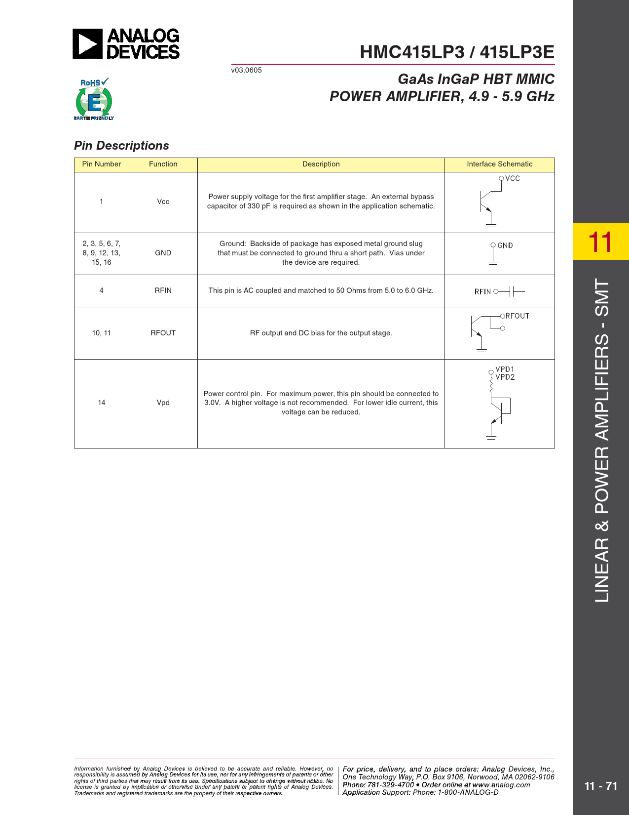

HMC415LP3 / 415LP3E. GaAs InGaP HBT MMIC. POWER AMPLIFIER, 4.9 - 5.9 GHz. Pin Descriptions. 11 - 71
HMC415LP3 / 415LP3E GaAs InGaP HBT MMIC POWER AMPLIFIER, 4.9 - 5.9 GHz Pin Descriptions 11 - 71
HMC415LP3 / 415LP3E
v03.0605
Pin Number Function Description Interface Schematic Power supply voltage for the fi rst amplifi er stage. An external bypass 1 Vcc capacitor of 330 pF is required as shown in the application schematic. 2, 3, 5, 6, 7, Ground: Backside of package has exposed metal ground slug 8, 9, 12, 13, GND that must be connected to ground thru a short path. Vias under 11 15, 16 the device are required. T 4 RFIN This pin is AC coupled and matched to 50 Ohms from 5.0 to 6.0 GHz. 10, 11 RFOUT RF output and DC bias for the output stage. - SM S R IE IF Power control pin. For maximum power, this pin should be connected to L 14 Vpd 3.0V. A higher voltage is not recommended. For lower idle current, this voltage can be reduced. P M R A E W O & P R A E IN L Information furnish F e o d r pri by An ce, de alog Devic leis vie s rbyeli, a eve nd to pla d to be accur ce o ate an r d der relia s ble , pl . Ho ease co wever, no For price, delivery, and to place orders: Analog Devices, Inc., responsibility is assumed by Analog Devices for its use, nor for any infringements of patents or other ntact Hittite Microwave Corporation: One Technology Way, P.O. Box 9106, Norwood, MA 02062-9106 20 Alpha Road, Chelmsford, MA 01824 Phone rights of third parties that may result from its use. Specifications subject to change without notice. No license is granted by implication or otherwise under any patent or patent rights of Analog Devices. : 978 Pho - n 25 e: 7 0- 81 33 2 4 9- 3 F 470 ax: 978 0 • Order o - n 25 lin 0 e a-t 3373 www.analog.com
