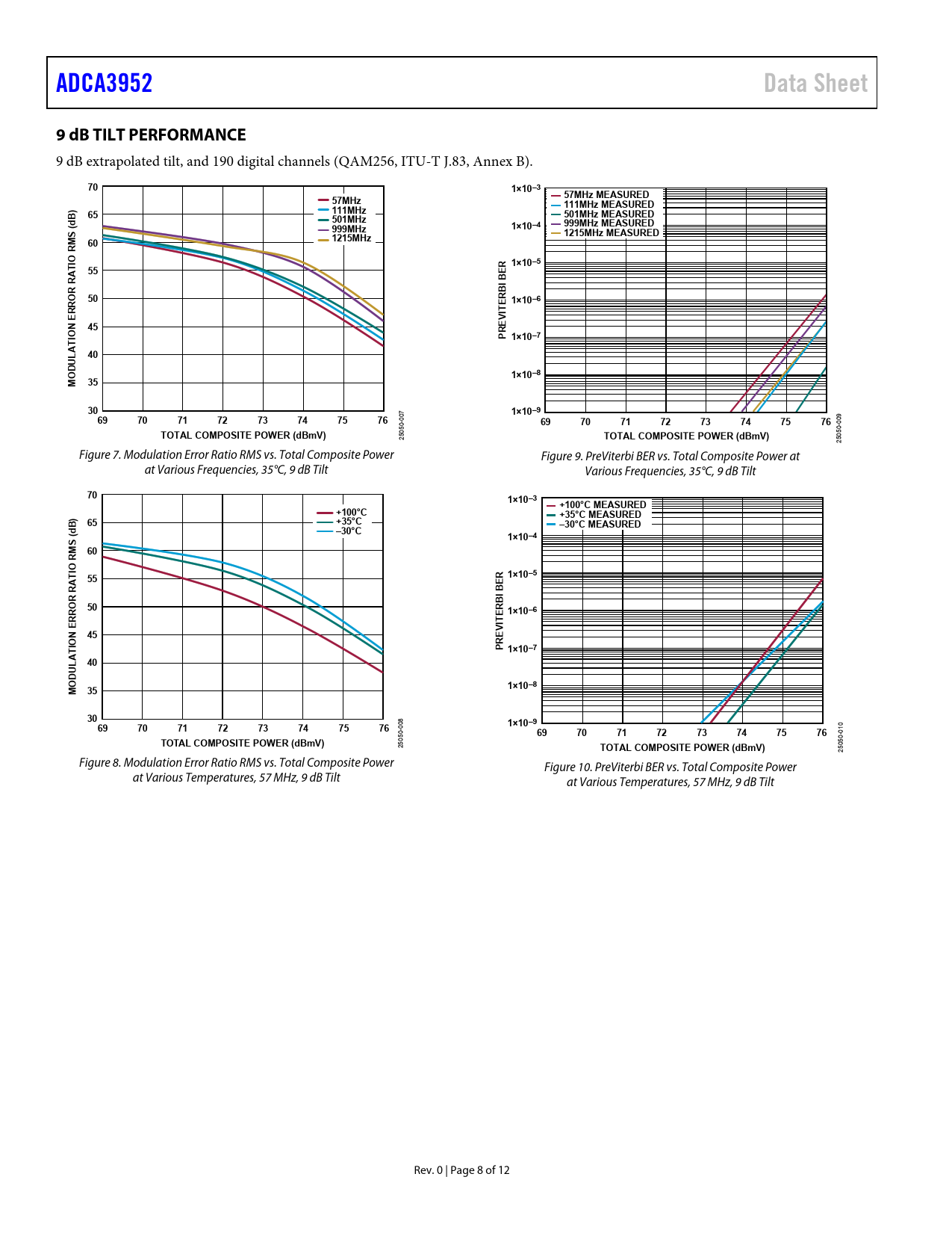

9 dB extrapolated tilt, and 190 digital channels (QAM256, ITU-T J.83, Annex B).
70 1×10–3 57MHz MEASURED 57MHz 111MHz MEASURED 111MHz B) 65 501MHz MEASURED 501MHz (d 999MHz MEASURED 999MHz 1×10–4 S 1215MHz MEASURED M 1215MHz 60 R IO T R 1×10–5 55 E RA I B R B 50 ER 1×10–6 RRO IT E N 45 EV IO PR 1×10–7 T A L 40 U D O 1×10–8 M 35 30

25 Figure 7. Modulation Error Ratio RMS vs. Total Composite Power Figure 9. PreViterbi BER vs. Total Composite Power at at Various Frequencies, 35°C, 9 dB Tilt Various Frequencies, 35°C, 9 dB Tilt

050 25 Figure 8. Modulation Error Ratio RMS vs. Total Composite Power Figure 10. PreViterbi BER vs. Total Composite Power at Various Temperatures, 57 MHz, 9 dB Tilt at Various Temperatures, 57 MHz, 9 dB Tilt Rev. 0 | Page 8 of 12 Document Outline FEATURES APPLICATIONS GENERAL DESCRIPTION FUNCTIONAL BLOCK DIAGRAM TABLE OF CONTENTS REVISION HISTORY SPECIFICATIONS GENERAL PERFORMANCE DISTORTION DATA (40 MHz TO 550 MHz), ERROR RATES, AND TOTAL COMPOSITE POWER ABSOLUTE MAXIMUM RATINGS ESD CAUTION PIN CONFIGURATION AND FUNCTION DESCRIPTIONS TYPICAL PERFORMANCE CHARACTERISTICS S-PARAMETERS 9 dB TILT PERFORMANCE THEORY OF OPERATION APPLICATIONS INFORMATION OUTLINE DIMENSIONS ORDERING GUIDE
