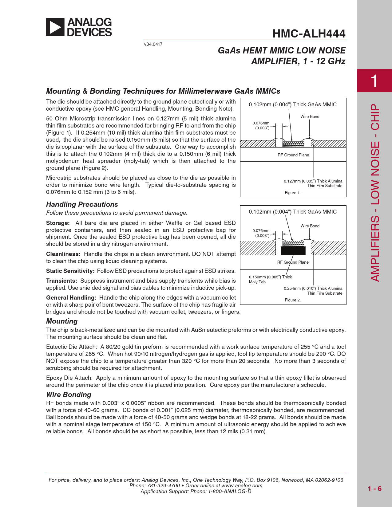

The die should be attached directly to the ground plane eutectical y or with 0.102mm (0.004”) Thick GaAs MMIC conductive epoxy (see HMC general Handling, Mounting, Bonding Note). IP 50 Ohm Microstrip transmission lines on 0.127mm (5 mil) thick alumina Wire Bond 0.076mm H thin film substrates are recommended for bringing RF to and from the chip (0.003”) (Figure 1). If 0.254mm (10 mil) thick alumina thin film substrates must be used, the die should be raised 0.150mm (6 mils) so that the surface of the die is coplanar with the surface of the substrate. One way to accomplish E - C this is to attach the 0.102mm (4 mil) thick die to a 0.150mm (6 mil) thick RF Ground Plane IS molybdenum heat spreader (moly-tab) which is then attached to the ground plane (Figure 2). O Microstrip substrates should be placed as close to the die as possible in 0.127mm (0.005”) Thick Alumina order to minimize bond wire length. Typical die-to-substrate spacing is Thin Film Substrate W N 0.076mm to 0.152 mm (3 to 6 mils). Figure 1. O

Follow these precautions to avoid permanent damage. 0.102mm (0.004”) Thick GaAs MMIC

All bare die are placed in either Waffle or Gel based ESD S - L Wire Bond protective containers, and then sealed in an ESD protective bag for 0.076mm R shipment. Once the sealed ESD protective bag has been opened, all die (0.003”) IE should be stored in a dry nitrogen environment.

Fol ow ESD precautions to protect against ESD strikes. M 0.150mm (0.005”) Thick

Suppress instrument and bias supply transients while bias is Moly Tab A applied. Use shielded signal and bias cables to minimize inductive pick-up. 0.254mm (0.010”) Thick Alumina Thin Film Substrate

Handle the chip along the edges with a vacuum col et Figure 2. or with a sharp pair of bent tweezers. The surface of the chip has fragile air bridges and should not be touched with vacuum col et, tweezers, or fingers.
