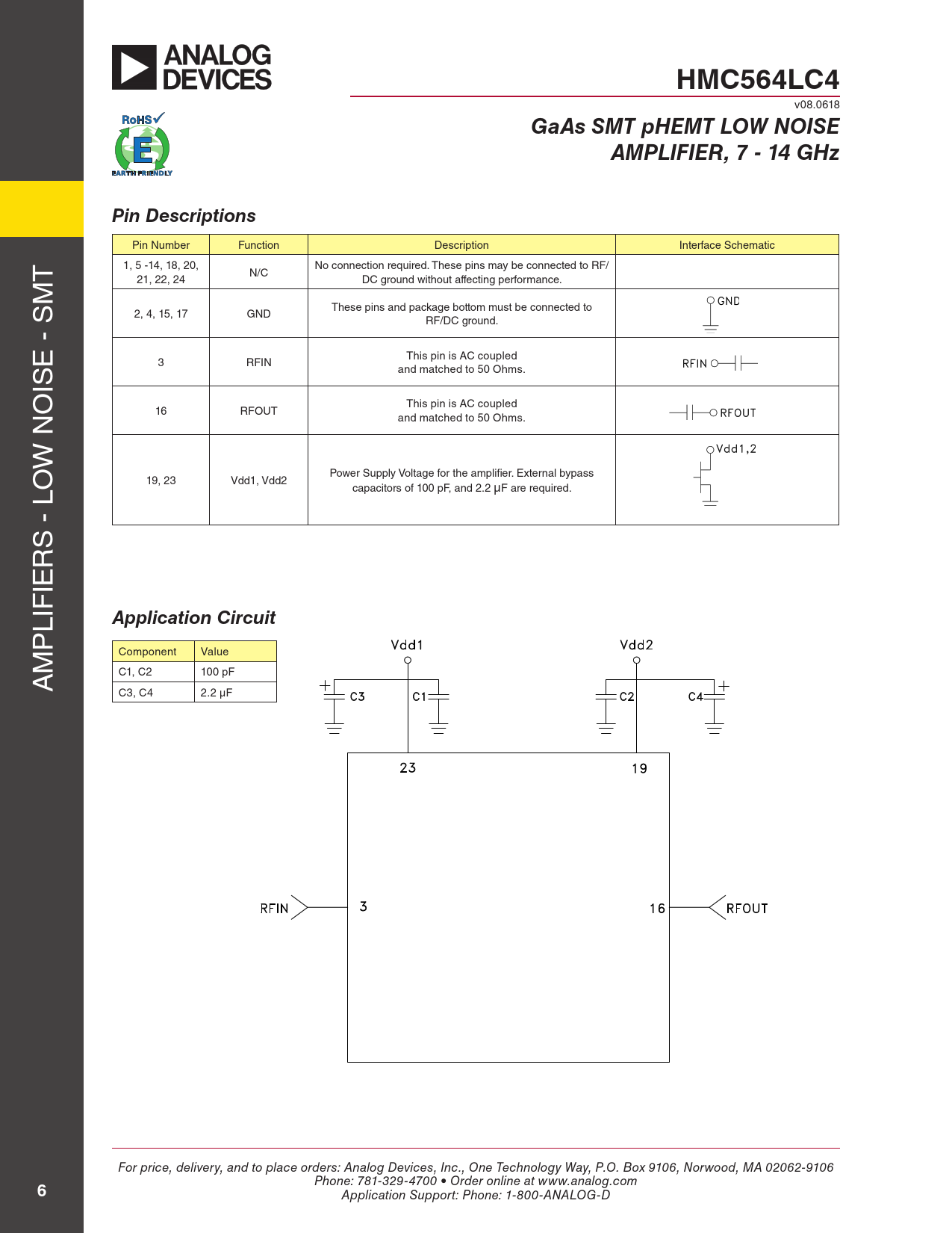

GaAs SMT pHEMT LOW NOISE AMPLIFIER, 7 - 14 GHz Pin Descriptions
Pin Number Function Description Interface Schematic T 1, 5 -14, 18, 20, No connection required. These pins may be connected to RF/ N/C M 21, 22, 24 DC ground without affecting performance. These pins and package bottom must be connected to 2, 4, 15, 17 GND RF/DC ground. E - S This pin is AC coupled 3 RFIN IS and matched to 50 Ohms. O This pin is AC coupled 16 RFOUT and matched to 50 Ohms. W N O Power Supply Voltage for the amplifier. External bypass 19, 23 Vdd1, Vdd2 capacitors of 100 pF, and 2.2 µF are required. S - L R IE LIF
Application Circuit
P M Component Value A C1, C2 100 pF C3, C4 2.2 µF For price, delivery, and to place orders: Analog Devices, Inc., One Technology Way, P.O. Box 9106, Norwood, MA 02062-9106 Phone: 781-329-4700 • Order online at www.analog.com
