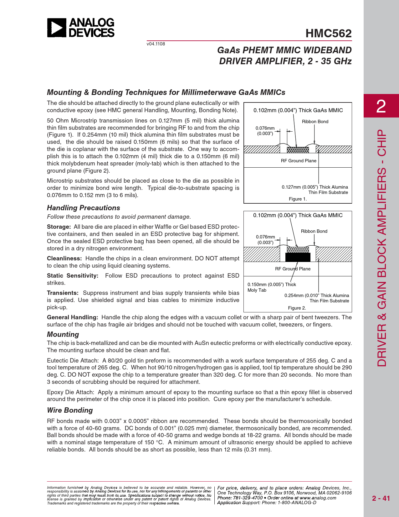

GaAs PHEMT MMIC WIDEBAND DRIVER AMPLIFIER, 2 - 35 GHz Mounting & Bonding Techniques for Millimeterwave GaAs MMICs
The die should be attached directly to the ground plane eutectically or with conductive epoxy (see HMC general Handling, Mounting, Bonding Note). 0.102mm (0.004”) Thick GaAs MMIC 2 50 Ohm Microstrip transmission lines on 0.127mm (5 mil) thick alumina Ribbon Bond thin fi lm substrates are recommended for bringing RF to and from the chip 0.076mm (Figure 1). If 0.254mm (10 mil) thick alumina thin fi lm substrates must be (0.003”) IP used, the die should be raised 0.150mm (6 mils) so that the surface of H the die is coplanar with the surface of the substrate. One way to accom- plish this is to attach the 0.102mm (4 mil) thick die to a 0.150mm (6 mil) RF Ground Plane thick molybdenum heat spreader (moly-tab) which is then attached to the - C ground plane (Figure 2). S Microstrip substrates should be placed as close to the die as possible in R order to minimize bond wire length. Typical die-to-substrate spacing is 0.127mm (0.005”) Thick Alumina Thin Film Substrate IE 0.076mm to 0.152 mm (3 to 6 mils). Figure 1. IF

Suppress instrument and bias supply transients while bias 0.254mm (0.010” Thick Alumina is applied. Use shielded signal and bias cables to minimize inductive A Thin Film Substrate pick-up. Figure 2.
