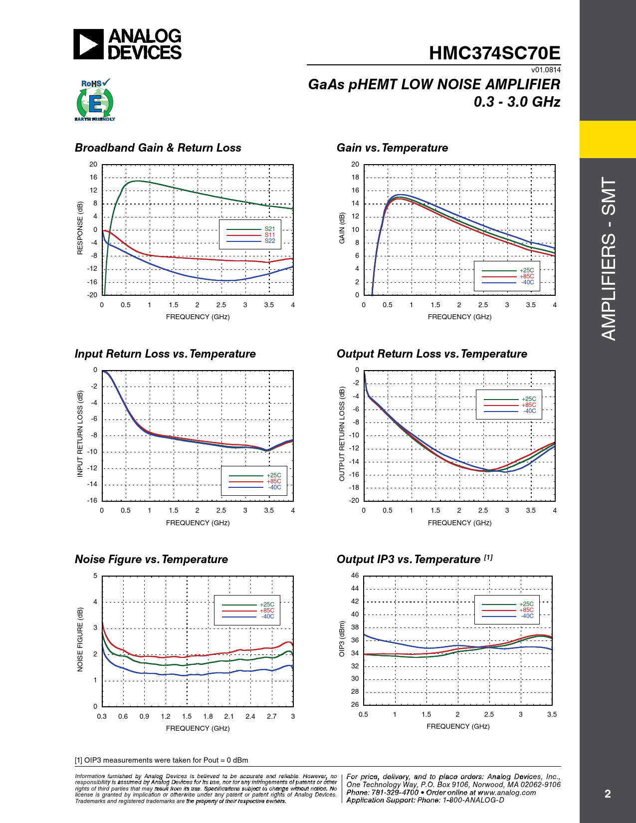

HMC374SC70E. GaAs pHEMT LOW NOISE AMPLIFIER. 0.3 - 3.0 GHz. Broadband Gain & Return Loss. Gain vs. Temperature
HMC374SC70E GaAs pHEMT LOW NOISE AMPLIFIER 0.3 - 3.0 GHz Broadband Gain & Return Loss Gain vs Temperature
HMC374SC70E
v01.0814
GaAs pHEMT LOW NOISE AMPLIFIER 0.3 - 3.0 GHz Broadband Gain & Return Loss Gain vs. Temperature
20 20 16 18 T 12 16 8 14 m (dB) 4 12 s (dB) 0 S21 10 S11 - -4 S22 GAIN 8 s RESPONSE -8 6 r -12 4 +25C +85C ie -16 2 -40C -20 0 lif 0 0.5 1 1.5 2 2.5 3 3.5 4 0 0.5 1 1.5 2 2.5 3 3.5 4 p FREQUENCY (GHz) FREQUENCY (GHz) m A
Input Return Loss vs. Temperature Output Return Loss vs. Temperature
0 0 -2 -2 (dB) -4 (dB) -4 +25C +85C -6 -40C -6 LOSS LOSS -8 -8 -10 RETURN -12 RETURN -10 -14 PUT -12 IN +25C -16 OUTPUT -14 +85C -40C -18 -16 -20 0 0.5 1 1.5 2 2.5 3 3.5 4 0 0.5 1 1.5 2 2.5 3 3.5 4 FREQUENCY (GHz) FREQUENCY (GHz)
Noise Figure vs. Temperature Output IP3 vs. Temperature [1]
5 46 44 4 +25C 42 +25C +85C +85C -40C (dB) 40 -40C 3 38 GURE 36 FI 2 OIP3 (dBm) 34 SE NOI 32 1 30 28 0 26 0.3 0.6 0.9 1.2 1.5 1.8 2.1 2.4 2.7 3 0.5 1 1.5 2 2.5 3 3.5 FREQUENCY (GHz) FREQUENCY (GHz) [1] Oip3 measurements were taken for pout = 0 dBm InformatioFn ofur p rnis rhiec d eb, d y A e n l al iovg eDrey a vice n s id t s b o p eliev lea d c t e o o be rd acc eurrast: A e an n d a re llioag D ble. H eovi we c ve e r, sn, I o For price, delivery, and to place orders: Analog Devices, Inc., responsibility is assumed by Analog Devices for its use, nor for any infringements of patents or other nc., 2 Elizabeth Drive, Chelmsford, MA 01824 One Technology Way, P.O. Box 9106, Norwood, MA 02062-9106 Phone: 978-250-3343 • Fax: 978-250-3373 • O rights of third parties that may result from its use. Specifications subject to change without notice. No Prd hoe n r O e: 7 n- 81- li 3 n 2 e a 9-4 t w 70 ww 0 • O . rdh e itt r o it nle i . n co e a m license is granted by implication or otherwise under any patent or patent rights of Analog Devices. t www.analog.com
