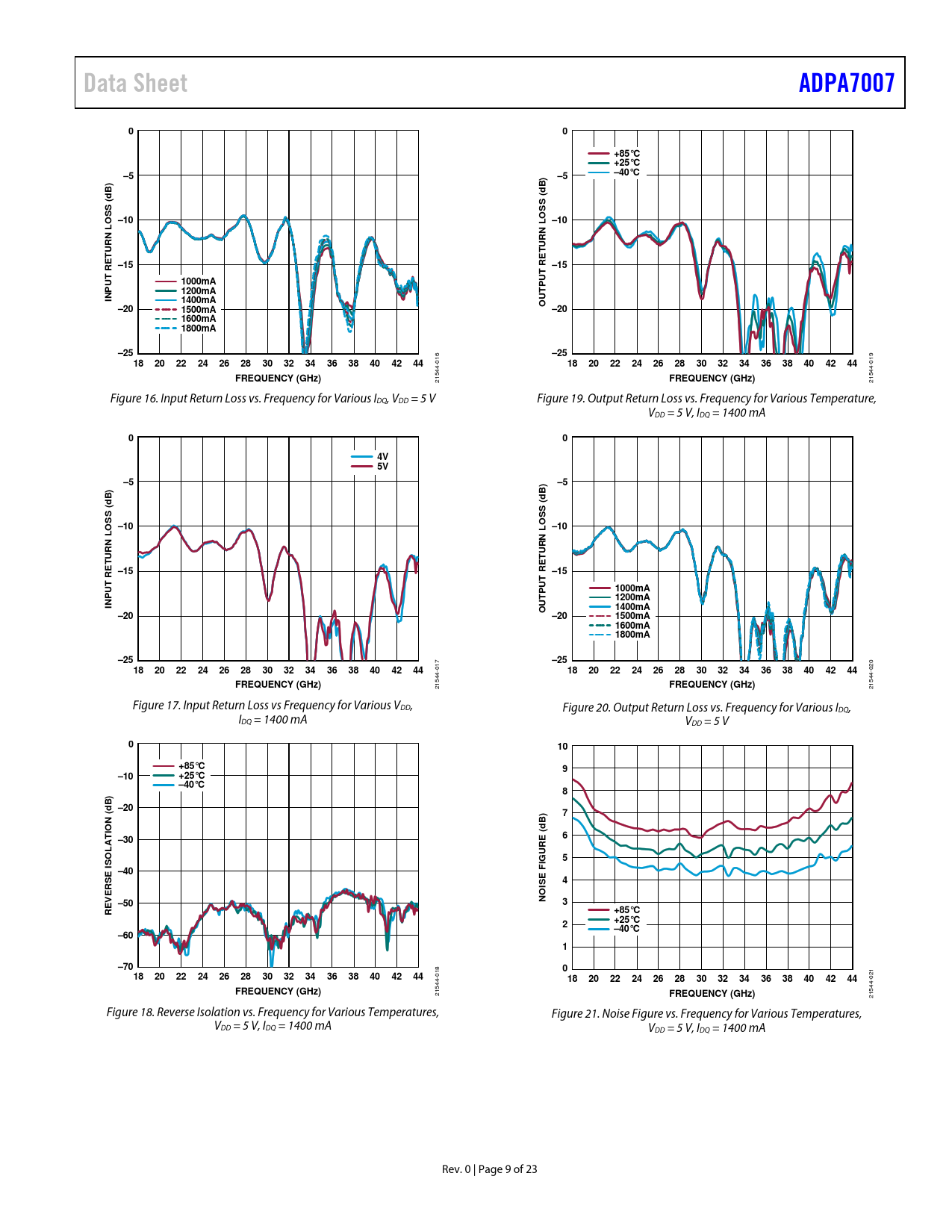

Data Sheet. ADPA7007. +85°C +25°C. –40°C. O –10. –10. URN L. –15. RE –15. 1000mA. 1200mA. INP. 1400mA. UT O. –20. 1500mA. 1600mA 1800mA. –25
Data Sheet ADPA7007 +85°C +25°C –40°C O –10 –10 URN L –15 RE –15 1000mA 1200mA INP 1400mA UT O –20 1500mA 1600mA 1800mA –25
Data Sheet ADPA7007 0 0 +85°C +25°C –5 –5 –40°C B) B) d d ( ( S S S S O O –10 –10 URN L URN L T T –15 RE –15 RE UT UT 1000mA P 1200mA INP 1400mA UT O –20 1500mA –20 1600mA 1800mA –25 –25 18 20 22 24 26 28 30 32 34 36 38 40 42 44

21544- Figure 16. Input Return Loss vs. Frequency for Various IDQ, VDD = 5 V Figure 19. Output Return Loss vs. Frequency for Various Temperature, VDD = 5 V, IDQ = 1400 mA

21544- Figure 17. Input Return Loss vs Frequency for Various VDD, Figure 20. Output Return Loss vs. Frequency for Various IDQ, IDQ = 1400 mA VDD = 5 V
0 10 +85°C 9 –10 +25°C –40°C 8 ) B –20 (d ) 7 N dB IO ( T 6 –30 E A R L 5 SO –40 FIGU E SE I 4 OIS N –50 EVER 3 R +85°C +25°C 2 –40°C –60 1 –70 0 18 20 22 24 26 28 30 32 34 36 38 40 42 44

21544- Figure 18. Reverse Isolation vs. Frequency for Various Temperatures, Figure 21. Noise Figure vs. Frequency for Various Temperatures, VDD = 5 V, IDQ = 1400 mA VDD = 5 V, IDQ = 1400 mA Rev. 0 | Page 9 of 23 Document Outline FEATURES APPLICATIONS FUNCTIONAL BLOCK DIAGRAM GENERAL DESCRIPTION TABLE OF CONTENTS REVISION HISTORY SPECIFICATIONS 20 GHz TO 26 GHz FREQUENCY RANGE 26 GHz TO 34 GHz FREQUENCY RANGE 34 GHz TO 44 GHz FREQUENCY RANGE ABSOLUTE MAXIMUM RATINGS ELECTROSTATIC DISCHARGE (ESD) RATINGS ESD CAUTION PIN CONFIGURATION AND FUNCTION DESCRIPTIONS INTERFACE SCHEMATICS TYPICAL PERFORMANCE CHARACTERISTICS CONSTANT IDD OPERATION THEORY OF OPERATION APPLICATIONS INFORMATION BIASING ADPA7007 WITH THE HMC980LP4E APPLICATION CIRCUIT SETUP LIMITING VGATE AND VNEG FOR ADPA7007 VGGX ABSOLUTE MAXIMUM RATING REQUIREMENT HMC980LP4E BIAS SEQUENCE Power-Up Sequence Power-Down Sequence CONSTANT DRAIN CURRENT BIASING vs. CONSTANT GATE VOLTAGE BIASING OUTLINE DIMENSIONS ORDERING GUIDE
