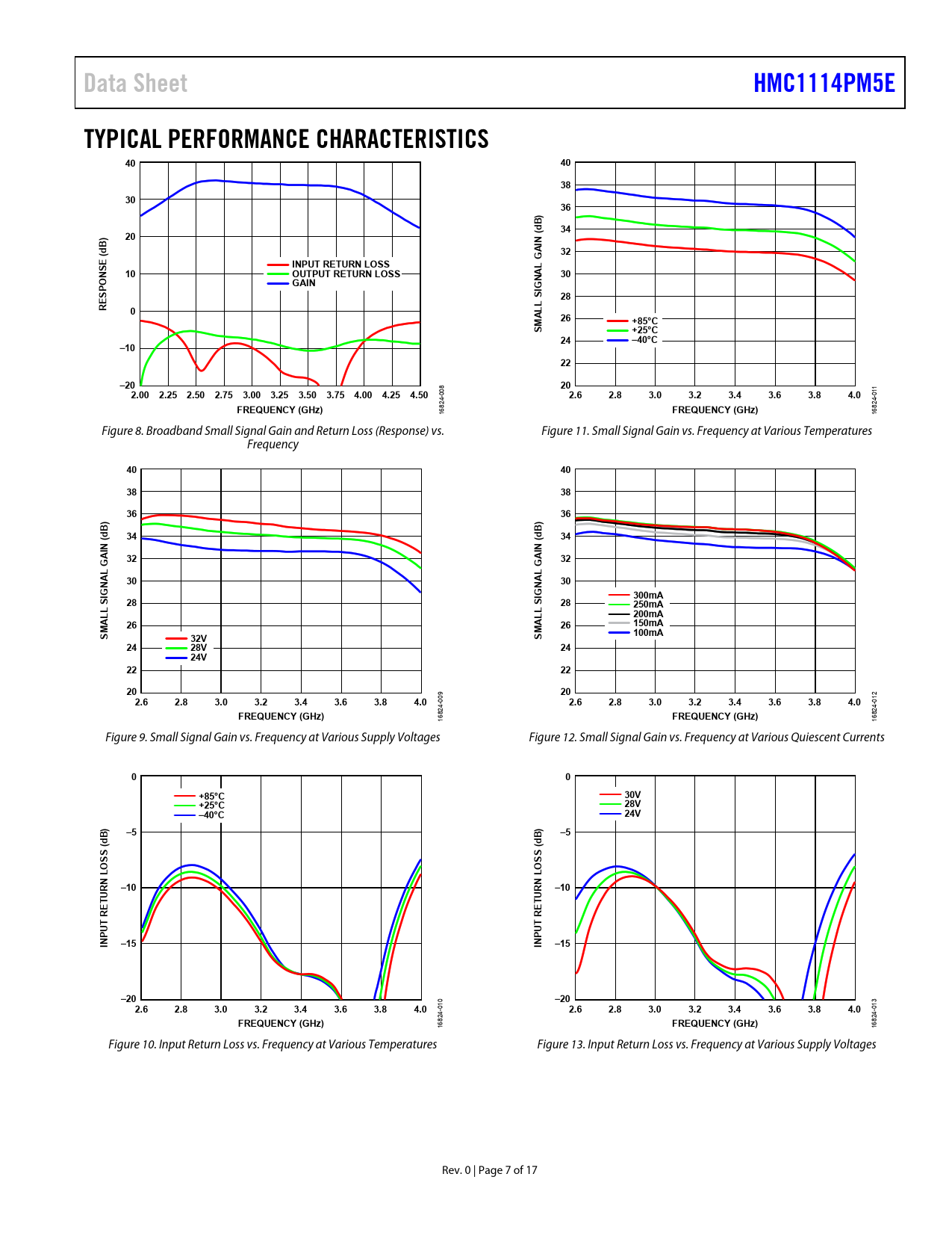

Data Sheet. HMC1114PM5E. TYPICAL PERFORMANCE CHARACTERISTICS. (dB. SE (d. INPUT RETURN LOSS. L GA. OUTPUT RETURN LOSS. GAIN. IGN. ESPO
Data Sheet HMC1114PM5E TYPICAL PERFORMANCE CHARACTERISTICS (dB SE (d INPUT RETURN LOSS L GA OUTPUT RETURN LOSS GAIN IGN ESPO
Data Sheet HMC1114PM5E TYPICAL PERFORMANCE CHARACTERISTICS 40 40 38 30 36 ) 34 ) 20 (dB B IN 32 SE (d INPUT RETURN LOSS L GA N 10 OUTPUT RETURN LOSS A 30 GAIN IGN ESPO 28 R 0 LL S A 26 +85°C SM +25°C 24 –40°C –10 22 –20 20 2.00 2.25 2.50 2.75 3.00 3.25 3.50 3.75 4.00 4.25 4.50

16824- Figure 8. Broadband Small Signal Gain and Return Loss (Response) vs. Figure 11. Small Signal Gain vs. Frequency at Various Temperatures Frequency

16824- Figure 9. Small Signal Gain vs. Frequency at Various Supply Voltages Figure 12. Small Signal Gain vs. Frequency at Various Quiescent Currents

16824- Figure 10. Input Return Loss vs. Frequency at Various Temperatures Figure 13. Input Return Loss vs. Frequency at Various Supply Voltages Rev. 0 | Page 7 of 17 Document Outline FEATURES APPLICATIONS FUNCTIONAL BLOCK DIAGRAM GENERAL DESCRIPTION TABLE OF CONTENTS REVISION HISTORY SPECIFICATIONS ELECTRICAL SPECIFICATIONS TOTAL SUPPLY CURRENT BY VDD ABSOLUTE MAXIMUM RATINGS THERMAL RESISTANCE ESD CAUTION PIN CONFIGURATION AND FUNCTION DESCRIPTIONS INTERFACE SCHEMATICS TYPICAL PERFORMANCE CHARACTERISTICS THEORY OF OPERATION APPLICATIONS INFORMATION RECOMMENDED BIAS SEQUENCE During Power-Up During Power-Down TYPICAL APPLICATION CIRCUIT EVALUATION PCB OUTLINE DIMENSIONS ORDERING GUIDE
