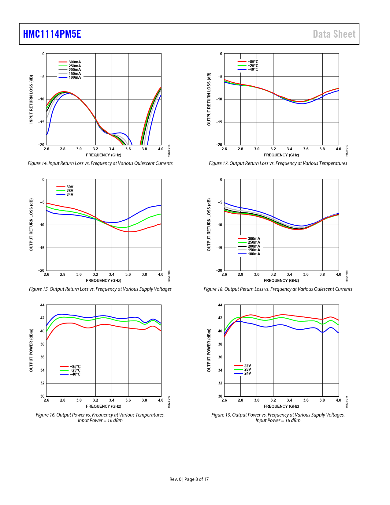

HMC1114PM5E. Data Sheet. 300mA. +85°C. 250mA. +25°C. 200mA. –40°C. 150mA. 100mA. SS (dB). –10. TURN L. PUT. INP. –15. –20. 2.6. 2.8. 3.0. 3.2. 3.4. 3.6. 3.8. 4.0
HMC1114PM5E Data Sheet 300mA +85°C 250mA +25°C 200mA –40°C 150mA 100mA SS (dB) –10 TURN L PUT INP –15 –20 2.6 2.8 3.0 3.2 3.4 3.6 3.8 4.0
HMC1114PM5E Data Sheet 0 0 300mA +85°C 250mA +25°C 200mA –40°C 150mA –5 100mA –5 SS (dB) SS (dB) O O –10 –10 TURN L TURN L RE RE UT PUT INP –15 UT –15 O –20 –20 2.6 2.8 3.0 3.2 3.4 3.6 3.8 4.0

16824- Figure 14. Input Return Loss vs. Frequency at Various Quiescent Currents Figure 17. Output Return Loss vs. Frequency at Various Temperatures

16824- Figure 15. Output Return Loss vs. Frequency at Various Supply Voltages Figure 18. Output Return Loss vs. Frequency at Various Quiescent Currents
44 44 42 42 40 40 dBm) dBm) ER ( 38 ER ( 38 W W O O P 36 P 36 PUT PUT UT +85°C UT 32V O 34 +25°C O 34 28V –40°C 24V 32 32 30 30 2.6 2.8 3.0 3.2 3.4 3.6 3.8 4.0

FREQUENCY (GHz)
