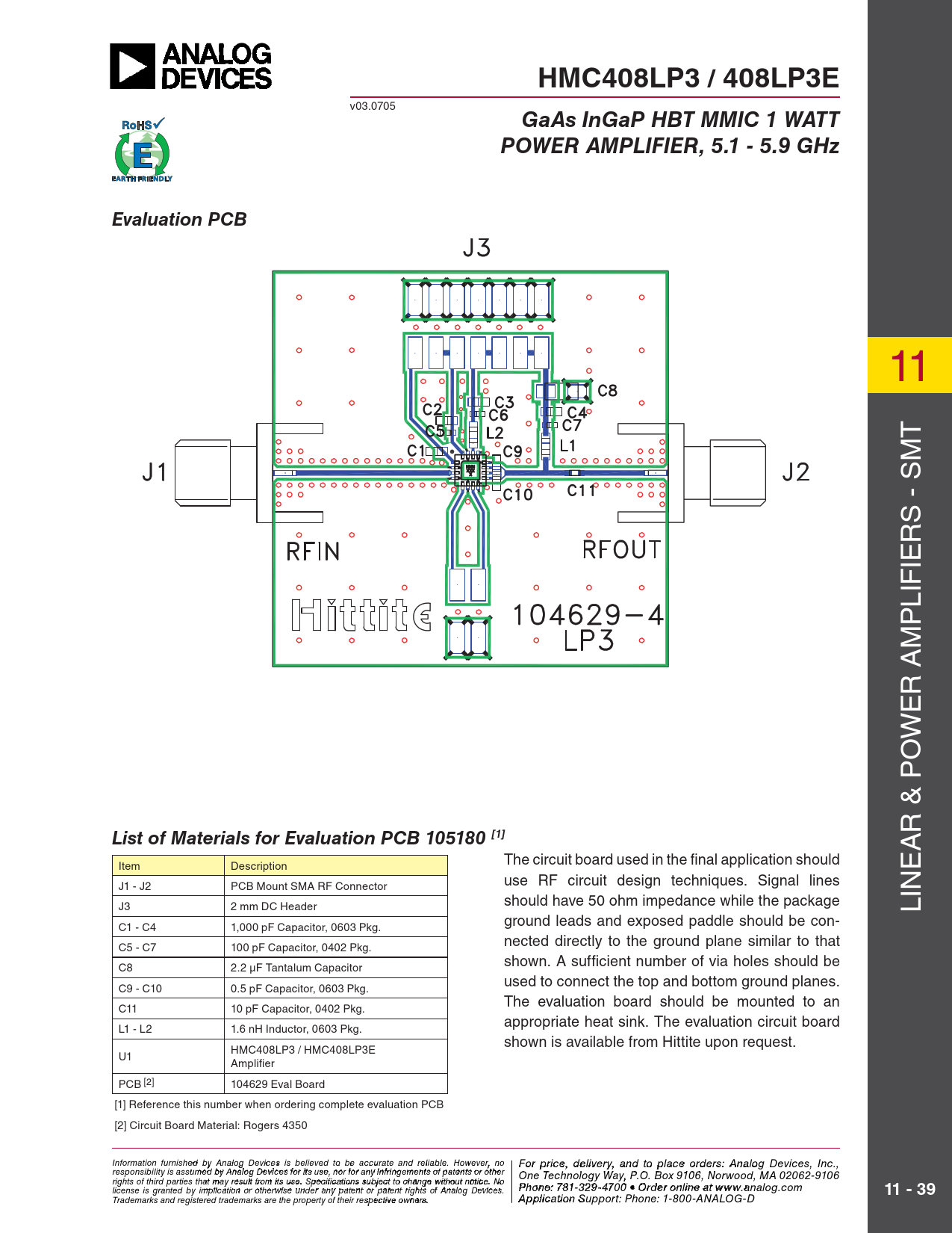

HMC408LP3 / 408LP3E. GaAs InGaP HBT MMIC 1 WATT. POWER AMPLIFIER, 5.1 - 5.9 GHz. Evaluation PCB
HMC408LP3 / 408LP3E GaAs InGaP HBT MMIC 1 WATT POWER AMPLIFIER, 5.1 - 5.9 GHz Evaluation PCB
HMC408LP3 / 408LP3E
v03.0705
11 T - SM S R IE IF L P M R A E W O & P R
List of Materials for Evaluation PCB 105180 [1]
A The circuit board used in the fi nal application should Item Description E use RF circuit design techniques. Signal lines J1 - J2 PCB Mount SMA RF Connector IN should have 50 ohm impedance while the package J3 2 mm DC Header L ground leads and exposed paddle should be con- C1 - C4 1,000 pF Capacitor, 0603 Pkg. nected directly to the ground plane similar to that C5 - C7 100 pF Capacitor, 0402 Pkg. shown. A sufficient number of via holes should be C8 2.2 μF Tantalum Capacitor used to connect the top and bottom ground planes. C9 - C10 0.5 pF Capacitor, 0603 Pkg. The evaluation board should be mounted to an C11 10 pF Capacitor, 0402 Pkg. appropriate heat sink. The evaluation circuit board L1 - L2 1.6 nH Inductor, 0603 Pkg. shown is available from Hittite upon request. HMC408LP3 / HMC408LP3E U1 Amplifi er PCB [2] 104629 Eval Board [1] Reference this number when ordering complete evaluation PCB [2] Circuit Board Material: Rogers 4350 Information furnish F e o d r pri by An ce, de alog Devic leis vie s rbyeli, a eve nd to pla d to be accur ce o ate an r d der relia s ble , pl . Ho ease co wever, no For price, delivery, and to place orders: Analog Devices, Inc., responsibility is assumed by Analog Devices for its use, nor for any infringements of patents or other ntact Hittite Microwave Corporation: One Technology Way, P.O. Box 9106, Norwood, MA 02062-9106 20 Alpha Road, Chelmsford, MA 01824 Phone rights of third parties that may result from its use. Specifications subject to change without notice. No license is granted by implication or otherwise under any patent or patent rights of Analog Devices. : 978 Pho - n 25 e: 7 0- 81 33 2 4 9- 3 F 470 ax: 978 0 • Order o - n 25 lin 0 e a-t 3373 www.analog.com
