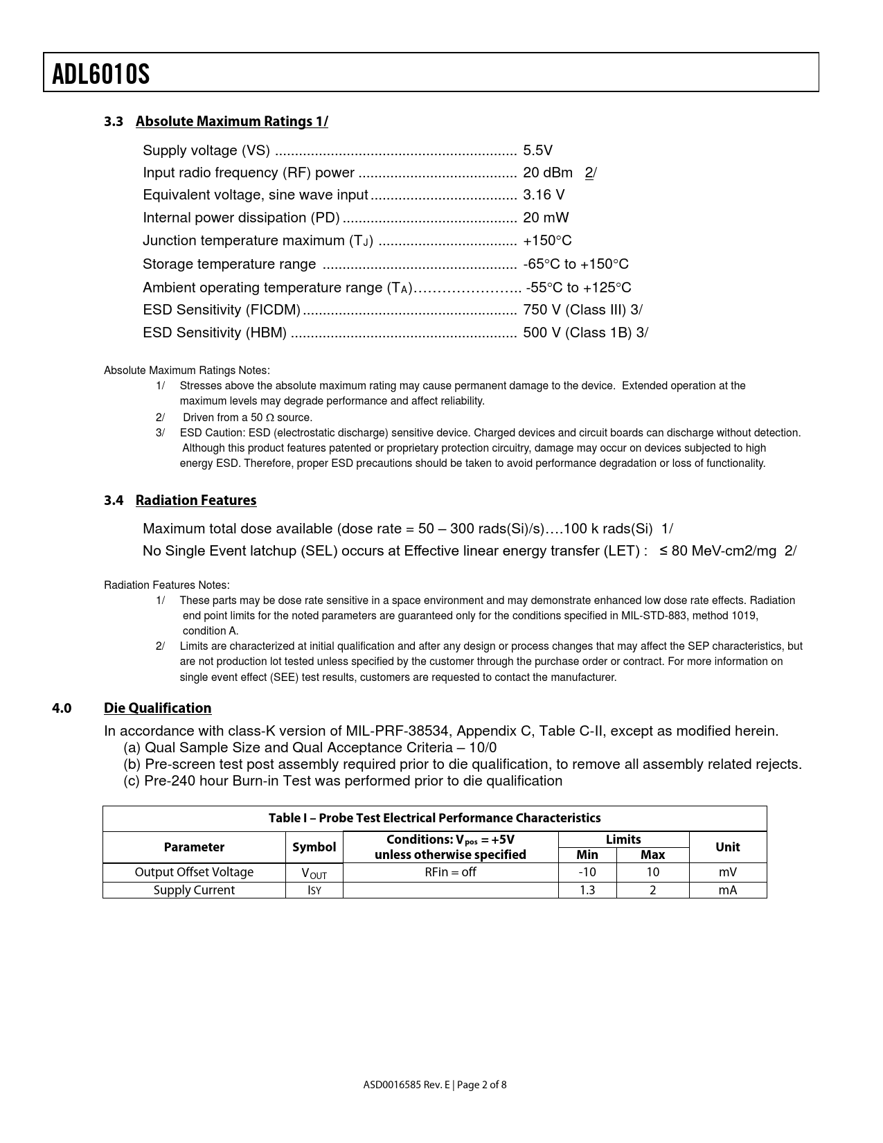

ADL6010S. 3.3 Absolute Maximum Ratings 1/. 3.4 Radiation Features. 4.0. Die Qualification
ADL6010S 3.3 Absolute Maximum Ratings 1/ 3.4 Radiation Features 4.0 Die Qualification
Supply voltage (VS) ... 5.5V Input radio frequency (RF) power .. 20 dBm 2/ Equivalent voltage, sine wave input ... 3.16 V Internal power dissipation (PD) .. 20 mW Junction temperature maximum (TJ) ... +150°C Storage temperature range ... -65°C to +150°C Ambient operating temperature range (TA)………………….. -55°C to +125°C ESD Sensitivity (FICDM) .. 750 V (Class III) 3/ ESD Sensitivity (HBM) ... 500 V (Class 1B) 3/ Absolute Maximum Ratings Notes: 1/ Stresses above the absolute maximum rating may cause permanent damage to the device. Extended operation at the maximum levels may degrade performance and affect reliability. 2/ Driven from a 50 Ω source. 3/ ESD Caution: ESD (electrostatic discharge) sensitive device. Charged devices and circuit boards can discharge without detection. Although this product features patented or proprietary protection circuitry, damage may occur on devices subjected to high energy ESD. Therefore, proper ESD precautions should be taken to avoid performance degradation or loss of functionality.
Maximum total dose available (dose rate = 50 – 300 rads(Si)/s)….100 k rads(Si) 1/ No Single Event latchup (SEL) occurs at Effective linear energy transfer (LET) : ≤ 80 MeV-cm2/mg 2/ Radiation Features Notes: 1/ These parts may be dose rate sensitive in a space environment and may demonstrate enhanced low dose rate effects. Radiation end point limits for the noted parameters are guaranteed only for the conditions specified in MIL-STD-883, method 1019, condition A. 2/ Limits are characterized at initial qualification and after any design or process changes that may affect the SEP characteristics, but are not production lot tested unless specified by the customer through the purchase order or contract. For more information on single event effect (SEE) test results, customers are requested to contact the manufacturer.
In accordance with class-K version of MIL-PRF-38534, Appendix C, Table C-II, except as modified herein. (a) Qual Sample Size and Qual Acceptance Criteria – 10/0 (b) Pre-screen test post assembly required prior to die qualification, to remove all assembly related rejects. (c) Pre-240 hour Burn-in Test was performed prior to die qualification
Table I – Probe Test Electrical Performance Characteristics Limits Parameter Symbol Conditions: Vpos = +5V unless otherwise specified Unit Min Max
Output Offset Voltage VOUT RFin = off -10 10 mV Supply Current ISY 1.3 2 mA ASD0016585 Rev. E | Page 2 of 8 Document Outline AlCu (a) Qual Sample Size and Qual Acceptance Criteria – 10/0
